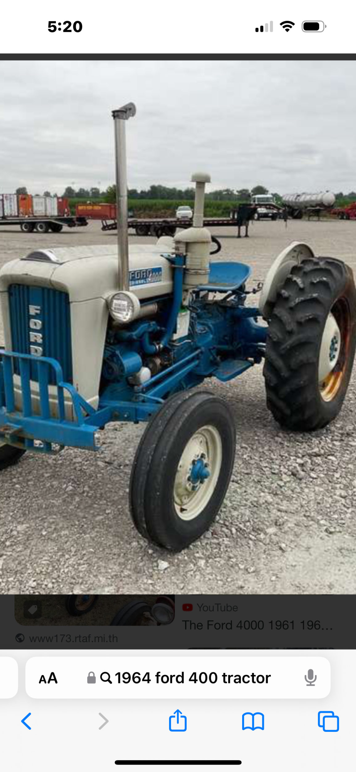

My hood says Ford 4000, the stamp on the block is COMM 6015J, the stamp below the battery is 960 44043. Is a diesel, not sure what I have??? Please help, want to rebuild it.

4-speed or 5-speed? Live PTO via a two-stage clutch? Pictures would help us help you.

Mine isn’t this tractor but look identical other than front grill

Yes, that is a early 4cylinder 4000 tractor, basically like a 861. The later 1965 4000's were 3 cylinder engines.

Sounds reasonable what about the 960 stamp below the battery?

The 960 44043 is what is throwing me. The 960 would indicate that the motor came from an earlier Ford. This is what a model and serial # would look like on a 4000:

The numbers are stamped into the transmission case not the engine. The 960 is all about the transmission, which is the only part that is serialized, not the motor. At some point in its history someone put a transmission from a 960 into it. They will swap just fine, it appears to be a transmission from a 56-57 model tractor.
The COMM 6015J casting number is correct for 1964, 172 ci engine, same as I replaced the engine in my mutt 850 with years ago. The engines are NOT serialized, they only have casting numbers for identification. It is a non-sleeved engine used just before Ford switched to the 3 cylinder.
