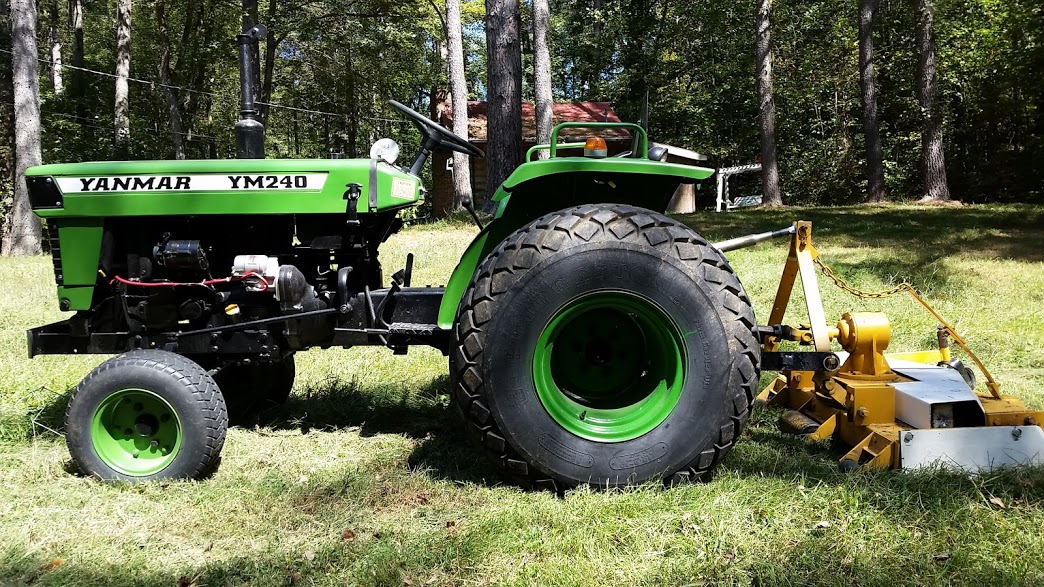

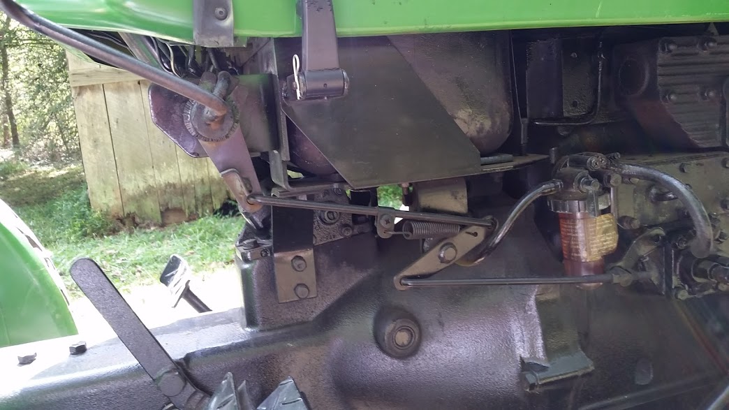

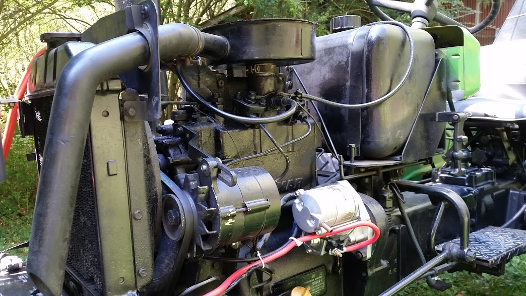

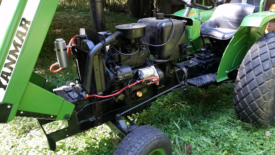

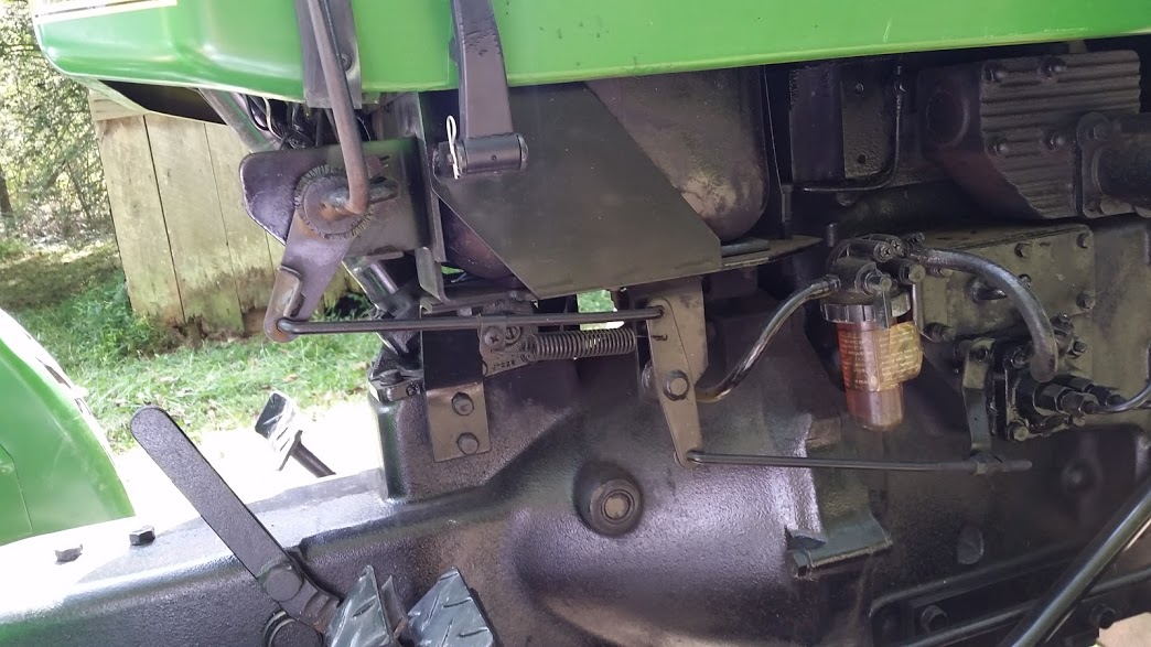

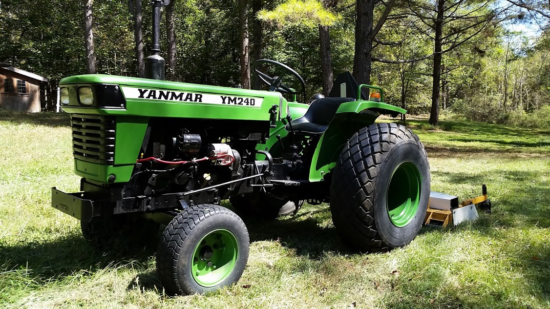

Hello all, I'm new to the forums and new to the world of tractors. I just completed my first purchase, a Yanmar YM240 that I found locally on Craigslist. The prior owner was an older farmer a few towns over, who used it mainly for mowing his 2 acre lawn at the house. Other than that, he just tinkered with it in the garage. I think that it's in pretty good shape, very clean, and you can tell he took care of his equipment. He was good enough to offer to deliver it to my cabin about an hour away, so that was the icing on the cake and made it too good of a deal to pass up.
I bought this with the following goals in mind: mowing my 1.5 acre lawn around the cabin, clearing out approx 2 acres of overgrown pasture, and finally putting in some food plots for next year's deer season. It came with a finish mower, so now I'm in the market for a roto tiller and maybe a brush mower (have a DR field and brush mower, so I can alternatively do some brush clearing by hand).
I'm looking forward to learning as much as possible thanks to the other good folks on here, and I'd like to ask two questions off the bat. Please pardon my ignorance, if applicable!
1) The throttle does not stay where set for more than a second or two, having the tendency to move downwards towards off. From reading around, I think this is a pretty common thing, but couldn't find a discussion of the problem for this particular tractor. Any tips on how to modify the linkage to get it to stick in place?
2) I wanted to get it good and greased, but I have no idea what type of grease the prior owner used. Should I be concerned about mixing greases in any place in particular? Is there a safe bet on what to use, or is it best to find out if possible? (I plan on calling and asking the prior owner, but just in case he doesn't know either).
Ok thanks so much for your time, look forward to learning as I go.!

Welcome!
You have good taste! (From another YM240 owner). :D
There are several owners on here, and lots of discussion recently.
That is immaculately clean, the guy took care of it. You'll love it.
For the throttle holding position, there's a washer between the movable and fixed parts, where the throttle lever is attached to the firewall. I made a replacement washer for mine but I don't remember what I used, maybe fabric-backed sheet rubber from an old boot. Preferred, buy the right washer from Hoyetractor.com. They have anything you might ever want for this.

Welcome to the forum. :welcome: Nice looking tractor. There is also a double nut on the end of the throttle lever. Could be a little tightening could solve your loose throttle. See item 12 on this 2000 drawing. Throttle works just backwards from yours but friction on it is the same. Yanmar Tractor Parts: THROTTLE

Welcome aboard from another YM240 owner! I've had mine about a month and have found this forum to be invaluable. That's a great machine you've got. VERY clean.
When I got my machine the throttle lever was so loose it would rattle down due to vibration and stall the tractor. As Winston pointed out there is a double nut on the pivot point of that lever. I tightened that and it will now stay where I put it. Maybe your problem is as simple as that?

No doubt you don't have the correct Nylon washer. Looks to be a round Wire brush? Also be careful tightening it up. It also looks as though the handle may have already been broken from over tightening it. Trust me it doesn't take much to break it. I broke off the Threads of mine.:shocked: really easily!! I was able to weld them back and here's a pic. of what the Nylon washer fits like. Fredricks Outdoors mailed me the correct one in a Reg. Env..

I suspected it might be something this simple, just didn't have much time to play around with it when I accepted delivery at my property. Will check this first the next time I head out there. And thanks for the suggestion to check parts on the YM2000 page on hoyetractor.com, I hadn't thought of that, and was wondering where the throttle parts were for my YM240.

I found the OEM throttle washer dried, inflexible, split and bulging out on mine. My first attempted replacement cut from sheet neoprene was too sticky. Second one made of fabric-backed rubber sheet still works fine a couple of year later.

you need to either tighten the throttle shaft up and or need and new friction disk. You can buy it at Hoye but the shipping will probably be more than the disk. I think there like $1 each? This is a good chance to get new fuel and oil filters while your there.
