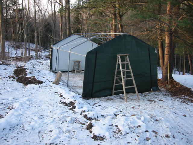

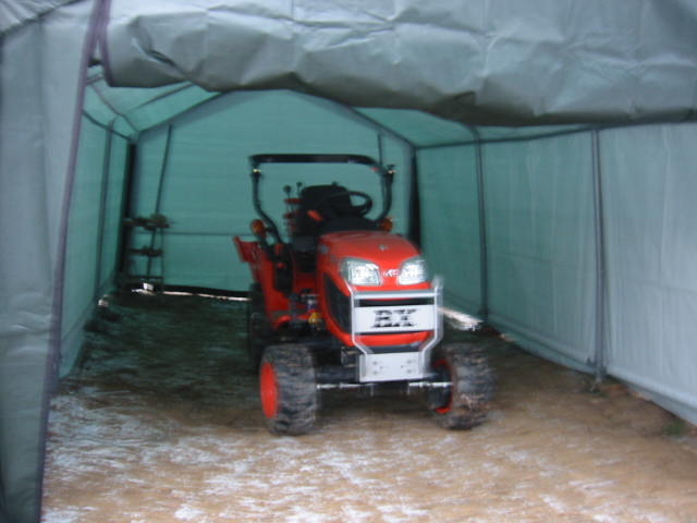

You can see the sad blue tarp I've been using to cover my new baby...that had to change.
First I cleared and leveled an area about 16 x 24 on a slope above my yard. Soil here is dense clay, stone and shale, so I had to dig quite a bit with the backhoe at first before turning to the loader bucket. Man, was I spastic at first. Got a little better with practice by the next day. That was encouraging. After a few years I might be pretty proficient with this machine.:D

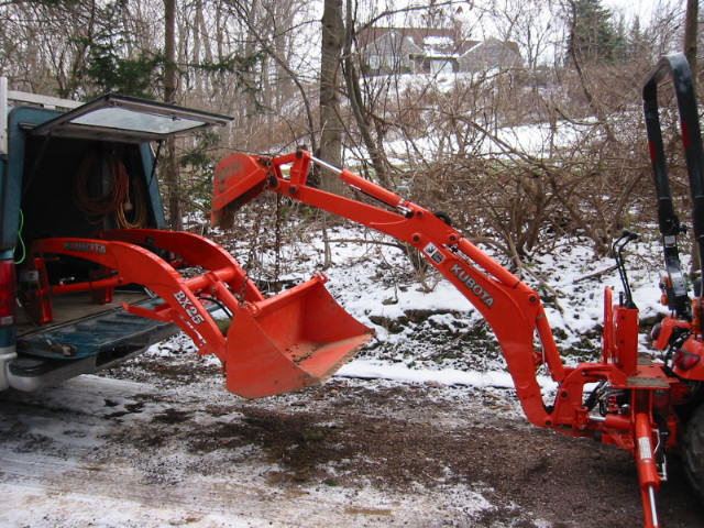

Anyway, tomorrow I should have the new toothbar attached, so we'll see how that works for additional digging. It was tough getting the loader in the back of the truck, especially with the cap. It's resting on the bucket and the frame, not the stand. Hope that's ok. I'm afraid it might be putting stress on the hydraulics??

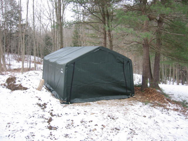

Next was the frame for the Shelter Logic garage. Impressive little unit for $229 (Black Friday this week at TSC)! Took several days to finish because of gusty winds. Also, if I had to do a second one, it would take 1/3 the time, like everything you learn.
Try as I might I couldn't get the supplied augers into our hard, rocky soil, so I sunk 2-5 foot lengths of 1/2' rebar at each leg (total 16) and anchored everything to those with 1/8" steel cable. I had to pound each of those anchors at least 50-60 times with a 10# sledge, so I'm guessing they won't pull out ever again.
I'm going to bucket in some crusher run and fine tune the leveling with packed stone. I suppose I should rent a tamper, but... Maybe I'll put some plywood down to roll a dolly on. Definitely gonna get some heat and lights in there for servicing this winter.

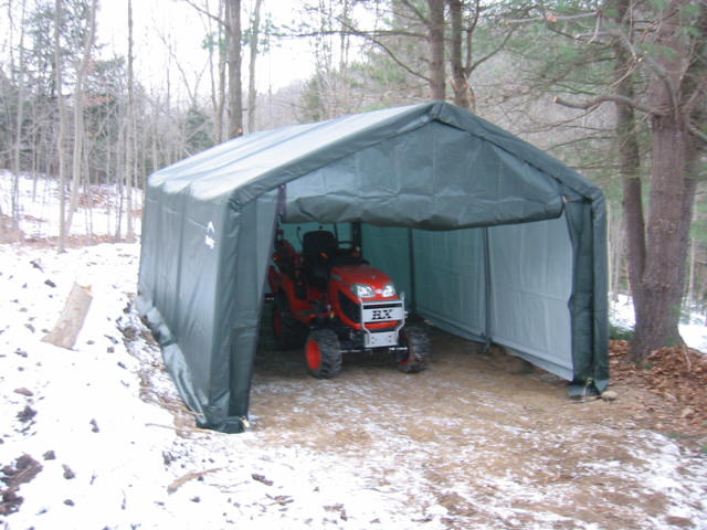

I think the BX likes her new home!

So you ended up loading the WHOLE FEL into the truck? Didn't the bucket come off by itself?
Get a hook welded on the back of the BH bucket too. (And don't try to load the BH into the truck with the FEL... ;) )

Well, excluding the anchors, about a day to frame and a day to cover. I was working in greasy mud to frame, though, and wind and temps in the teens to cover, so in nice weather it would have gone quicker.
Wasted another half a day trying to screw in those auger anchors. I hammer-drilled a one-inch hole by two foot deep to try and break up the soil a little, but rocks and hard shale just made it impossible to screw them in. Then I spent another day getting materials, driving in my rebar anchors and cabling them down.
Yeah, I couldn't figure out how to take the bucket off, and the manual is pretty detailed about the FEL. The problem I didn't forsee it that there's no good place to attach a chain so that the load is balanced. I got the back end in the truck and then kind of backed the truck into it, with a lot of horsing by hand.

If you look at the pictures from the first post, you can see that the Rops are down. The backhoe isn't mounted on the BX that's in the shed. I'm wondering if the BH will fit pinned in place.
/ My first project with the BX25 #17
Yeah, I saw that. It's hard for me to guess how much clearance there is at the door entry.
I hesitate to say this in a Kubota forum, but I have a "different" brand :rolleyes: that also has a backhoe. So I'm trying to figure out if this would work with my (red) tractor. :D
Jay
#18
I think it's 6'4" to the door, so the ROPS does have to be folded down...a small inconvenience, really. That's also about the height of the side walls, so there's no limitation walking around inside (as long as you're under that :)).
I took the backhoe off in order to bring it somewhere to have some welding done on the bucket to accomodate the Markham toothbar. With the backhoe on the tractor is 14' long and the shed is 20'. So, approximately 3 feet extra in both the front and back when parked in the center.
I've put up a string of lights we use occasionally in my construction business, (5) 100W rough service bulbs suspended from the ridge pole with some long cable ties. I may bury a permanent electric line eventually, but for now power is from a heavy duty 100 foot extension cord...whatever works. I've got a small kerosene salamander heater which should work ok to take the chill off when it's cold enough to warrant it.
And, yeah, a heavy snow may be a bit of a problem. Besides the end wall/rafter steel support members there's only two additional, which makes for a span of about 6 1/2 feet. Two nights ago there was an inch of heavy, wet snow sitting on the roof, causing a bit of a sag. While it wasn't a problem, it made me wonder how much of a total load that tarp could hold between the rafters. Anyway, I knocked the snow off from the inside with a wide broom before I went to bed.
I may try to add an additional rafter member between the existing ones, maybe out of some cheap 1x3s, in order to cut down on the span a bit. Only problem with that is I also will have to add a vertical wall "stud" to the ground for every extra rafter, as the horizontal framing members aren't designed to carry any weight on their own.
