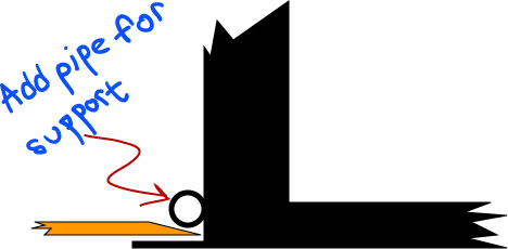

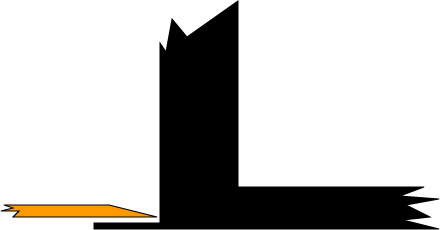

SkunkWerX, you've got it right. The weight is hanging from the top bars while the heels are resting on the bucket lip. (See first graphic)
These were not intended to carry heavy loads. However, I'm thinking about adding some pipe pieces to the heels that will hang over the bucket lip, like in the second graphic. What do you think?

It looks like the heel is not resting on the bucket lip, it is underneath the lip.
In other words, no weight supporting capacity.
I like your basic premise on Option B.
Anything that also allows the load to be distributed down to the bucket cutting edge will strengthen the set-up.
Instead of round pipe, I'd suggest something like a piece of square tubing? Something that protrudes into the bucket a little bit more and can rest squarely on the bucket cutting edge?
Something square/flat , even the lip of a piece of thick angle iron is not as apt to slide off/out should the forks flex forward a little.

I agree with skunkwerx, I was going to suggest angle iron. Looks like you are proficient with a welder so it shouldn't take long and would make it much stronger. Just my 2 cents

Good idea! I think I'll try some angle iron since I've still got some scrap left over.
Thanks, all for the suggestions.
