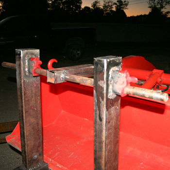

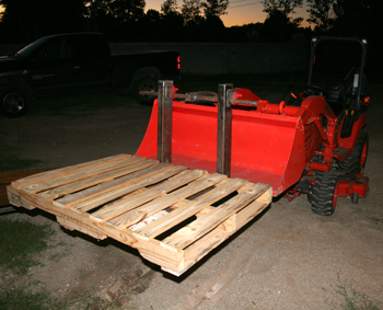

So I had Columbus Day off and needed a project. I've been planning these for a while and this was my first chance to get something done. The idea was to make FEL forks for my BX2350. I don't need to haul heavy loads, so I drew up a simple design that lets me adjust the width of the forks.

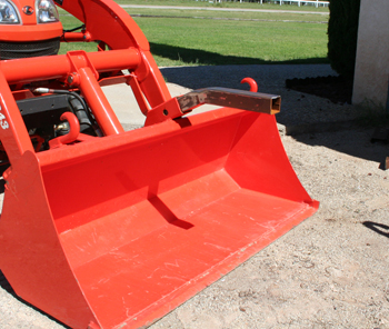

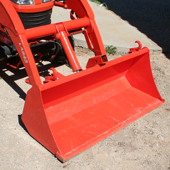

I've already put grab hooks and a 2" hitch receiver on my bucket, so I needed to plan around those things, too.

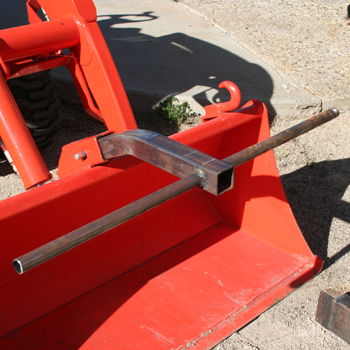

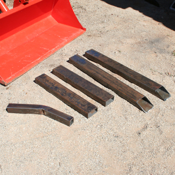

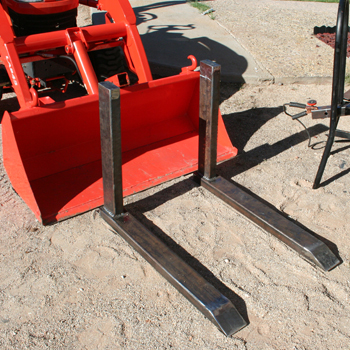

I cut all my pieces at the same time, after careful measure and triple checking the angle from the hitch to level ground.

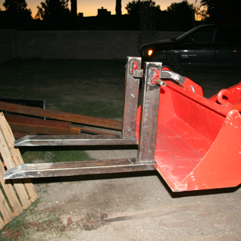

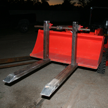

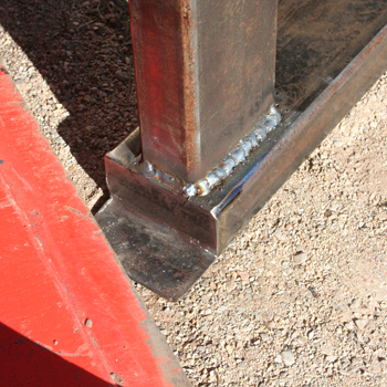

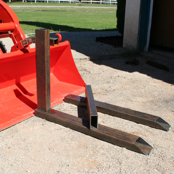

The forks are made from some leftover 2x4 tubing. I tapered the fronts to make it easier to stab the pallets and capped the heels with some angle to catch the lip of the bucket.

The bar is just some scrap black pipe cut to 36" and welded into a hole in the 2" attachment. I also welded some HF pipe clamp ends over holes drilled into the fork uprights. These are so I can quickly adjust the width but have them stay put where they're set. You can see how the forks sort of hang on the pipe, but the heels rest on the lip of the bucket.

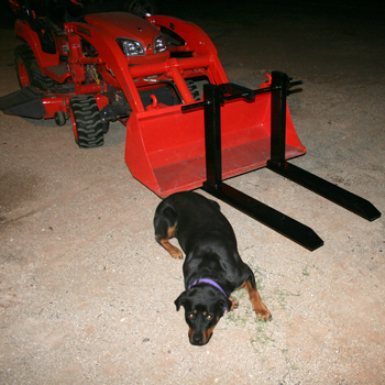

Side view shows how its all assembled.
First test run with an empty pallet was a success.
Finally, after dark, I gave it a stealthy black paint job and installed the standard security system.

SkunkWerX, you've got it right. The weight is hanging from the top bars while the heels are resting on the bucket lip. (See first graphic)
These were not intended to carry heavy loads. However, I'm thinking about adding some pipe pieces to the heels that will hang over the bucket lip, like in the second graphic. What do you think?

It looks like the heel is not resting on the bucket lip, it is underneath the lip.
In other words, no weight supporting capacity.
I like your basic premise on Option B.
Anything that also allows the load to be distributed down to the bucket cutting edge will strengthen the set-up.
Instead of round pipe, I'd suggest something like a piece of square tubing? Something that protrudes into the bucket a little bit more and can rest squarely on the bucket cutting edge?
Something square/flat , even the lip of a piece of thick angle iron is not as apt to slide off/out should the forks flex forward a little.
