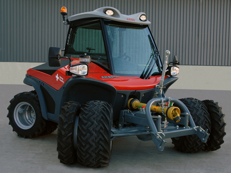

I think these machines are pretty neat.
Aebi TT206 (Terratrac) | ASH Aebi Schmidt Holding AG

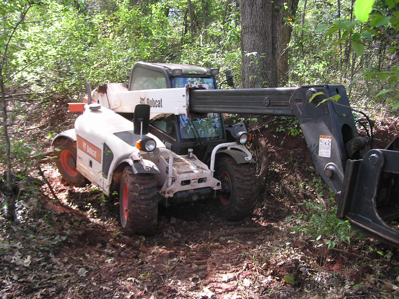

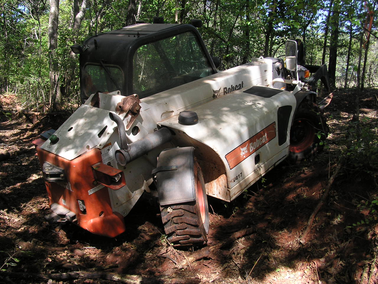

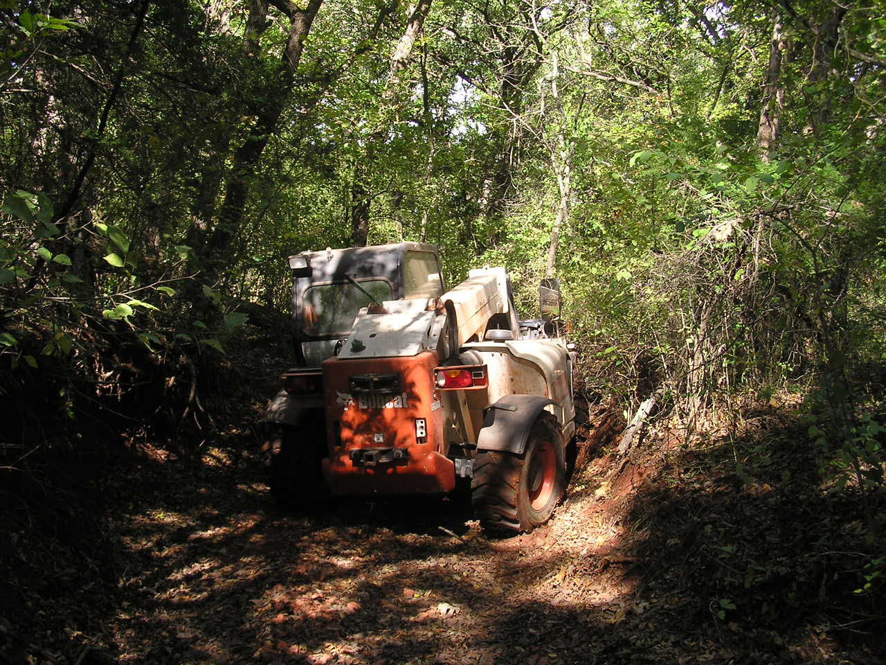

Here is my dream machine, cab with heat and air, SSQA, 6' wide, 6.5' high and 13' long. Tire size is 14x17.5. Top speed is 15.5 mph, drawbar pull is 7,000 pounds, boom breakout force is 6700 lbf, bucket breakout force is 4700 lbf and it will lift over 5,000 pounds, 17 feet high.

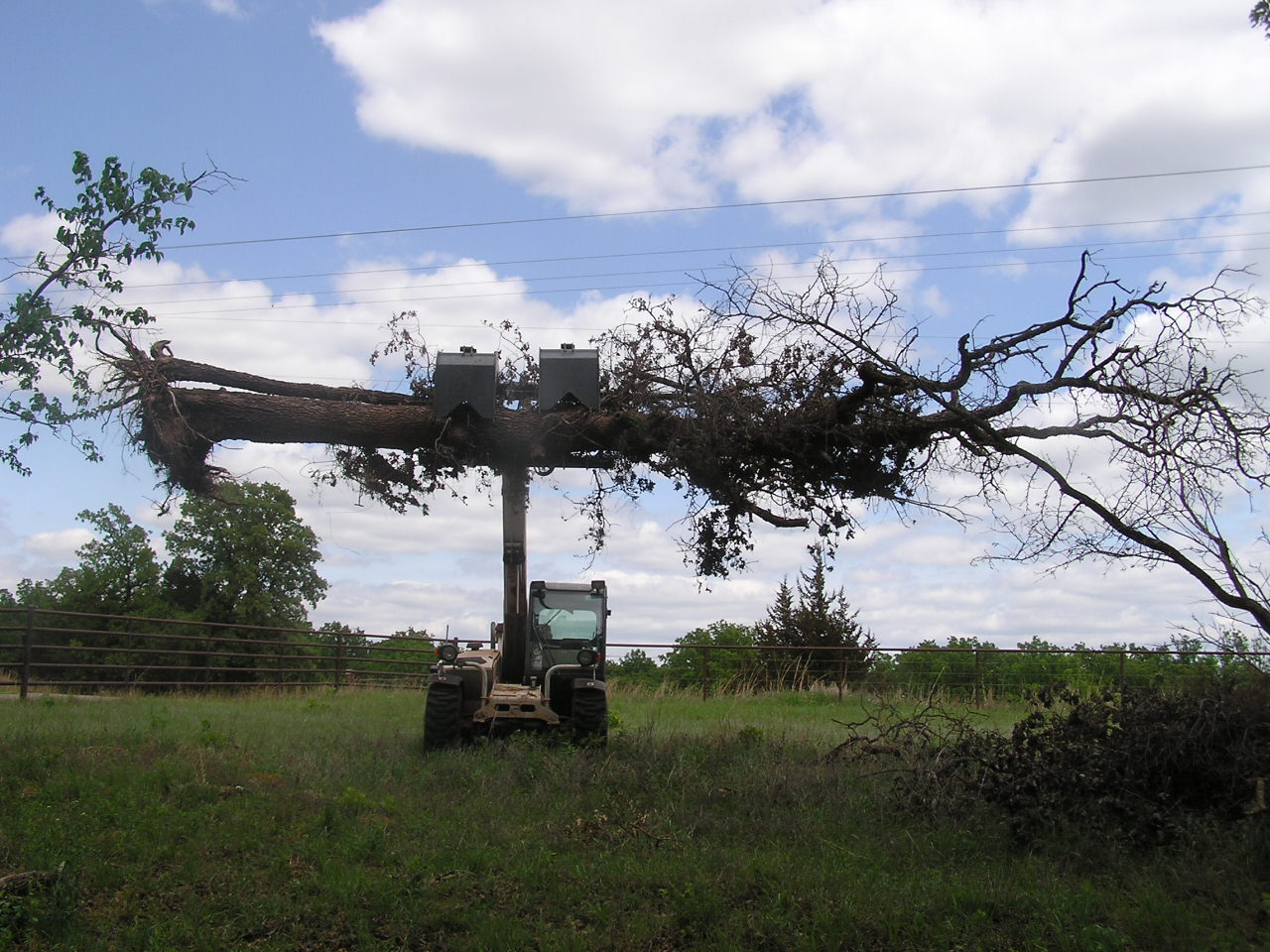

40' oak tree and a 5x6 round bale.

And it is unstuckable! :thumbsup: http://www.tractorbynet.com/forums/...t/160568-compact-telehandler.html#post3526054

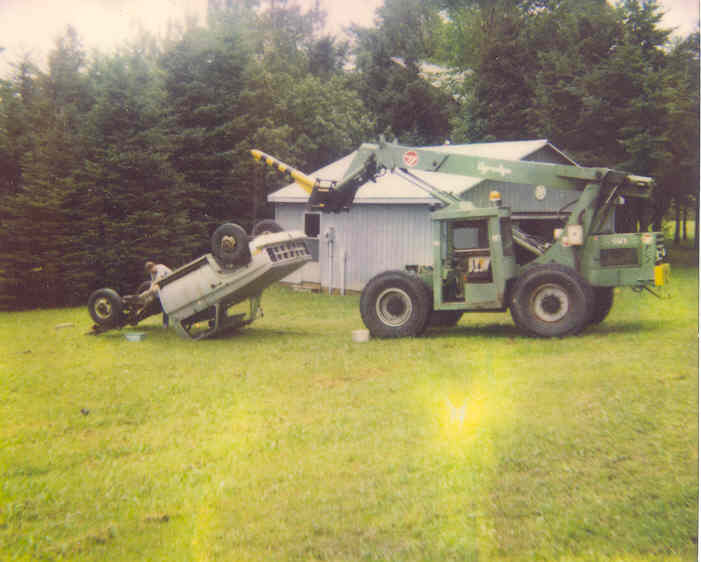

I used to have this Dynalift. Got it stuck once in the wetlands and yes, with some work, it extricated itself. I kind of miss the old girl, especially if I need to tweek something on the underside of my Ride! Scary as heck when twelve tons starts sliding on ICE!

Yeah, a V417 is exactly what comes to mind when I think of an articulated loader for tight quarters maneuvering around trees with no cab.
I was just showing a better machine than an articulated loader, "for tight quarters maneuvering without tearing up the ground". The OP wanted a cab.
I use the V417 in the woods a lot, with 4 wheel steering and 6.5' cab height, it will go where tractors and loaders can't.
