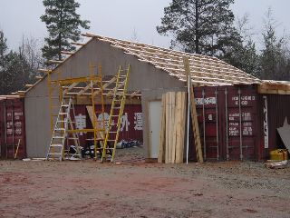

#31
The front side.
I was hoping to get the facia boards up, but the weather stoped me again.

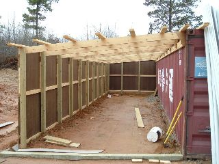

   / My Container Barn
#32
This is the left side. I'm leaving the front open. It has walls on three sides and is 40 feet deep. The floor will remain dirt.

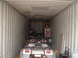

   / My Container Barn
#33
The inside of one of my containers. They get a little crowded, but still plenty of room to get around.

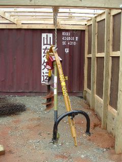

#34
An earlir topic was storage of your post hole digger. From those posts I decide to hang mine from a beam. I doubled them up with half inch plywood.

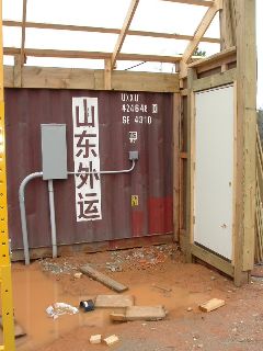

#35
I brought power to the containers back in July and used an outdoor 200 amp box. After the roof is on I'll install more outlets and lighting.

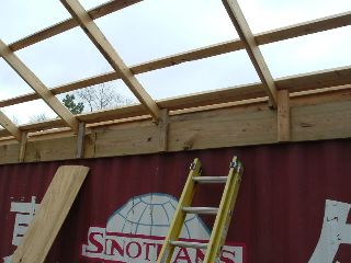

   / My Container Barn
#36
I attached the ledger board to the containers with 3/8 bolts every 2 feet and the truss rests on top of the 2 X 12. It's all held in place with blocking.

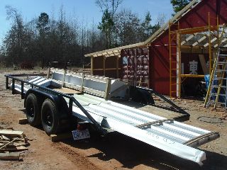

#39
I picked up my metal for the roof. It's going to take 28 squares to cover everything. I'm using R panels with a Galvalume finish. Total for the metal came to $2,316. The roof vent was over $200.

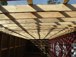

   / My Container Barn
#40
Before I put on the roof I've had a change of plans. I figured that if I closed in one side, I could make a nice little cabin out of it. Inside measurements are 37'4" by 10'9".
For sheetrock to work I had to add some more 2x6's to the roof. Now I have 16" centers.
