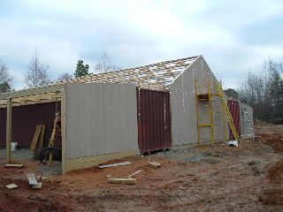

It' been raining allot and I've only been able to get in a couple days work.
The siding is all up now and I'm starting to prep for painting.
