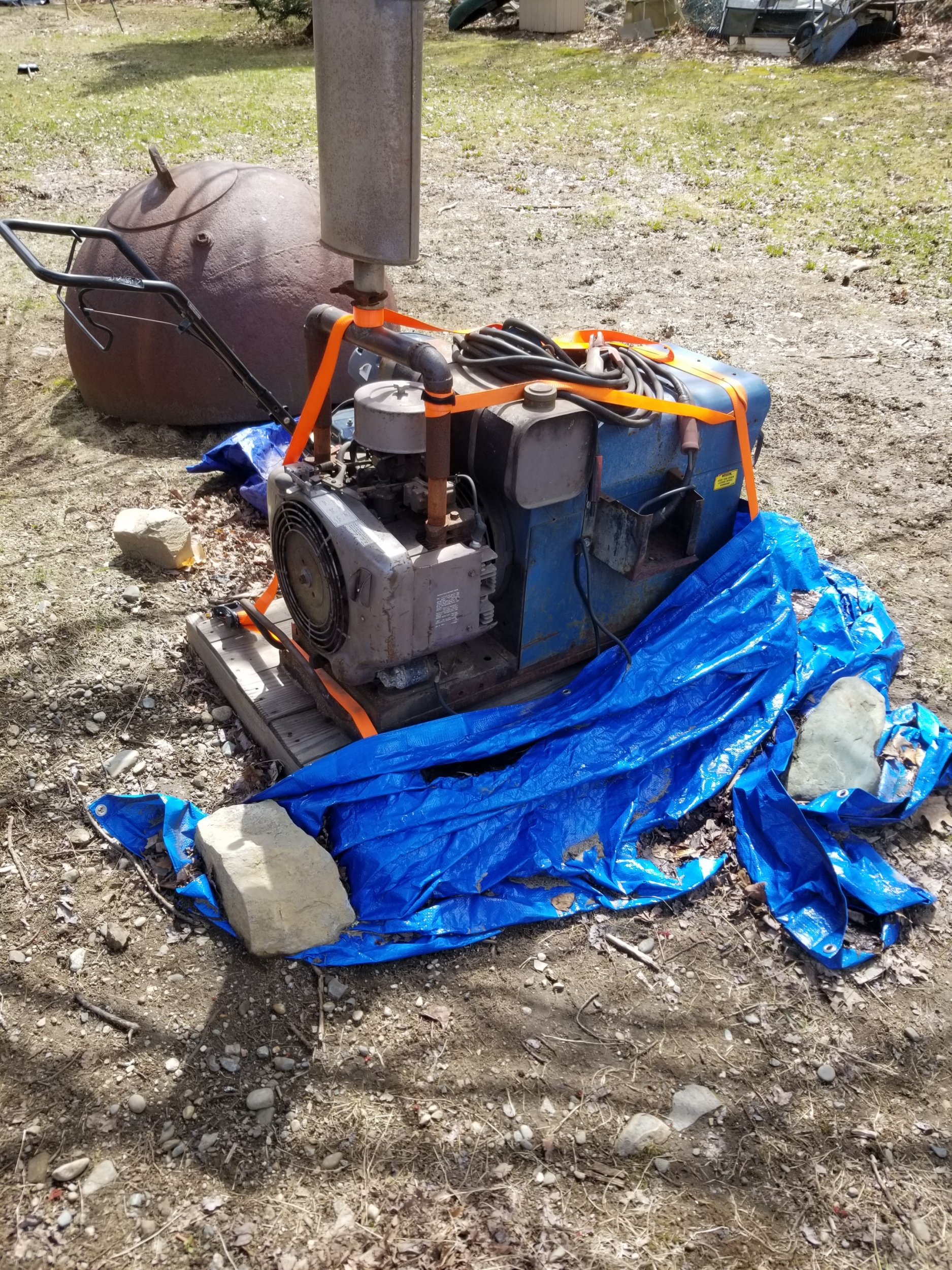

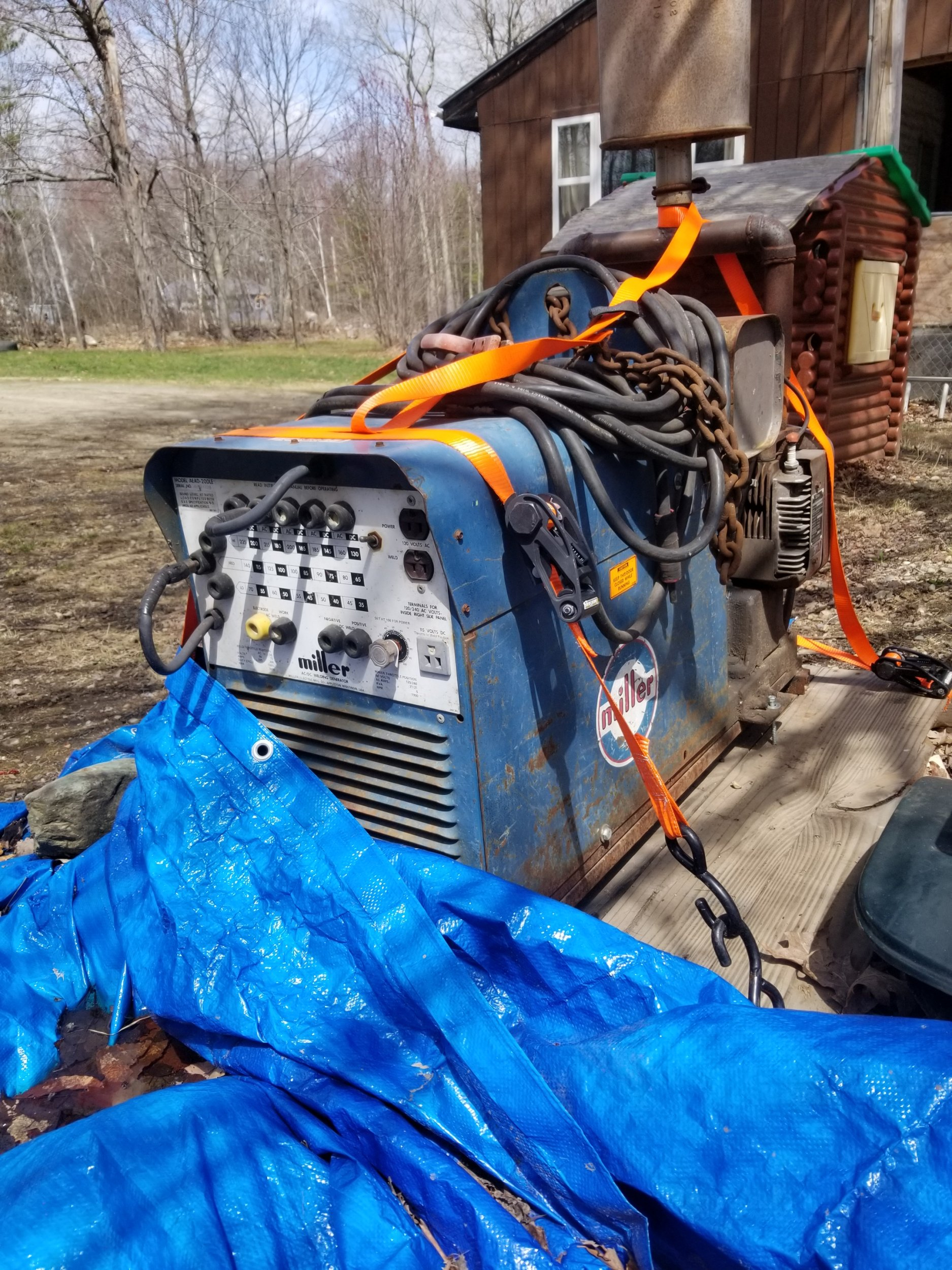

I've got a welder all of 50 feet from me at this moment, and yet I don't know how to weld. To be fair, it's not mine, but the owner isn't going to see the outside of a jail cell for a hot minute. Point being that I ought to both learn to weld, and take a picture of the beast to get you lot telling me how wonderful or terrible it is. 😂

I can't help but think it's at least as old as I am.
   / My bucket is broken ! #38
I have a tiny skidsteer with that engine.:ROFLMAO: Looks like a 'project welder'. I'd use a known-working one for my initial learning.. just my opinion.
