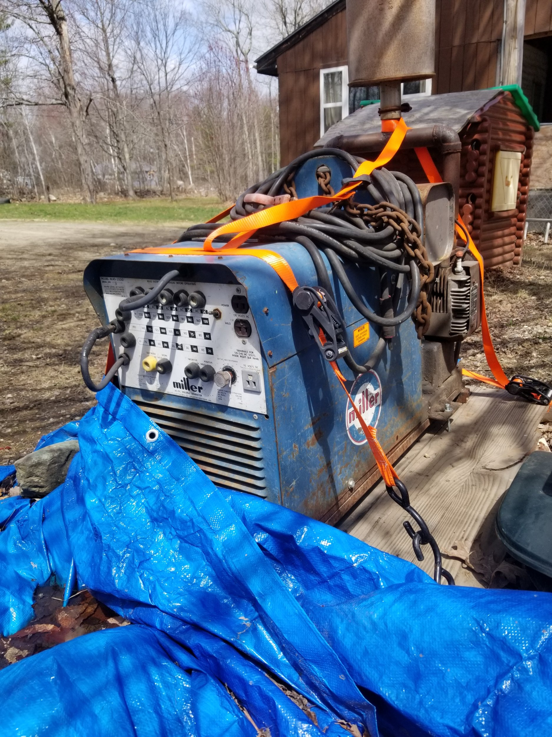

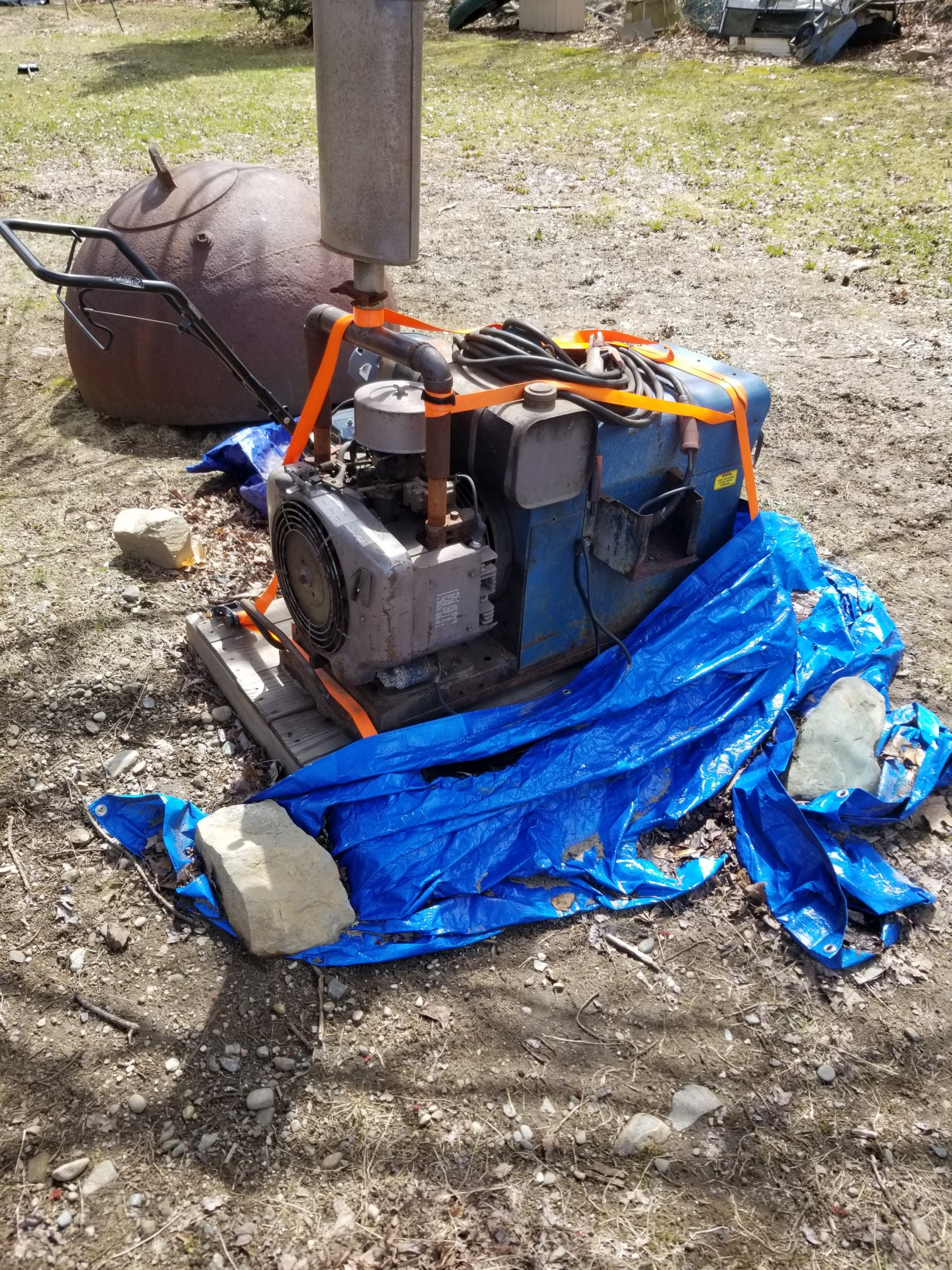

I can't help but think it's at least as old as I am.

I have a tiny skidsteer with that engine.:ROFLMAO: Looks like a 'project welder'. I'd use a known-working one for my initial learning.. just my opinion.
