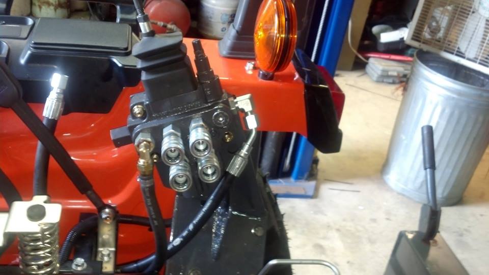

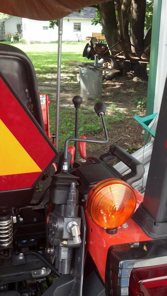

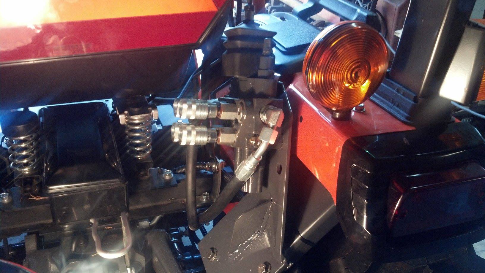

979593_10200545850067228_454832470_n.jpgHeres the setup I added to my Kubota B2620 for rear hydros. Used a valve 2.jpgfinal valve.jpgloader valve with power beyond fitting plumbed inline between power beyond of factory loader valve and 3ph.

I've been reading various posts on top-n-tilt and rear remotes and still haven't quite come to an understanding of what's involved... I just have pieces of the puzzle.
Could you show with a picture how and where you plumbed in to the factory loader power beyond, please? So is it Tee'd in or is the rear hydro in between the loader and 3pt? Thanks for any help you can offer.
Also, is there any manual or diagram that shows the actual plumbing lines for the Kubota B series?
/ my B2620 rear hydros.
I have a detailed post on orange tractor talks with pictures. There's others setups there also. Look in the fab and customize folder
