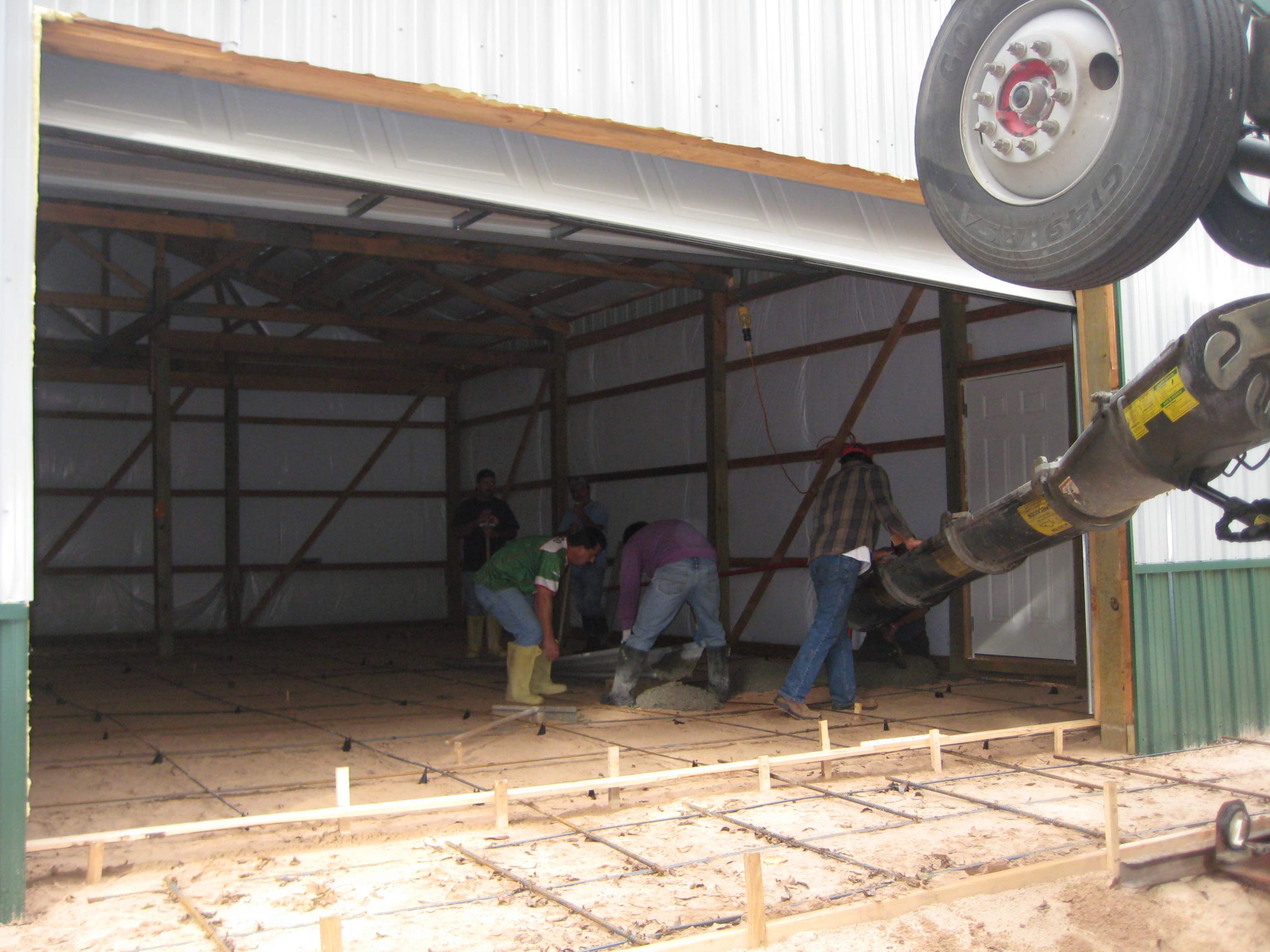

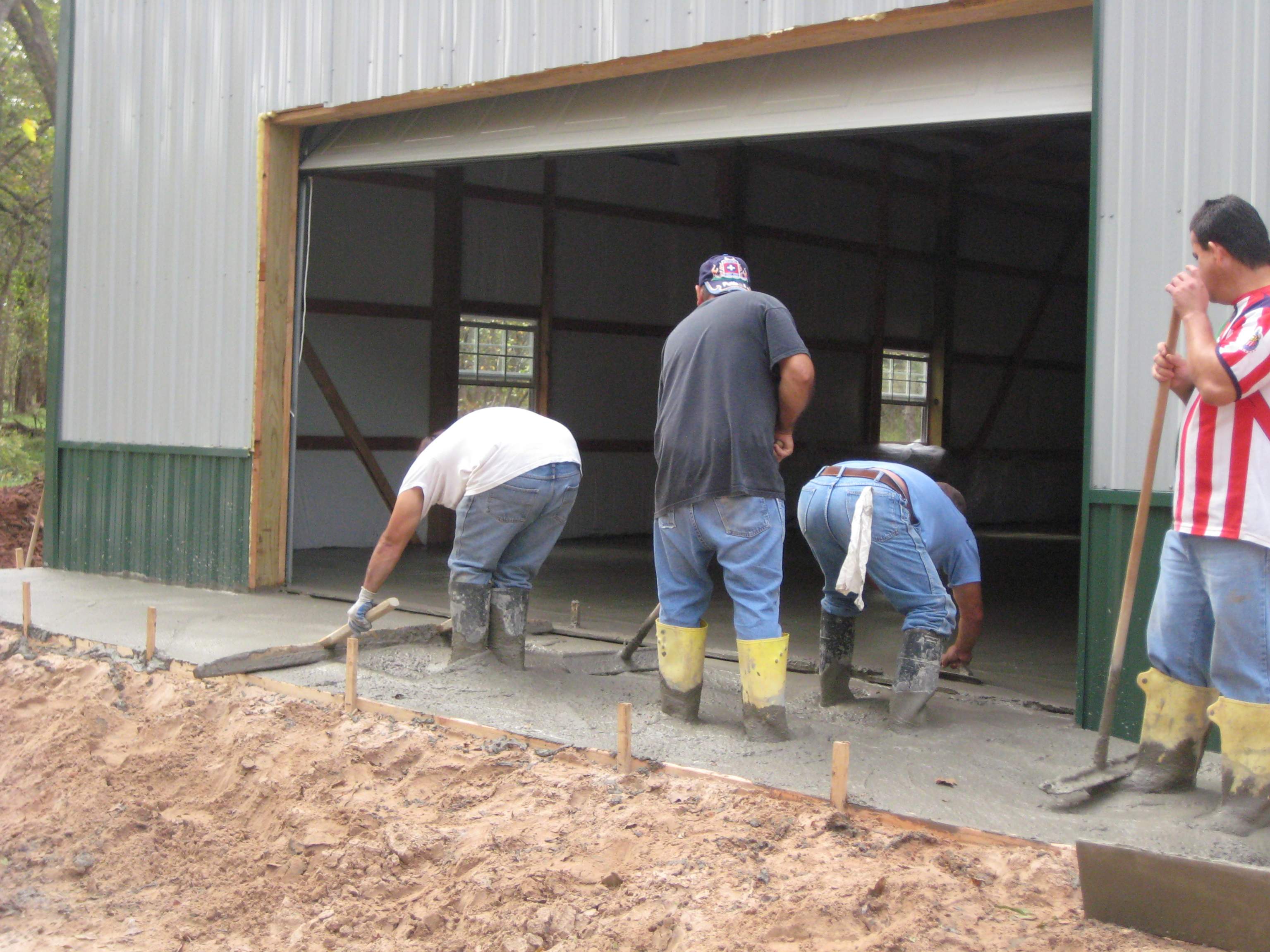

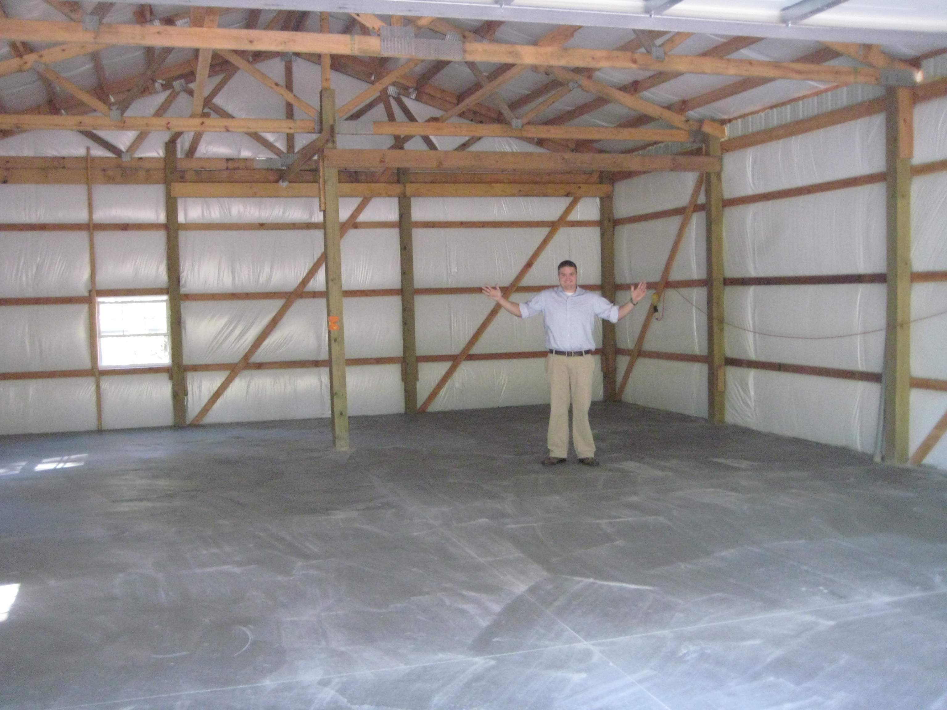

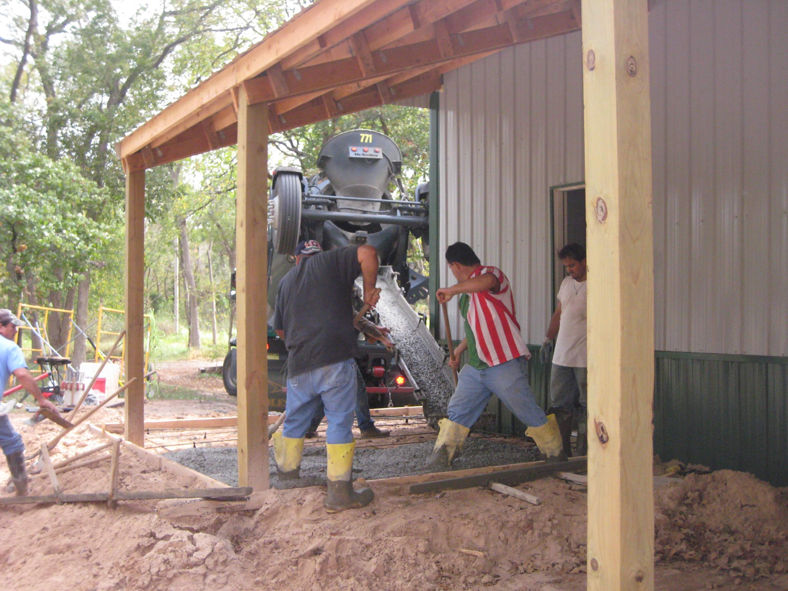

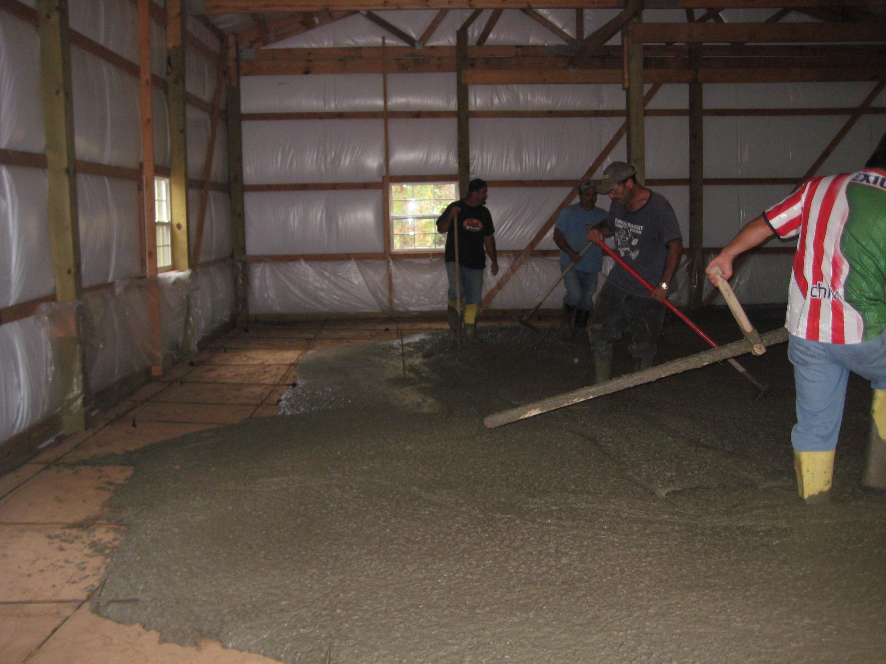

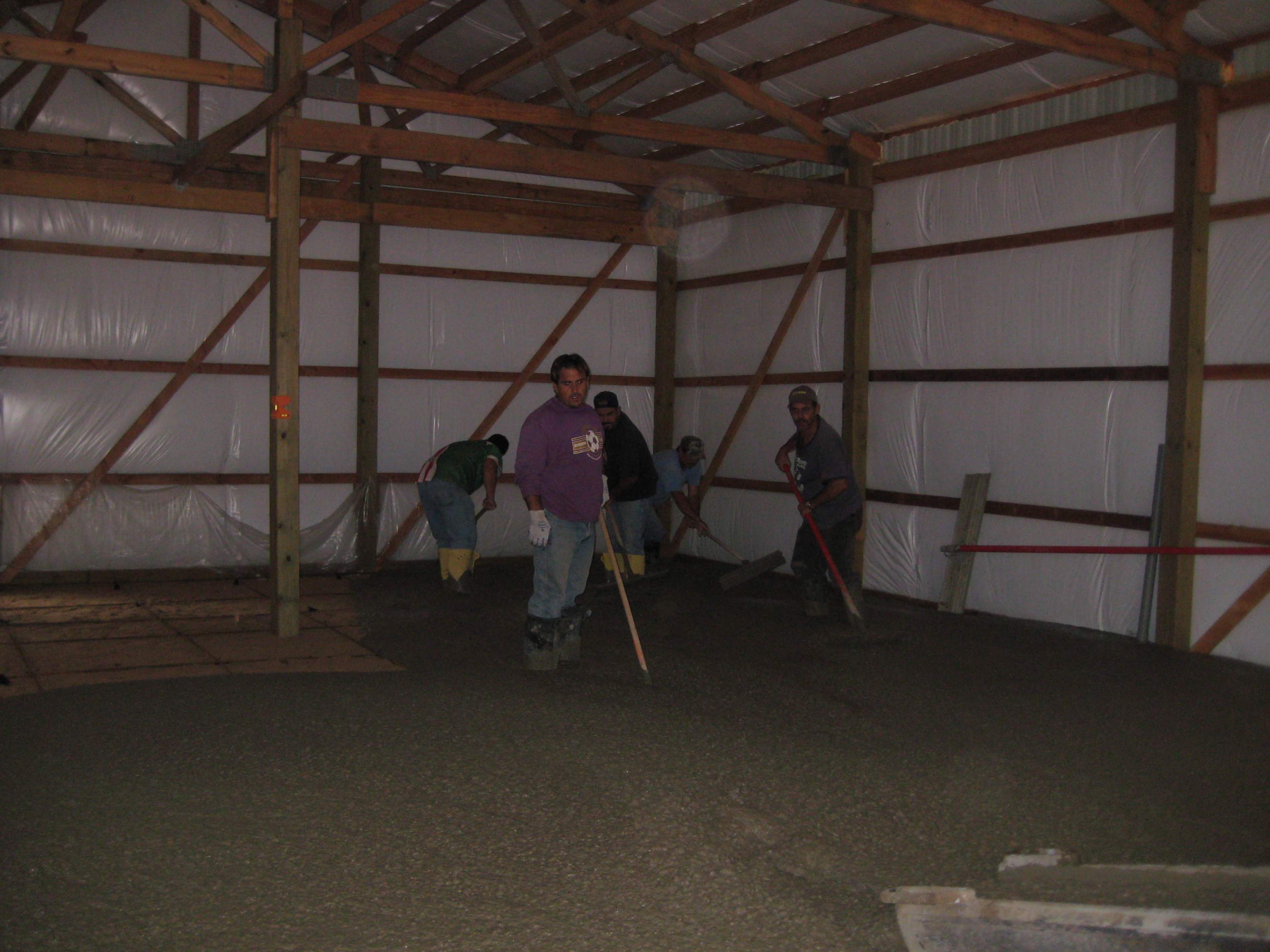

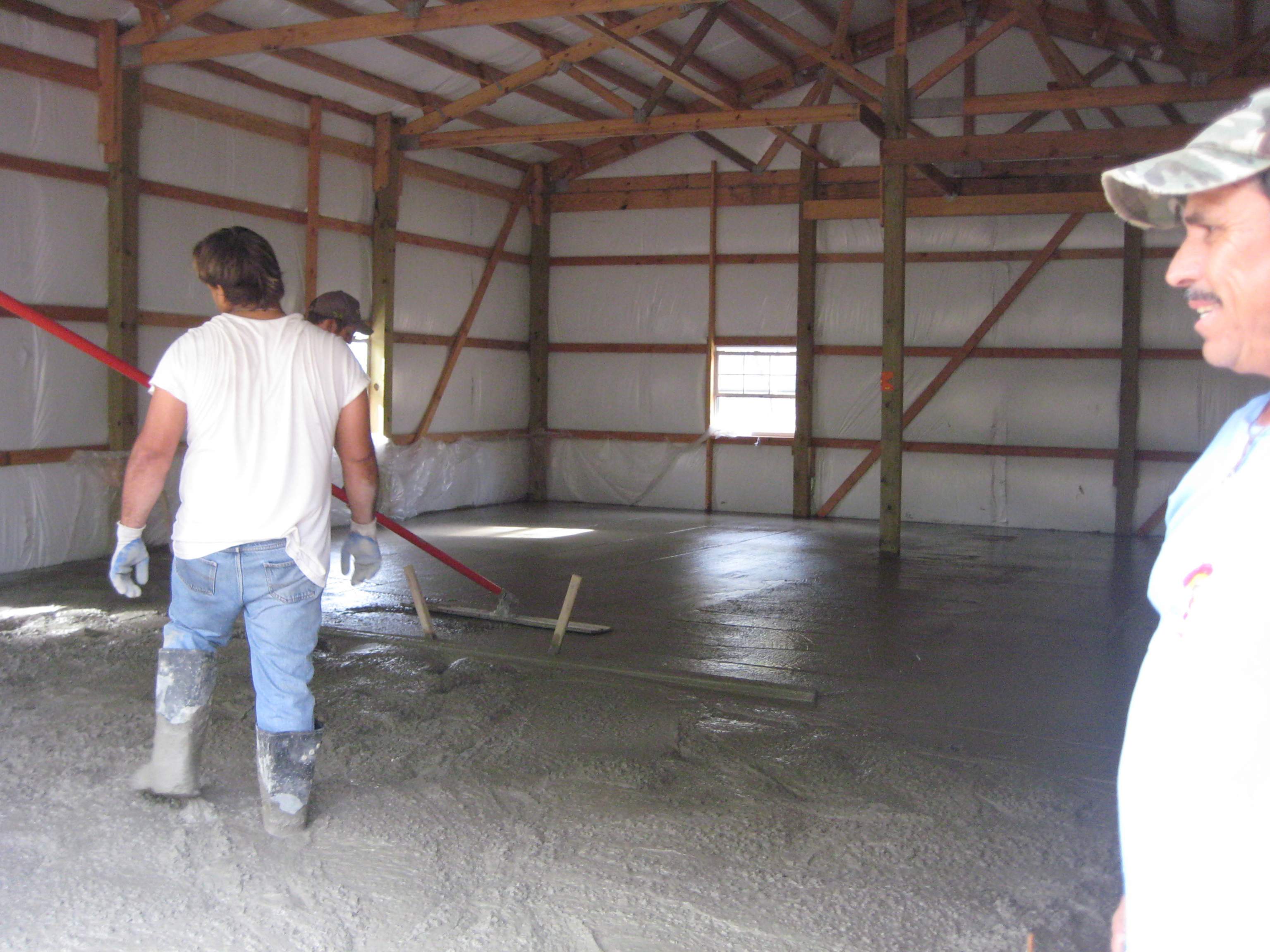

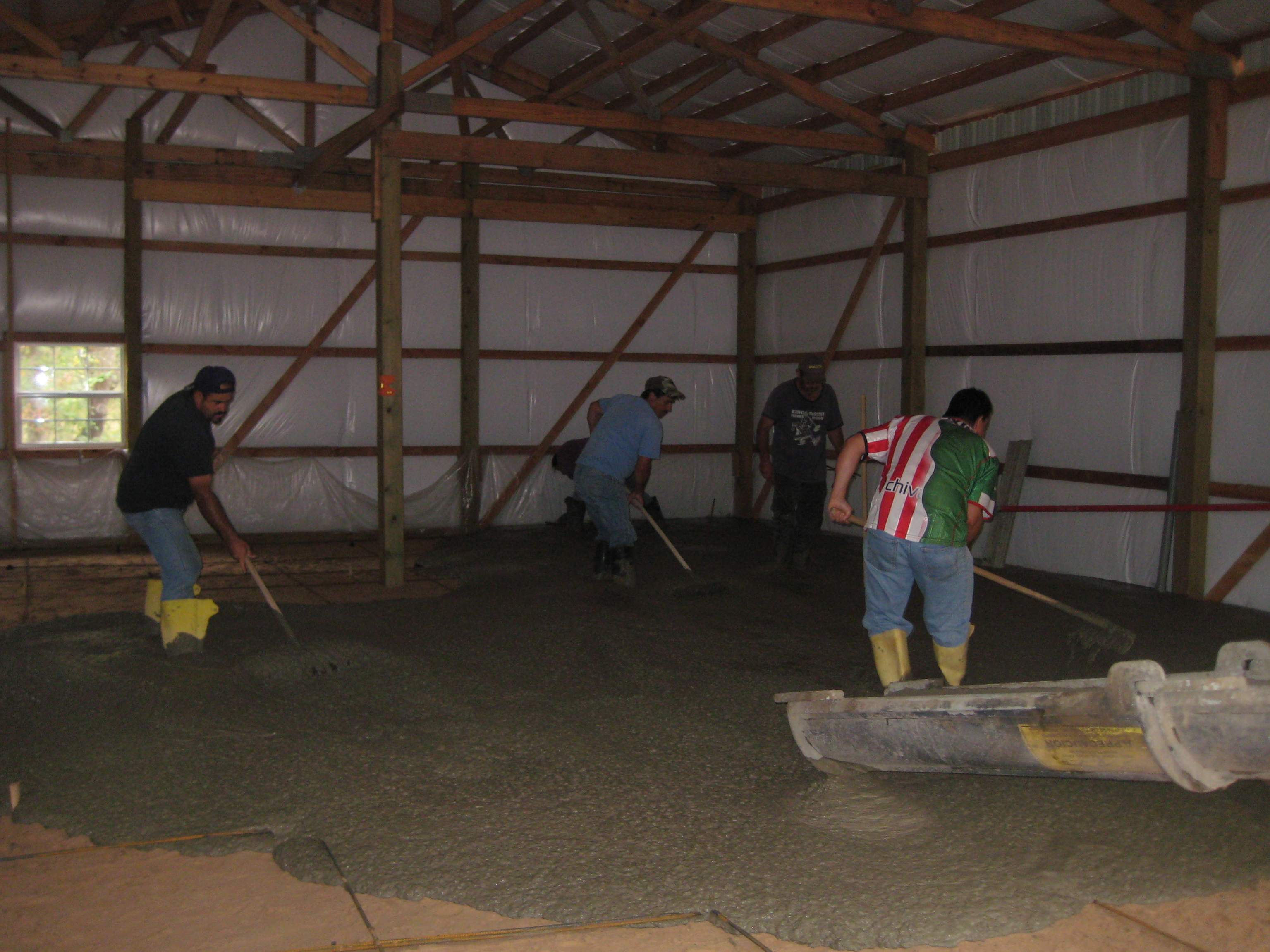

Despite the delay from last week due to weather, the concrete crew arrived this morning ready to pour my 20 yards. With a few extra hired hands, they muscled the 1st truck into place, which thankfully filled up 2/3 of the barn floor. Then the 2nd truck showed up an hour or so later and finished off the barn, moved onto the front apron area, then repositioned for the porch area. After all was said and done, turns out they had a bit extra left in the truck, so I had just the place for it.

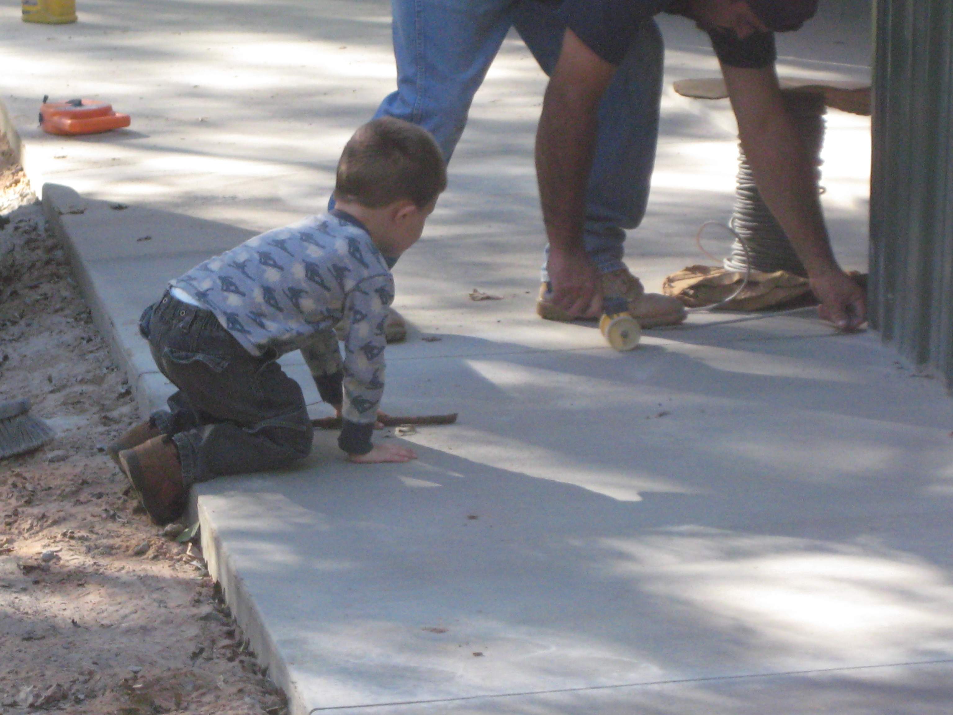

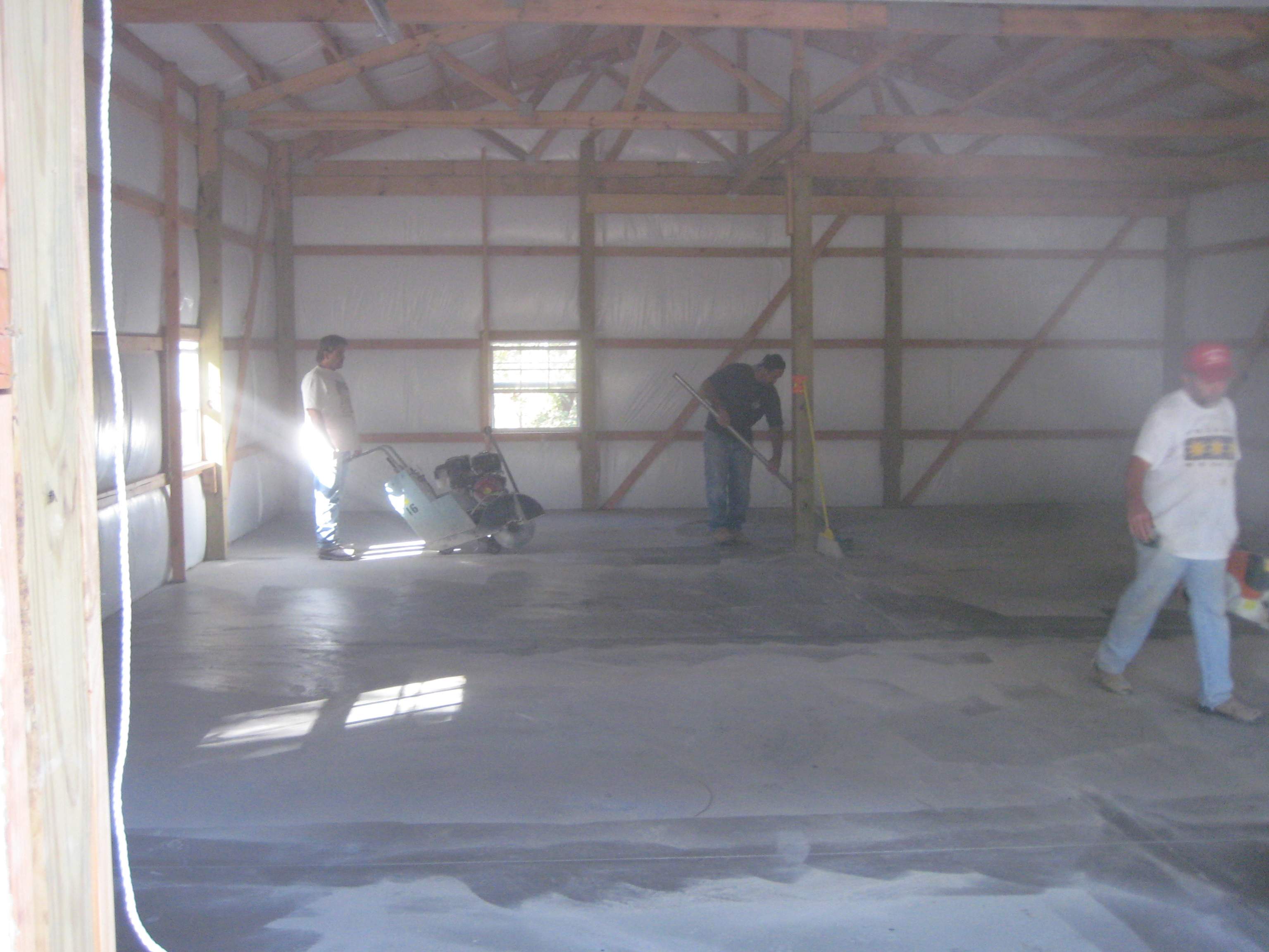

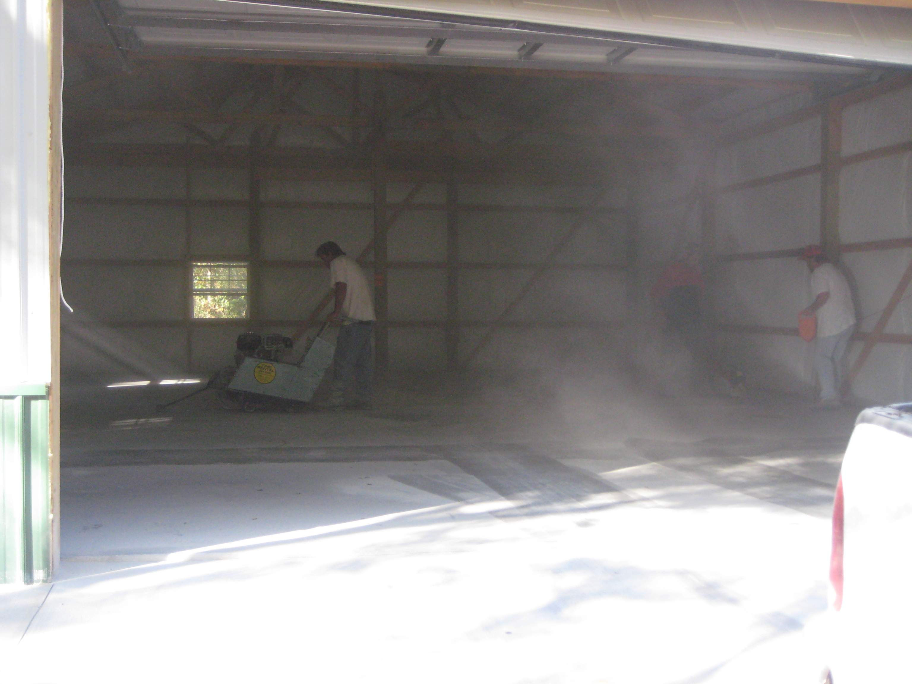

The contractor held good to his word and came back the next day after the pour with a couple of concrete saws. The sidewalk and porch had dried, however, he was very apprehensive to cut the floor inside the barn. He felt it was too green. He said something about 2 different types of concrete saw blades, one for green concrete and one for dry concrete. He dug around his truck toolbox for a bit and popped up saying, "This is just the blade that I was looking for" and brandished this green colored diamond-blade. For all I know, he could have been just blowing smoke, but at least it didn't chip when he cut it. I couldn't do that finish work b/c between the noise and dust, I'd end up with lung cancer and deaf.
After installing "backer rod" into the concrete saw cuts that were outside, they caulked those cuts with a self-leveling polyurethane concrete sealant. The inside dust was swept up and they were complete. All in all, I'd have to say I was pleased with his work. Despite his "pan handling", the job looks great! Check out my pics I've attached.
