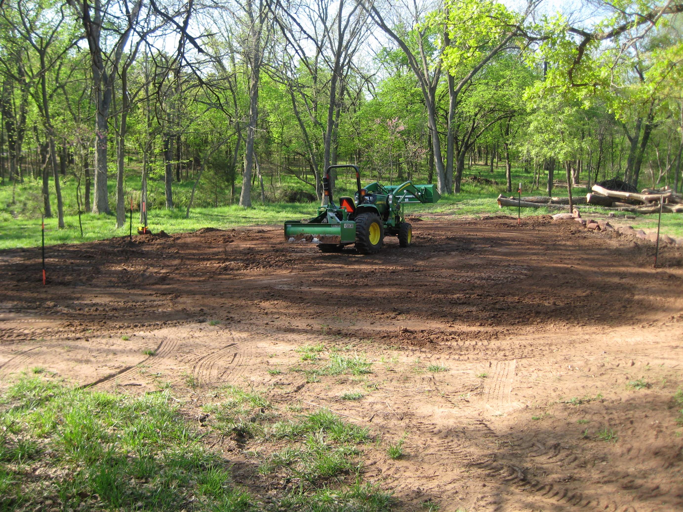

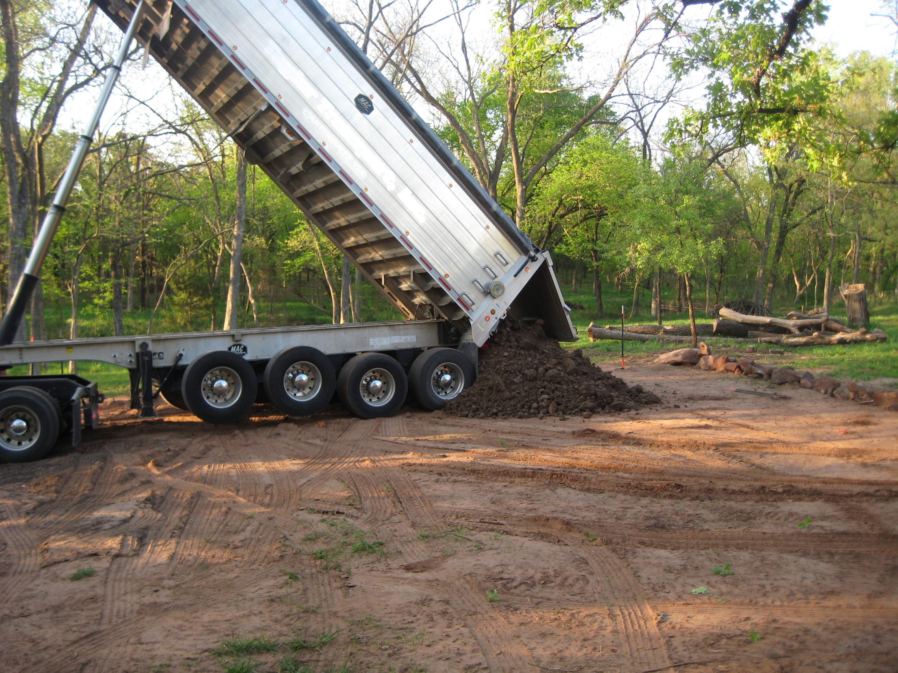

Well, after much thinking I finally bit the bullet and purchased a pole barn kit today. I've had the blue-prints for about 3 months, already drilled the holes earlier this week, and should be getting the lumber and some materials on Aug 2. What may seem like a simple build for many has had me up many a nights thinking about details and features.
The kit is a standard 30x40x12' building; however, I've added a 10x40 "lean-to" along one side to give me a covered porch. I came up with the design on my own, then I found this exact project that was built by a construction company online.

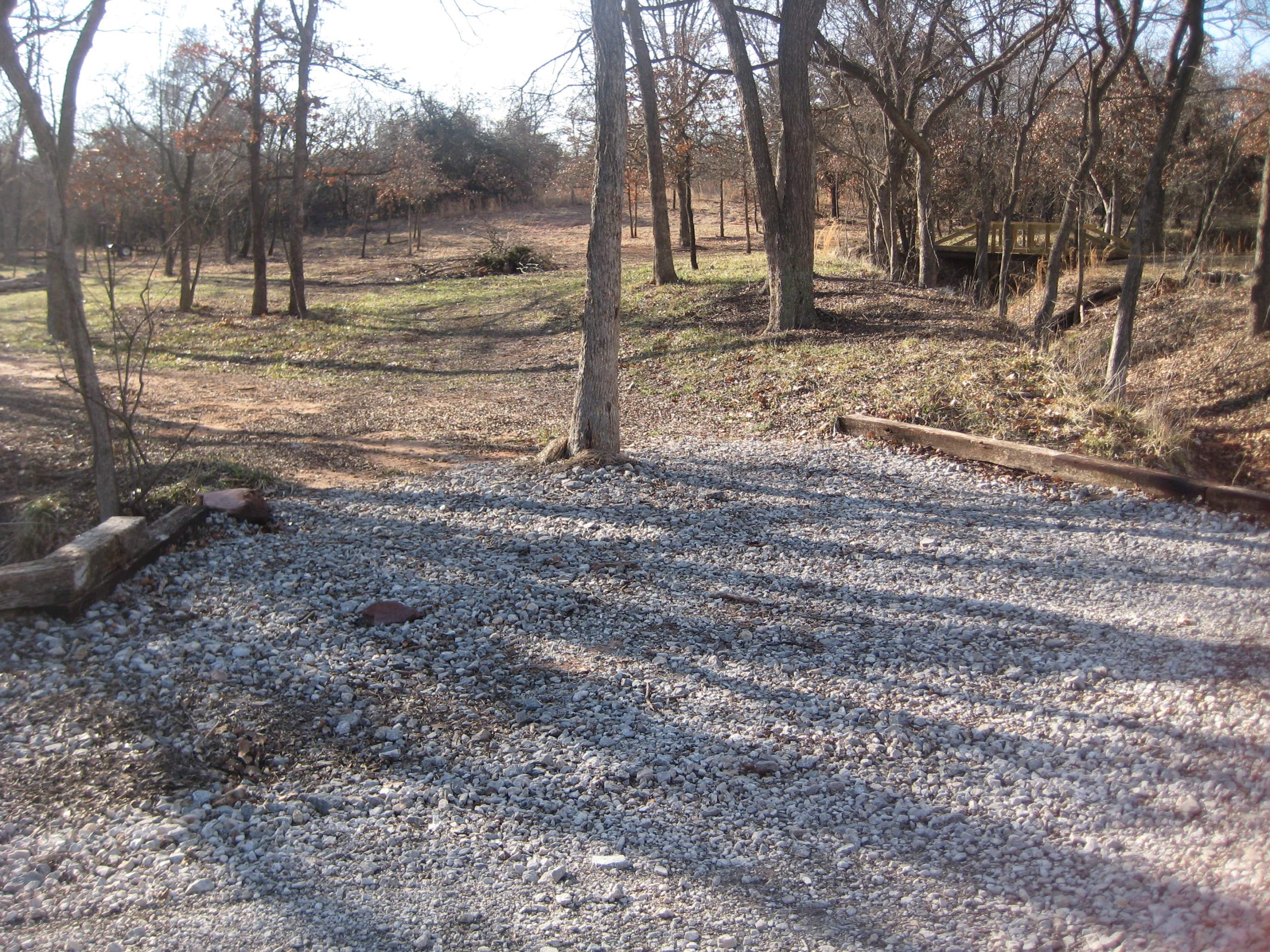

Mainly the barn will serve as storage for my tractor and equipment. But I do like having the versatility to possibly use it for a shop or barn one day.The poles are spaced 10' OC as well as the trusses. That surprised me seeing as we do get some snow here (about 16" in one storm this past winter) and always have significant winds here (also known as tornado alley).Their blueprints indicate it was designed for use in Oklahoma and they've had a 30x30 erected for 15 years on site. Said its survived 2 close tornadoes (close enough to literally suck off the metal on a run-in shed only 10 feet away).
I am planning to have crusher-run down and top dress it with 3/8 chip screenings. Hopefully this will water in pretty good. I'm still wavering on insulation. I've thought about putting down roofing felt to help with condensation. They had a light insulation with a foil backing on it that said it blocked 97% of heat transfer. Those were about $210 a roll and the roof would need 2 rolls. I'm gonna think about these and maybe decide once I get my frame complete.
