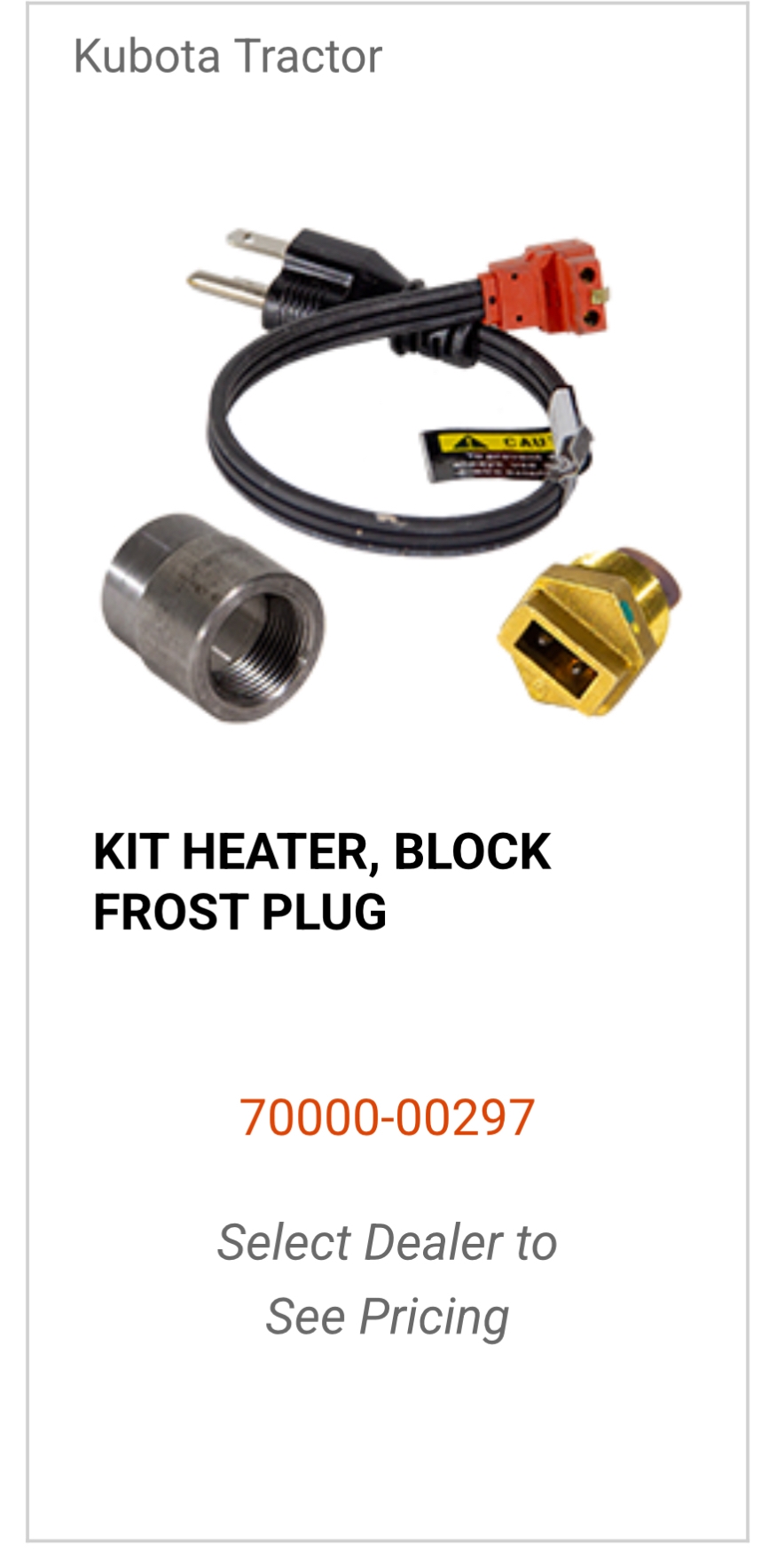

I was hoping to install an engine block heater on my MX6000 that is used for moving firewood and snowplowing. We've had a few nights when the morning temps are below freezing and the tractor started HARD on those mornings.
My old L3560 had an engine block heater that made it a little easier to start after that cold nights.
When I called the dealer to ask for the proper part number, he told me that the MX 5400/6000 do not recommend engine block heaters for startup.
I searched a bunch of the Kubota sites and they have a number of block heaters listed but none of them show that they fit the Mx5400/6000 tractors.
It shows this model:#70000-00297 Block Heater Kit but under the 'fits models' dropdown, the MX5400/6000 is not listed.
Thoughts? I find it weird that Kubota would not offer the block heater for those tractors.

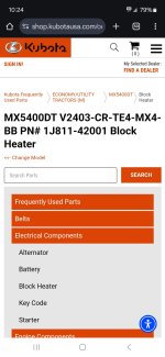

Searched MX5400 heater and found this through Kubota

That part number is for the engine itself, drilling down from that page:
This is the same heater I put in my L4060 9 years ago, a driven in bushing and threaded heater. The heater element does not extend beyond the bushing, so there are no block clearance issues.

Yes, exactly. It didn't post tge whole picture, but it shows it as tge same kit mentioned

That's the one I thought would work, but the parts tech told me that it's not recommended for the MX5400/6000 series tractor. Can that be right?
   / MX5400/MX6000 Engine Block Heater #6
Might be. It looks like the spud is a machined plumbing part without exterior threads.
So how does it mount into the block??
Is this is a type of adapter that is made to be driven into the block after the freeze plug was removed? And held by friction?
Not sure I would want to do that to our Kubota.
How about an in-hose heater instead? Or a lamp.
