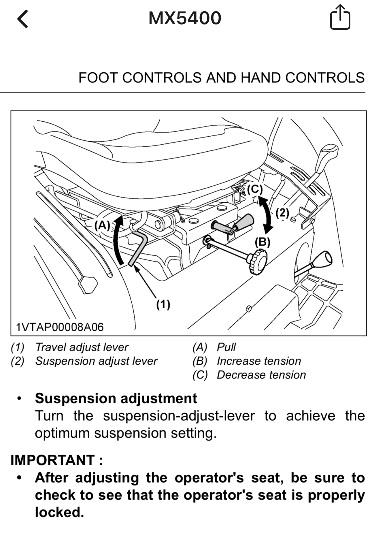

Adjust the seat adjustment to softer and it will solve the problem
Details?

I don't believe that there is anything short of disabling it. On my 5400 I unplugged the switch, installed an automotive fuse in the connector & zip-tied it in place.
I bought a new MX5400 in '22, and I am almost ready to completely disable the seat safety switch. It entirely too sensitive, and and just about any change in position on the seat will shut the tractor down. I'm 170lbs, and its aggravating trying to run/watch any implement behind you without the tractor trying to turn off. Looks like this one is physically built into the bottom of the seat cushion, so I am not sure if there is any way to make it less sensitive. Its bad enough that my 130lb wife and 140lb son can't even operate the tractor.
Any solution short of disabling it all together?
   / MX5400....I hate the seat safety switch #56
Our JD 4600 and our old Craftsman lawn tractor use the same setup, even looks like the same switch. It's a push-button momentary switch on the bottom of the seat that's normally OFF. Sit on the seat, something presses the button, and allows the tractor to operate. Remove weight from the seat, and it switches off. The switch is easily replaceable with the seat tipped up, and it's probably easy to find a cheap aftermarket replacement. (Though I wouldn't be a bit surprised if the JD part has something about it, like a longer button, that would mean the common aftermarket part wouldn't work.)
The JD switch started acting up the way you describe, and I simply bypassed it. I considered replacing the switch, but I'm nearly 75, and grew up driving a 1950's tractor that didn't have anything to keep me safe from my own folly except the training that my father gave to me, so I have learned what I should avoid doing.
The lawn tractor switch is still working as designed, so I'm leaving it alone. If I hire a kid to mow my lawn for me, one that hasn't had the advantage of my father's rigorous and extensive training, I don't want that switch disabled.
   / MX5400....I hate the seat safety switch #57
I would physically move the switch inside the seat closer to your body - so that your weight would close the switch easier. Right now it looks like when they made the seat - the switch was put too low and it needs a lot more weight to close the circuit - Depending if the switch is indeed an open circuit type or a closed circuit one - just change the language above). It needs to be closer to your body !
