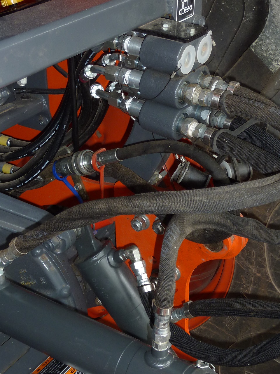

Measure the opening, that will tell you right there. There are no other couplers that size.
   / MX5200 Rear Remote Coupler Size & Type #13
Thanks. Between the backhoe, loader, rear remotes and 3rd function they all appear to be different sizes or types
Here are a few photos of the rear remotes
View attachment 561462View attachment 561463View attachment 561464View attachment 561465View attachment 561466
The rear remotes on my MX5800 look like this:
In fact, the remotes on all 6 Kubotas I've owned are this type. I believe they are 1/2" pioneer style.
I never realized Kubota supplied more than one type of connector on their remotes.
Thanks for posting the information.

I confirmed mine are 3/8. Thanks everyone for your help on order from Messick

Exactly. How do you think I felt when my customer contacts me and says, "What's up with the couplers?" He had the 3/8" couplers and up till that point in time, every MX had had the 1/2" couplers like yours.
Now the B series has both types, the L4701 has both types as do the MX's. :confused2:
Sometimes you just have to wonder what these manufacturers are thinking? :confused3:

Finally the correct connectors arrived from Messick’s. Tried and they actually fit
These are not the connectors shown on the parts list. New Holland version was $5.00 cheaper than generic
