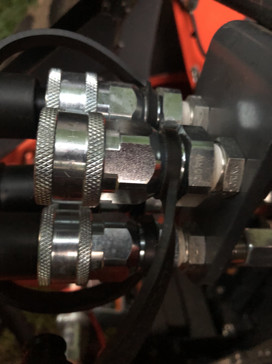

I tried to connect up my Valby CH160 wood chipper to my MX5200 rear remotes and the Valby (and all my other equipment) is 1/2 inch. I looked at Messick online and ordered some. However I got inpatient and went to a local Kubota dealer and picked up the same male couplers. Unfortunately they do not fit even though they have Kubota part numbers. slightly too large diameter. Hopefully someone knows the correct size, type and par number for the correct male coupler.

Any chance of a picture of your female couplers and the location on the tractor?

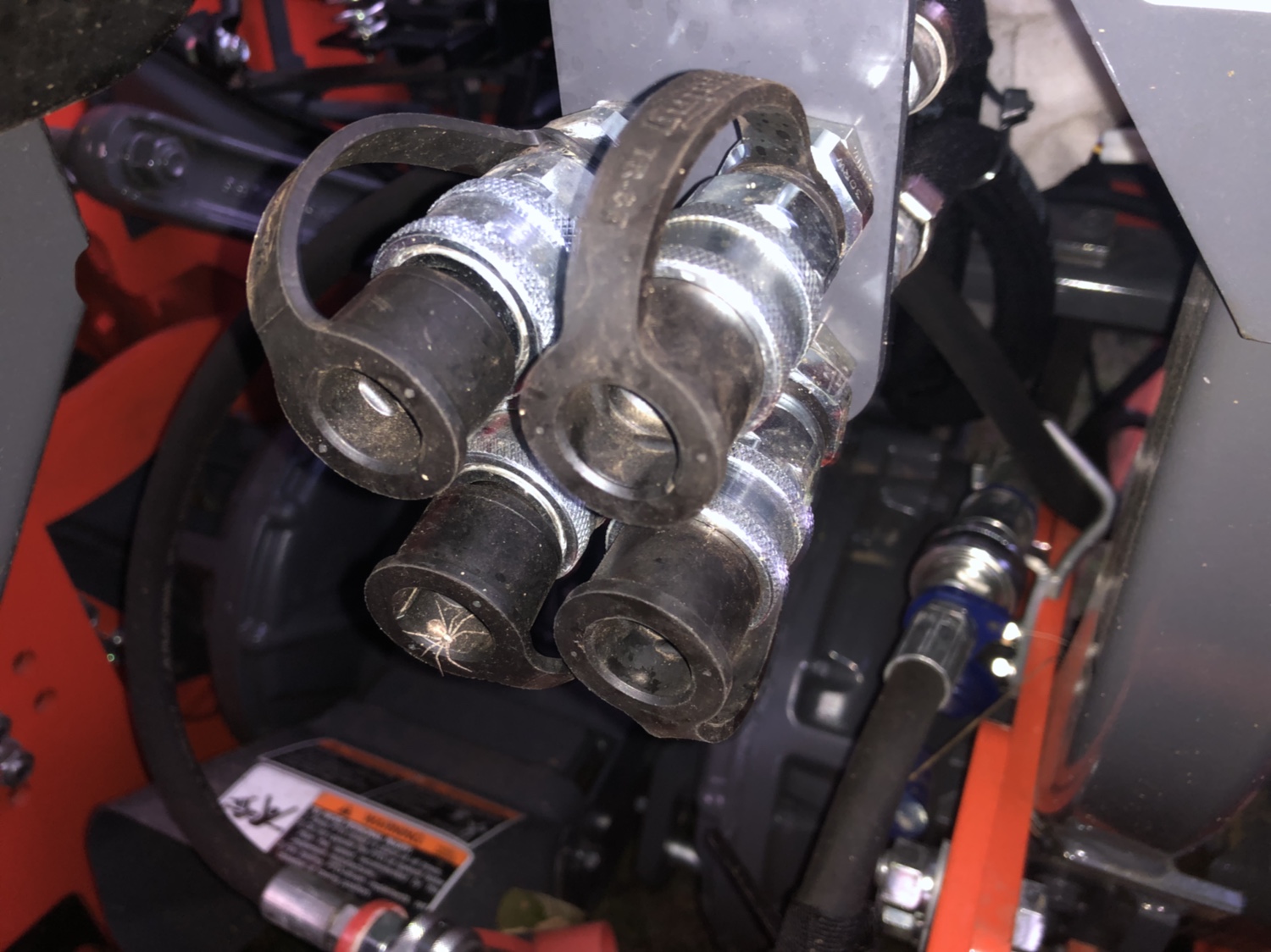

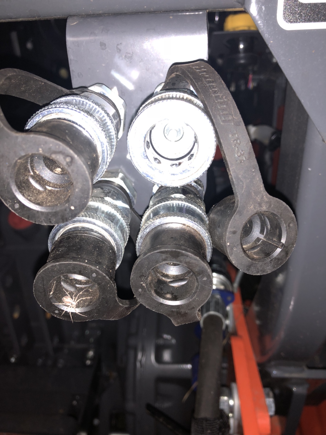

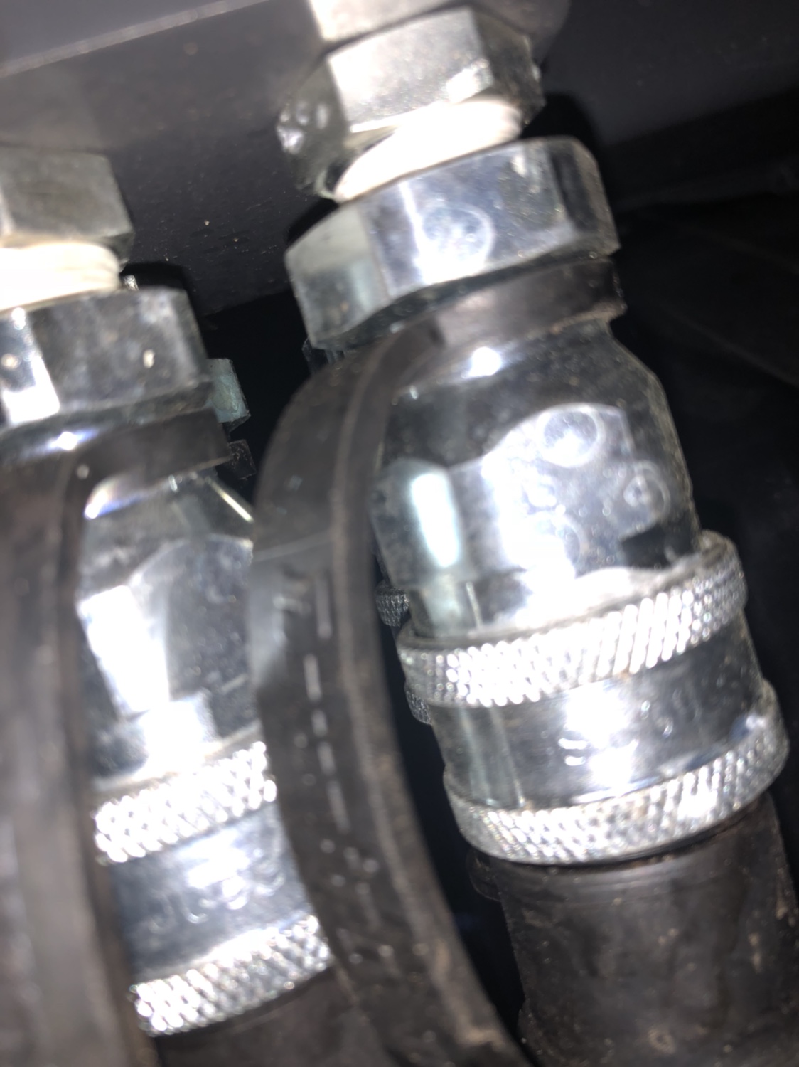

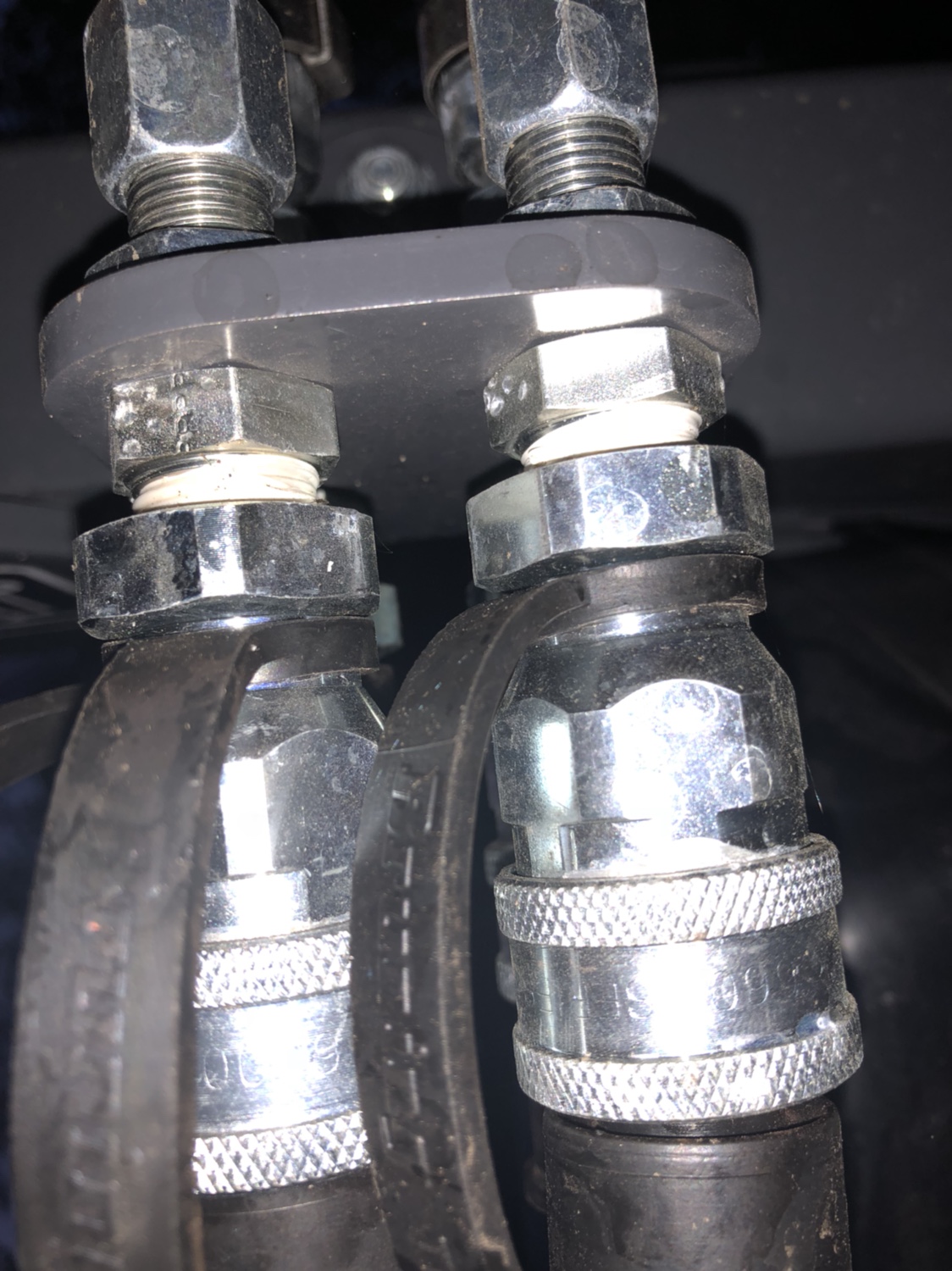

Thanks. Between the backhoe, loader, rear remotes and 3rd function they all appear to be different sizes or types
Here are a few photos of the rear remotes

Should be the the 3/8" size. So an ISO 7241-1 series A. The end of this male coupler is .68" dia. So the female should measure .721 +or-. This should be what is used for the rear couplers on the L3301 & L3901. I've seen both sizes on the L4701. Hope this can get you going. ;)

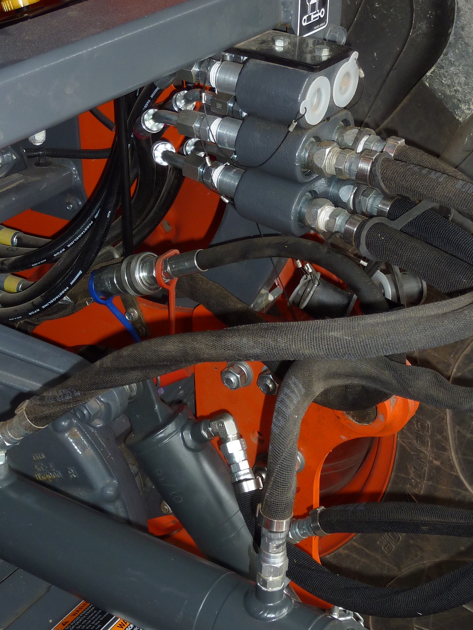

The rear remotes on my MX5800 look like this:
In fact, the remotes on all 6 Kubotas I've owned are this type. I believe they are 1/2" pioneer style.
I never realized Kubota supplied more than one type of connector on their remotes.

I confirmed mine are 3/8. Thanks everyone for your help on order from Messick

Exactly. How do you think I felt when my customer contacts me and says, "What's up with the couplers?" He had the 3/8" couplers and up till that point in time, every MX had had the 1/2" couplers like yours.
Now the B series has both types, the L4701 has both types as do the MX's. :confused2:
