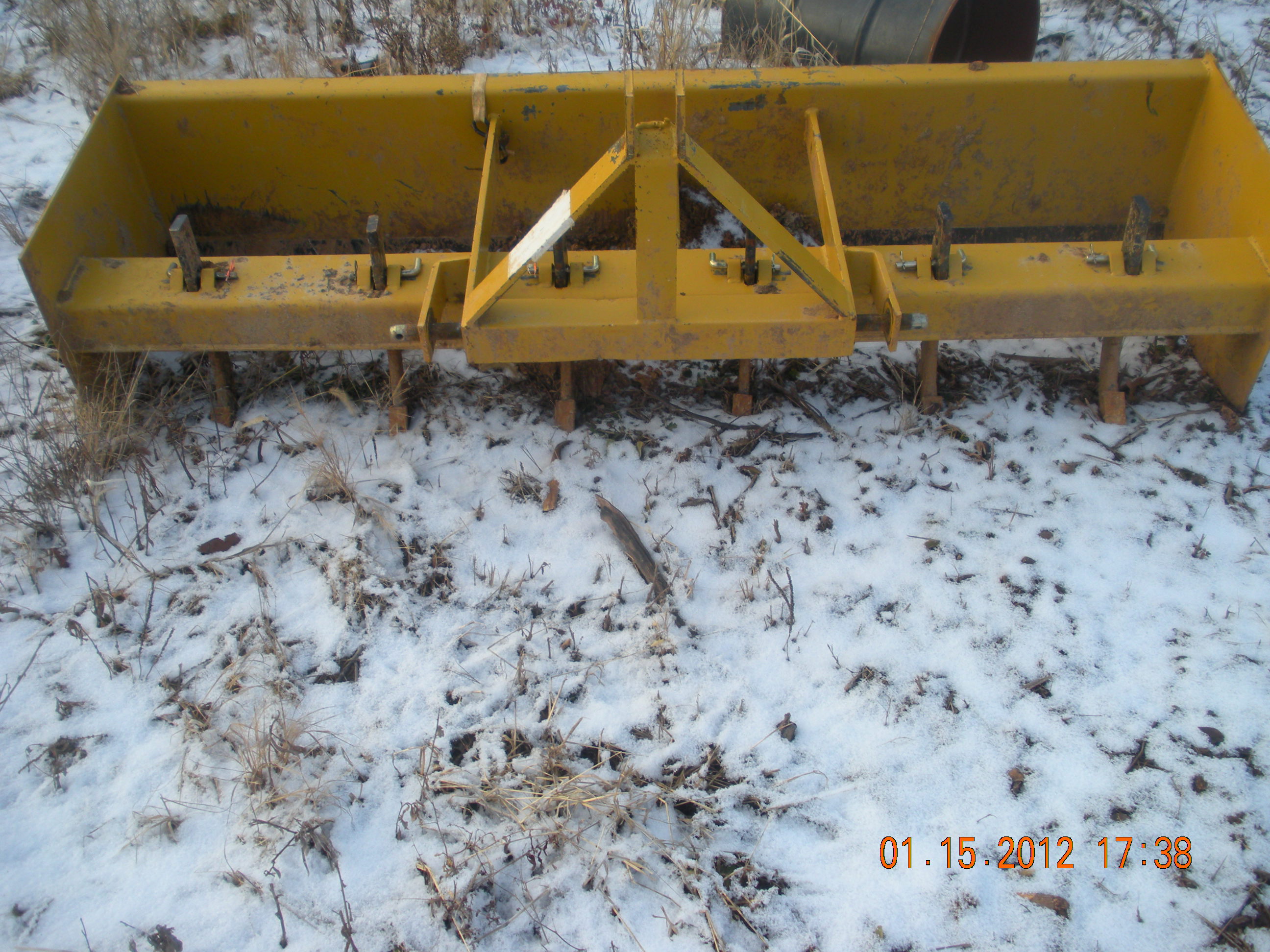

I have the 5100 and it is a great tractor for the money. I am most likely going to purchase the Bradco rock bucket after the Farm Machinery Show next week. I am going to use it without a grapple to see how well it works. At some point I may add one, but not yet. I would also be required to add additional valves to do so, but I will most likely go with the Kubota kit. That is a good looking setup you have, but I worry about exposed hoses as I have even knocked off metal lines on my L2900 in the past. It is easier than you think. Do you have a box blade with your setup? If so, which one and how do you like it? I am considering the Dirt Dog 6' rollover, the hydro ones are just too pricey.

yes i have a united h.d b.b 7' it is ok, but not heavy enough i have to put 2, 200# weights on it to dig the way i want, should have got a 8' b.b.

kuboman said:
Nice job but why did you not use the Kubota kit which has really nice neat steel lines that follow the loader arms.:confused:
I've been calling around and apparently kubota doesn't give a 3rd function as an option for the mx5100.
