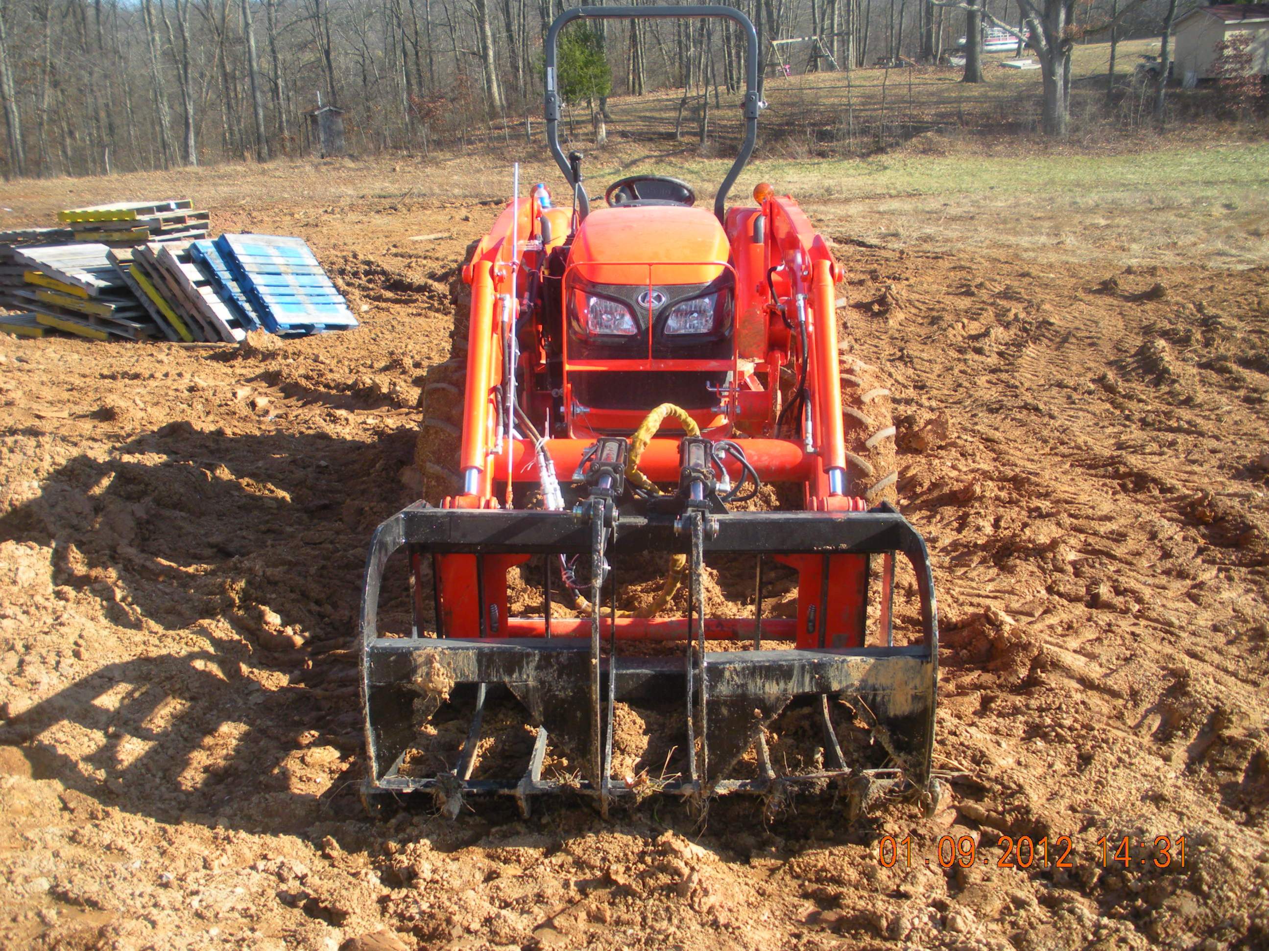

Kubota 2011 MX5100 W/la844 loader, ag/ tires loaded, Massey Ferguson 2010 GC2610 TLB w/ r4 tires, loaded, 60" Belly Mower

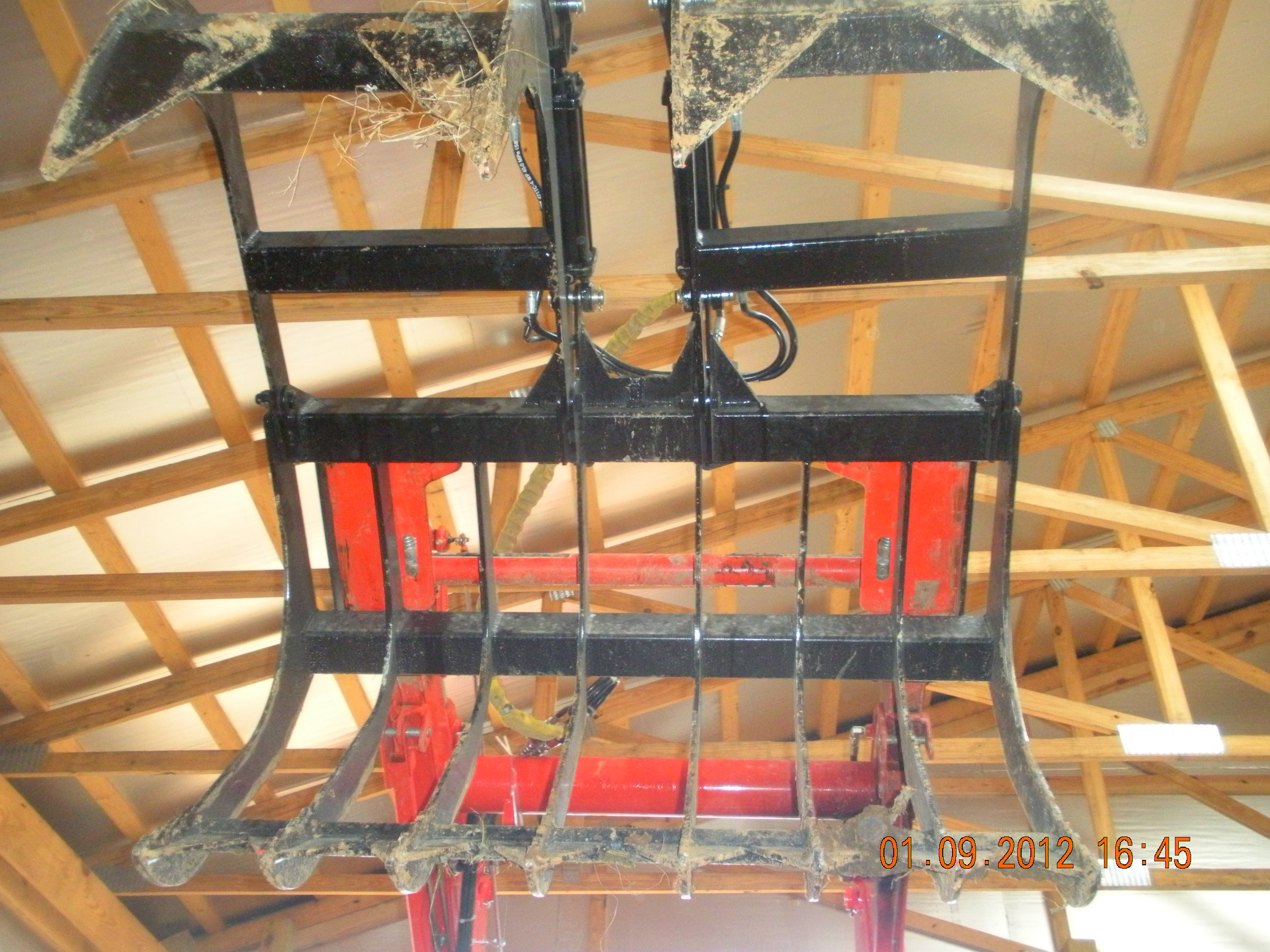

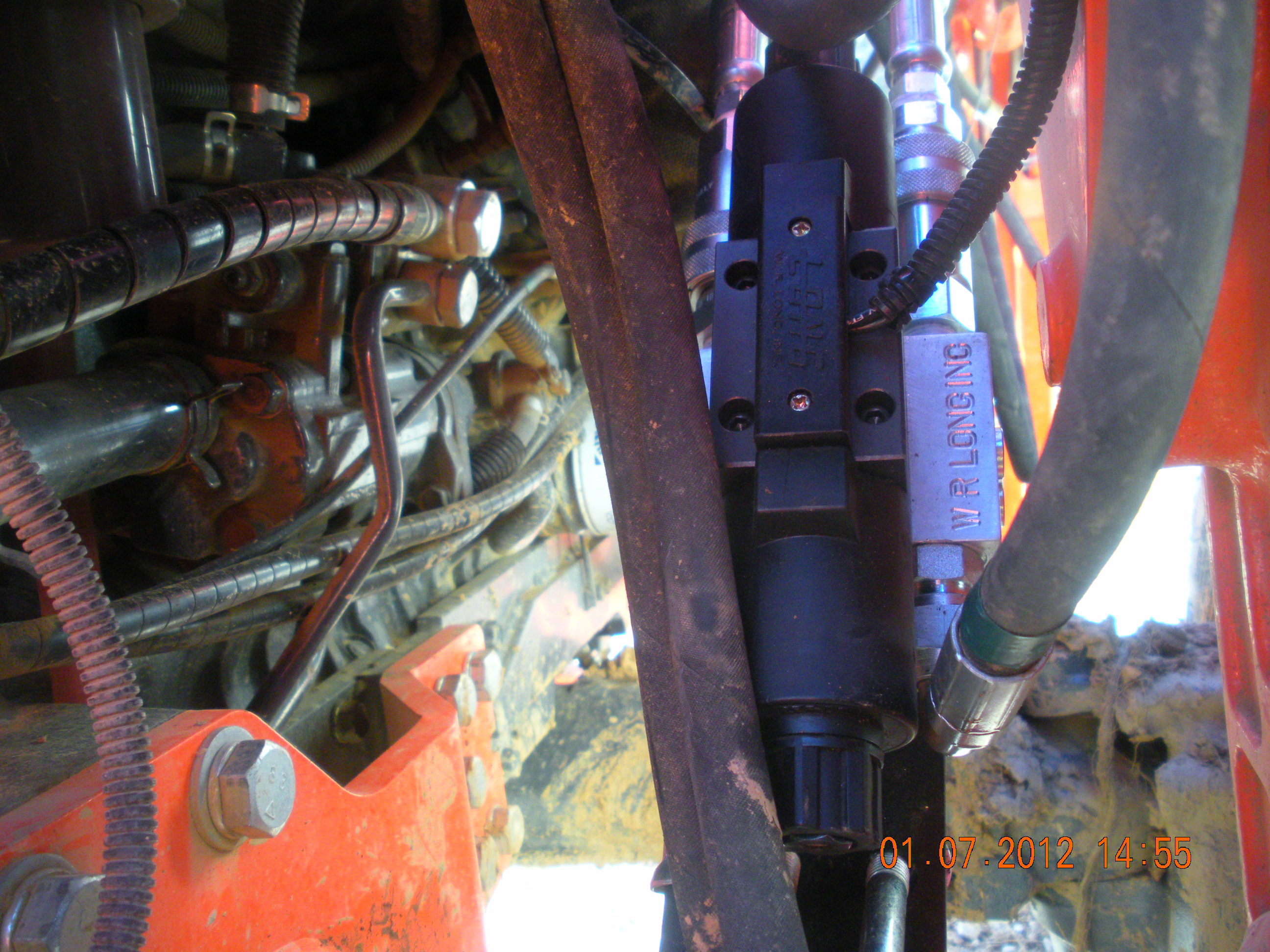

wildkat grapple 48" got the 3rd. function valve from ted installed it myself. got the grapple 3 weeks ago, man this thing is nice have moved logs, brush, rocks & can even pickup pop cans, i don`t even have to get off the tractor to pick them up.
how did i ever get along without it. / candyman

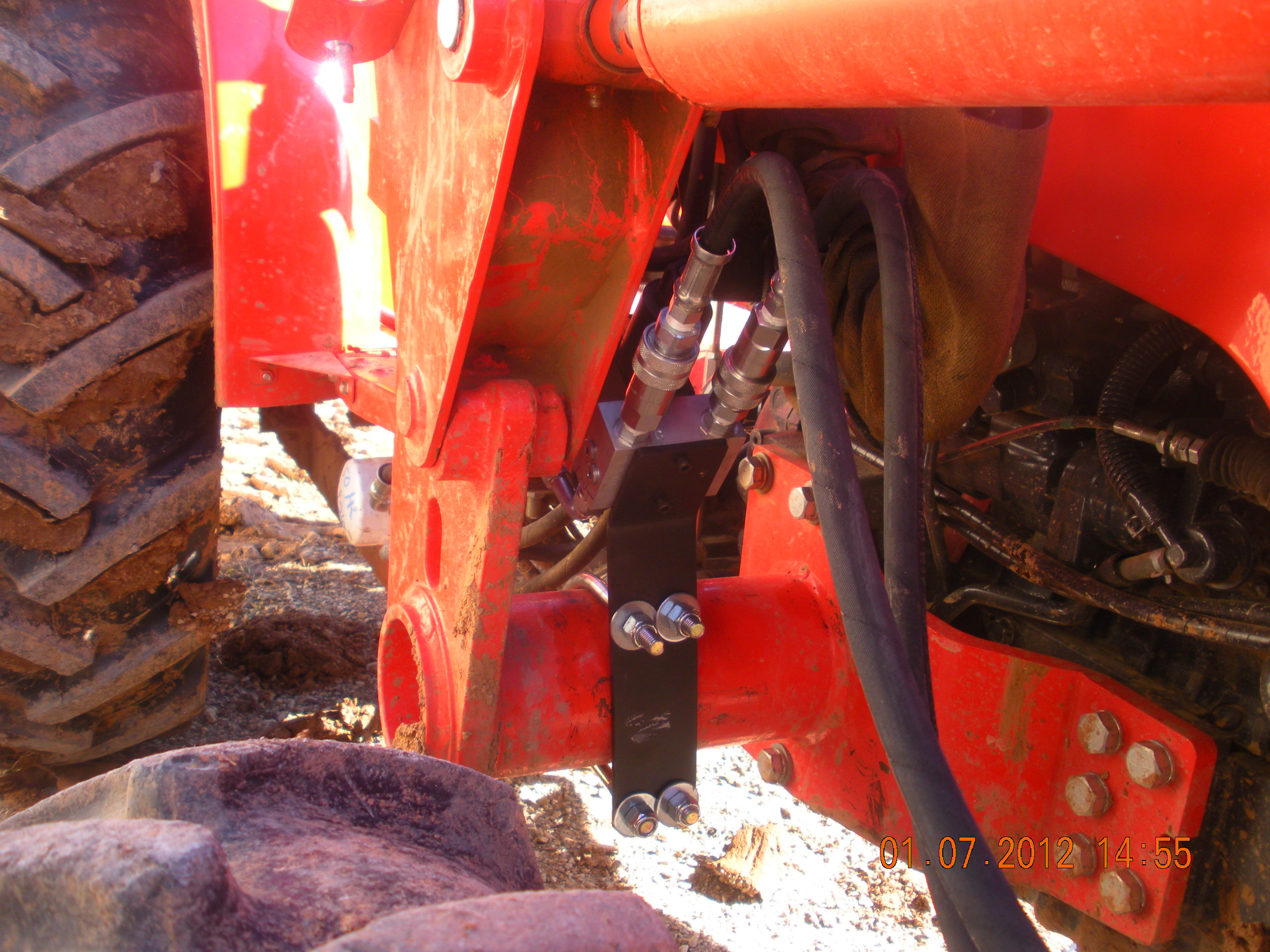

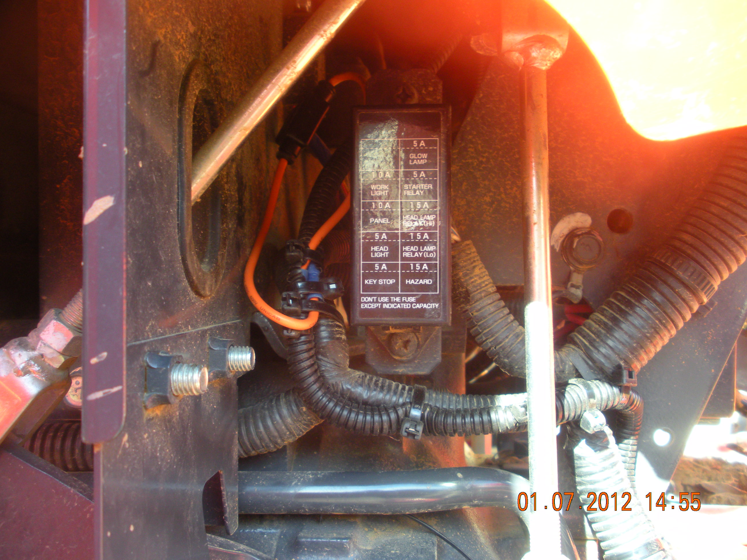

well maybe great big pop cans. not much of a picture taker. the valve was pretty easy to install, but hooking up the wiring took much longer to do.
should have taken pix as i was doing the install but as usual i forgot.
the problem i have now is how to keep the hoses from dragging on the grd. between the grapple & the tractor, need some kind of bkt. * plate to connect the hose fittings to & a way to hold up the hoses, any ideas. ??
the hoses on the valve & the grapple are way to long, had to fold the ones on the tractor over to shorten them.

Nice job but why did you not use the Kubota kit which has really nice neat steel lines that follow the loader arms.:confused:
/ mx5100 with grapple
kuboman,
did not know kubota had a kit for that guess i just got caught up in reading about the wr long kit.
the kit cost to much, but it is on now & works great.

Just curious how much your install cost?
the w r long valve complete was @ 750.00

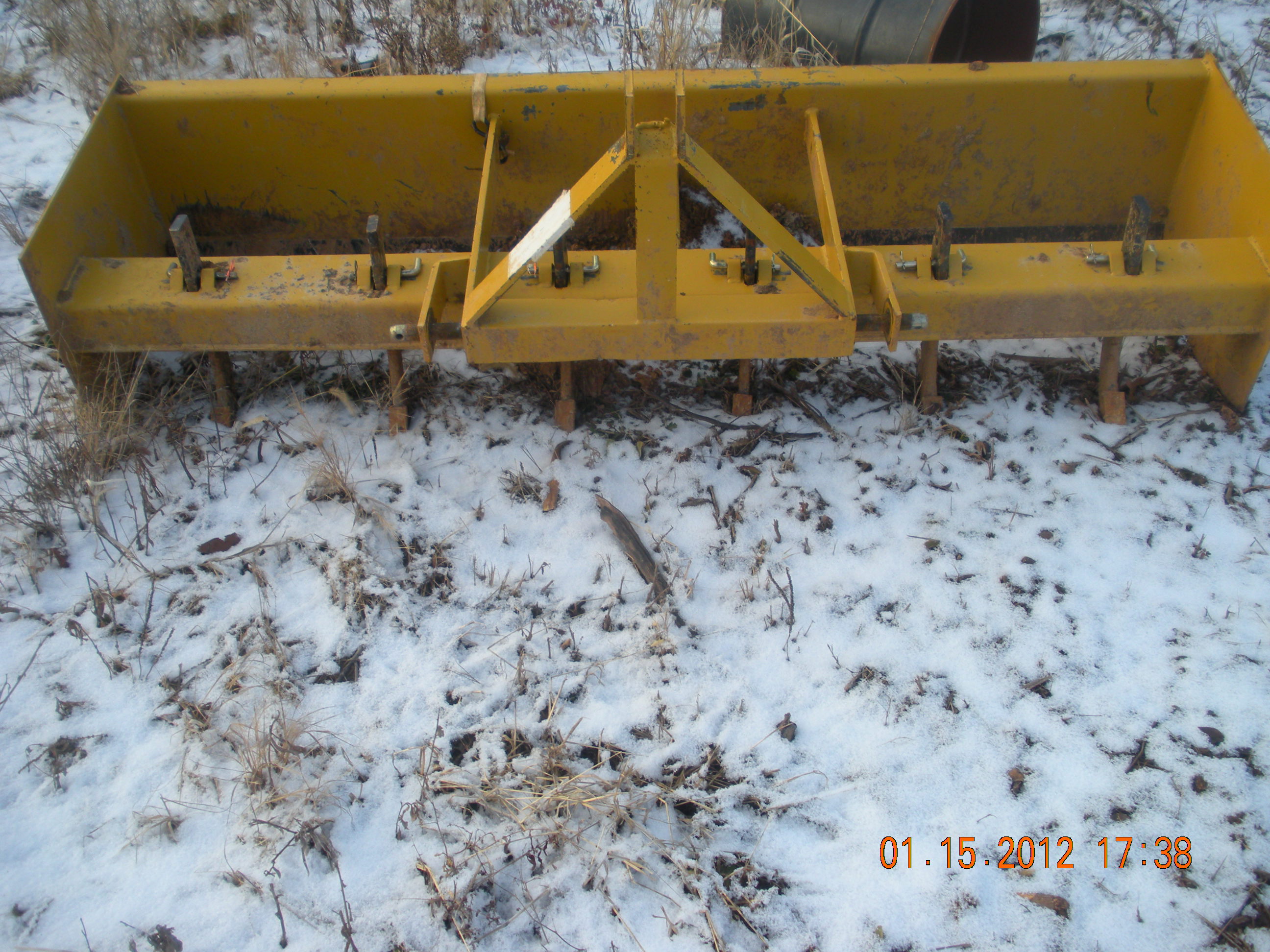

I have the 5100 and it is a great tractor for the money. I am most likely going to purchase the Bradco rock bucket after the Farm Machinery Show next week. I am going to use it without a grapple to see how well it works. At some point I may add one, but not yet. I would also be required to add additional valves to do so, but I will most likely go with the Kubota kit. That is a good looking setup you have, but I worry about exposed hoses as I have even knocked off metal lines on my L2900 in the past. It is easier than you think. Do you have a box blade with your setup? If so, which one and how do you like it? I am considering the Dirt Dog 6' rollover, the hydro ones are just too pricey.

I paid a little over $800 for the Kubota system with the steel lines to the front.:)
Was this an aftermarket addition or with the initial purchase of the tractor?
/ mx5100 with grapple #15
I purchased the kit after I had the tractor for 6 months. It is a nice neat installation which is why I went with it. I am **** enough that I hate having hoses 'hanging around'.:D

I just put a Kubota third function valve on my B25 this fall. The kit was 917.00 with pa 6% sales tax.
The install went smoothly and all mounting holes were there and all wiring was plug in. The valve is under you feet on the left side inside the frame rails. The only problem I had was my fault, I didn't tighten one fitting and lost a little oil.
I keep saying I am gonna post some pictures but haven't gotten it done.
I just figured that for the extra 175 the install would go better. I had maybe 8 hours in it.

yes i have a united h.d b.b 7' it is ok, but not heavy enough i have to put 2, 200# weights on it to dig the way i want, should have got a 8' b.b.

had to wed couple of brackets to keep rocks from fallin thru, it is awesome, how did i ever do without one. !!
