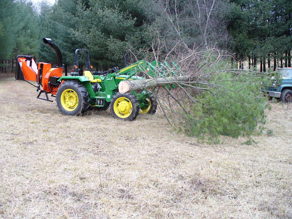

I'd go for the M5140 if you want a Kubota. Not sure if you'd consider a Deere or not, but the 5E series are a lot of tractor for the money. The only problem is they don't have a hydraulic shuttle, but otherwise something like a 5055E is going to be more capable across the board than a M5140. The loader lift capacity is huge (our 5045E will lift almost as much as our M9540) and they can pull/push a lot more due to the extra weight. With that said, there comes a point where you must balance capability with convenience, and I'm not sure the non-hydro shuttle trans would be well suited to all-day grapple work (or more like your clutch leg might not be, lol). Either way, buy the most size/weight and loader capacity you can afford.
The new 5E series is available with hydro shuttle as well as cab :thumbsup:
