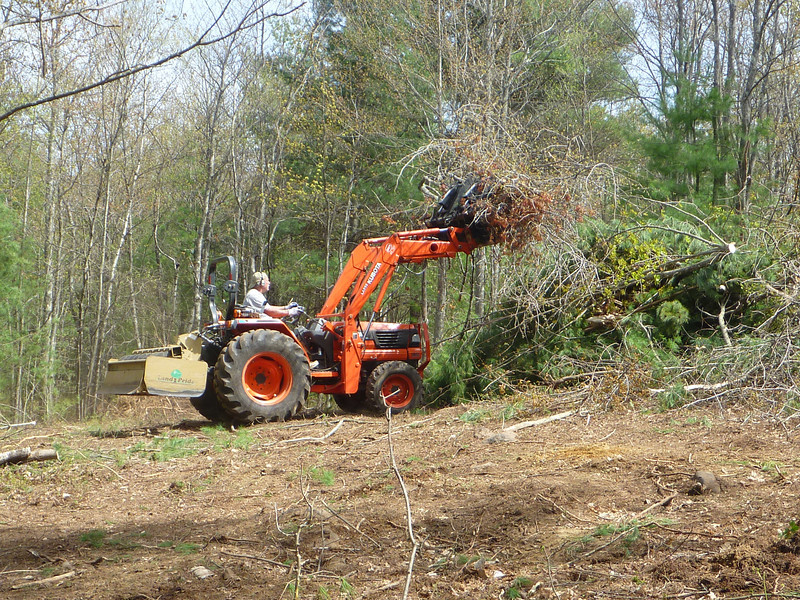

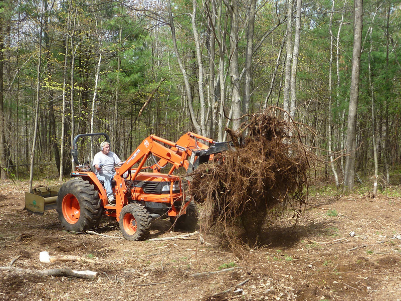

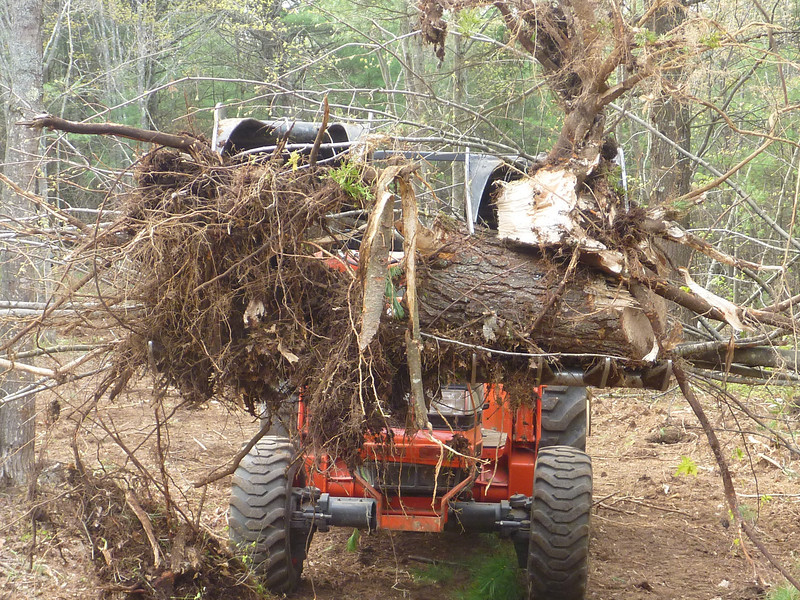

Here is my land clearing setup... I wouldn't hesitate to go with hydro shuttle now, whereas I was "scared" to before. (Dad's running the tractor)

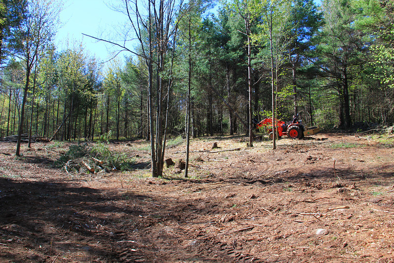

In this last pic, you can see how thick the trees are in the background, behind the clearing. This is how thick the entire clearing was. I cleared this spot in 3 days of work using this setup. There were a few trees I couldn't push over that required sawing, but a larger tractor would have gotten them ;)

Impressive pictures. Nice work.
