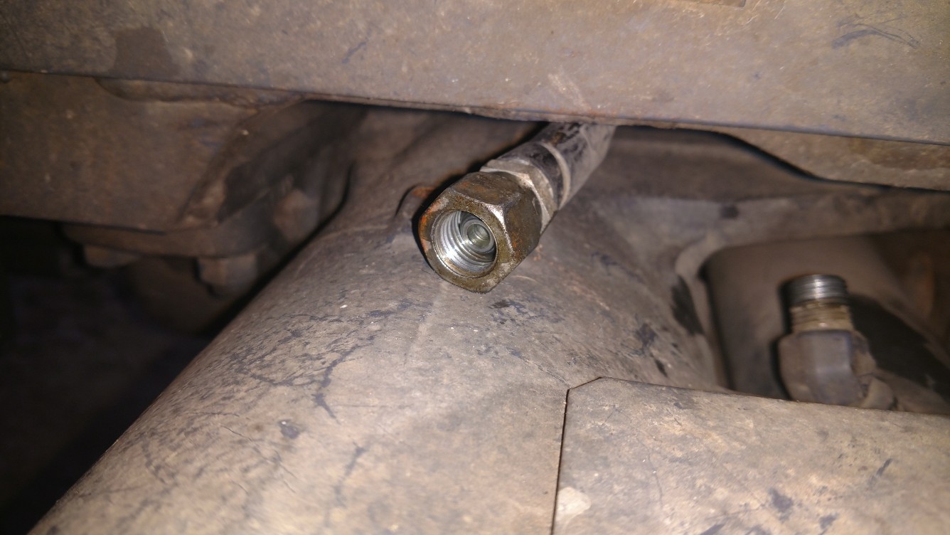

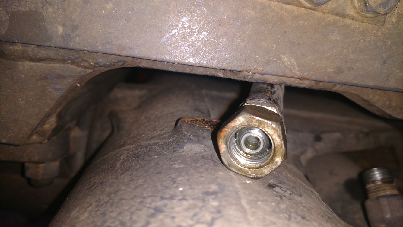

Need the assistance of the TBN brain trust.
Got a weeping hose on my mx5100. Weeping several places through the hose.
The hose ends are labeled SF-PF-04-14.
Googling seems to lead me to "parallel pipe female thread union" as the type.
They have a 30 degree inverted flare. Is this just another fancy name for NPSM?
Here are some pics
I have some 1/4" NPSM adapters and they seem like the right fittings. They thread on and tighten down sufficiently (no longer swivel). Hex size for the wrench is different but who cares.
The two hoses are listed under different part numbers, but have the same ends. Nearest I can tell is there is only maybe 1" difference in length.
Messicks prices are $86 and $113 each. Seems a bit steep for a simple 60" long 1/4" hydraulic hose with NPSM ends. Which I can make for $20 or less a price if they are indeed NPSM.

I would suspect they JIS 30 degree seat metric thread.
This is a common Japanese connection

Yes there is a JIS 30 degree inverted flare. The M14 x 1.5 is very similar to 1/4" NPSM. I believe discount hydraulic hose website has a link for identifying threads.
/ Mx5100 power steering hoses. What fitting type?
The major diameter of the threads were 0.520, which closer matches the 1/4" NPSM than a 14x1.5.
Not saying it ain't metric and JIS inverted. But the 1/4" NPSM threaded right on just like the hose end and locked down tight with no signs of stripping like it were slightly wrong.

Can you hold the male hose end next to the NPSM fitting to see if the threads are the same pitch?
Metric is 16.9 threads/ inch
NPSM is 18 threads / inch
Close enough it may or may not matter.
Possible the JIS has been phased out. Used to be common 10 years ago.

I think 1/4-18npsm is what it is. Here is a fitting vs the hose
Fittings go on and tighten properly. So that's what I'll use and I am confident it isn't gonna leak.

Just an update, installed hoses with NPSM ends. No issues and no leaks. Everthing tightened down as it should
