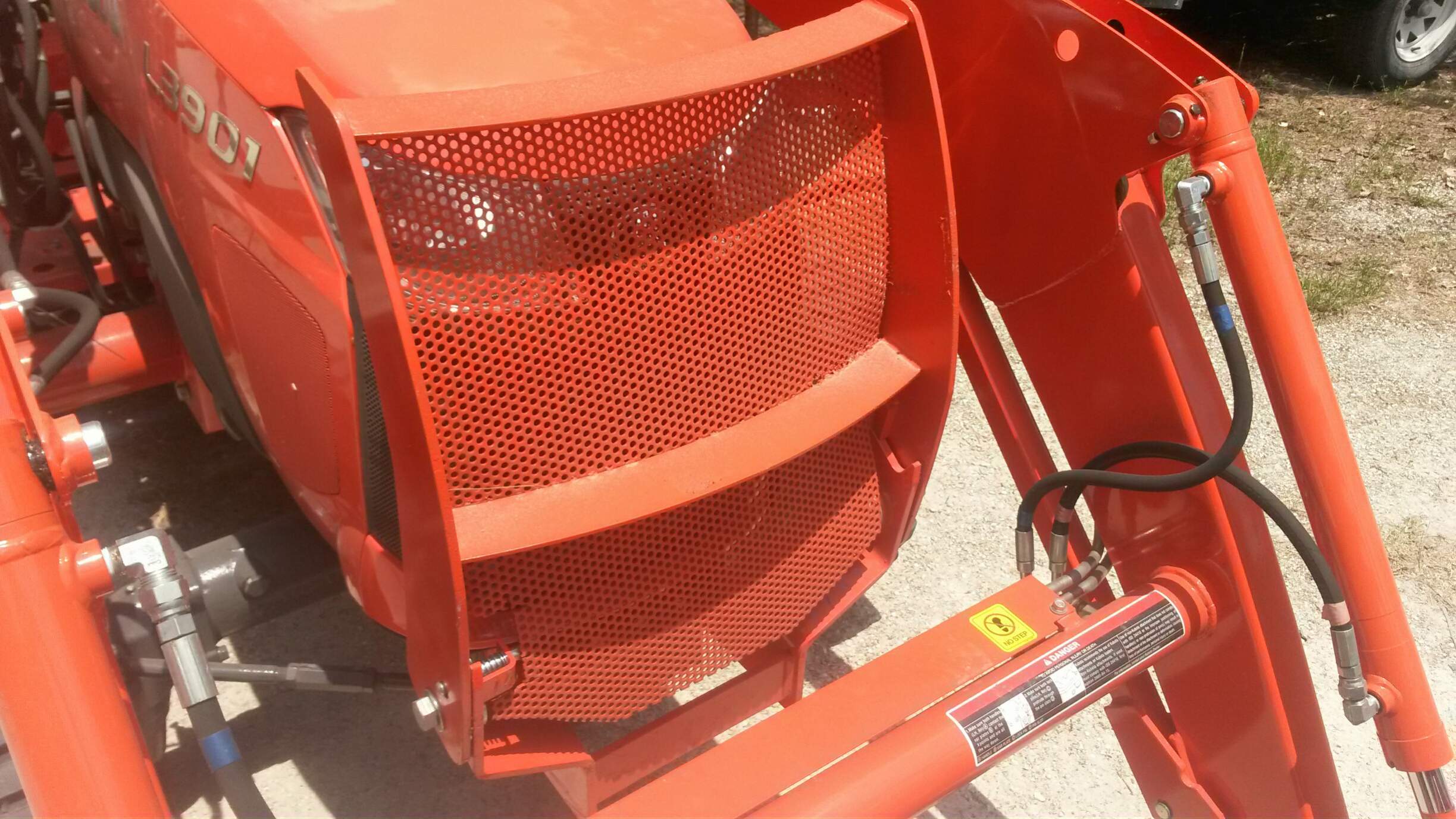

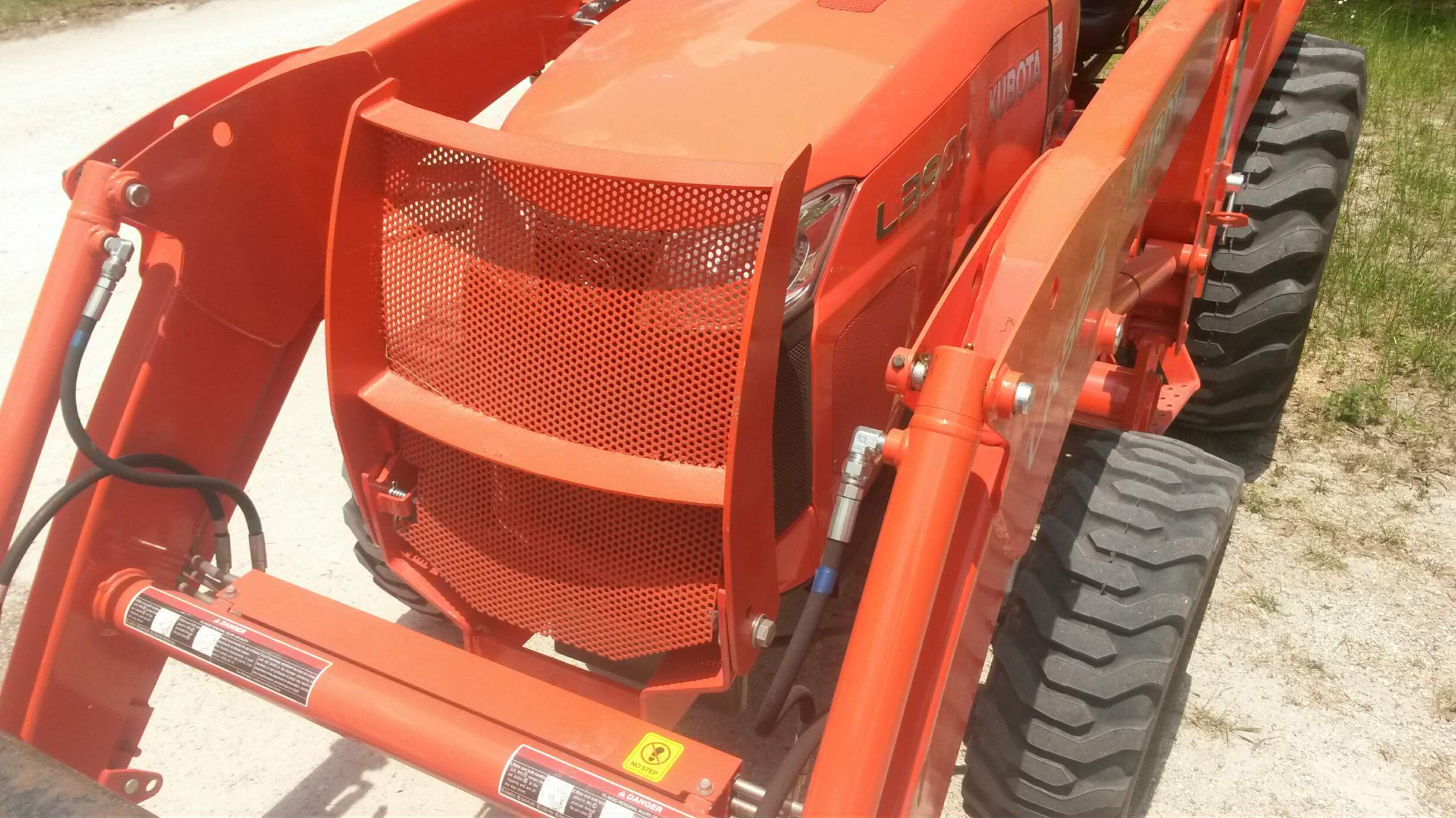

Yeah, that's Concord NC, not NH...I believe it is pronounced different up your way too.;)
Yes, it has full functionality. If you look close, there's a horizontal break where the hinge point is.

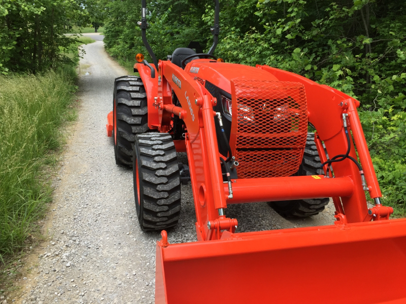

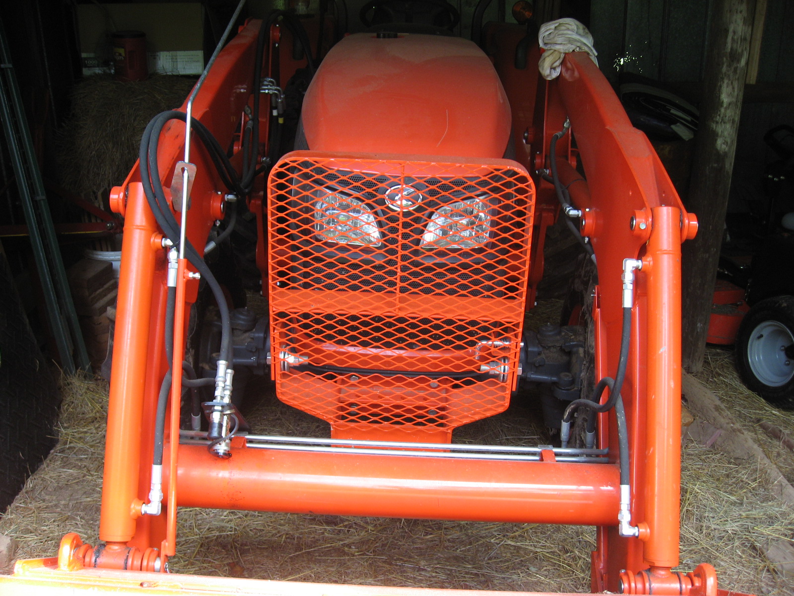

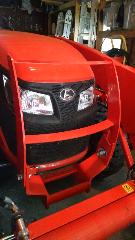

Here's mine. Simple and effective. It allows the guard to articulate and doesn't obstruct head lighting.

   / MX brush guard #25
Very nice. What model tractor is that??
Welcome to TBN.
   / MX brush guard #26
Very nice. What model tractor is that?? Welcome to TBN.
Thanks! It's an MX5200 HST. I've had it for 2 weeks and it's got 12.5 hrs.
I love it! First tractor ever and I never knew having one would be so enjoyable.....now where is the money for all the attachments gonna come from????

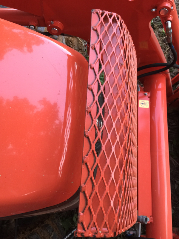

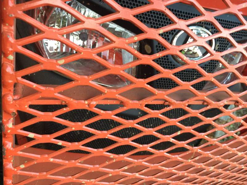

I know the feeling $$$! If you get a chance, can you take a closeup of the welds?
   / MX brush guard #28
Here you go. It's tacked on the outside. It's more sturdy than it looks. I've spent several hours mowing small trees down. It took several blows and jabs and has done well.
Great, thanks! Did you do the welding? How dis you get so much weld on the sides without destroying the mesh? I think I'll only be able to do small tack welds.
   / MX brush guard #30
I wish I could weld that well. Actually the dealer did it. I had him throw that in the deal along with 3 bucket hooks on the loader bucket.
It turned out better than I expected. He warned me beforehand they were no machine shop. Much better than I could do.

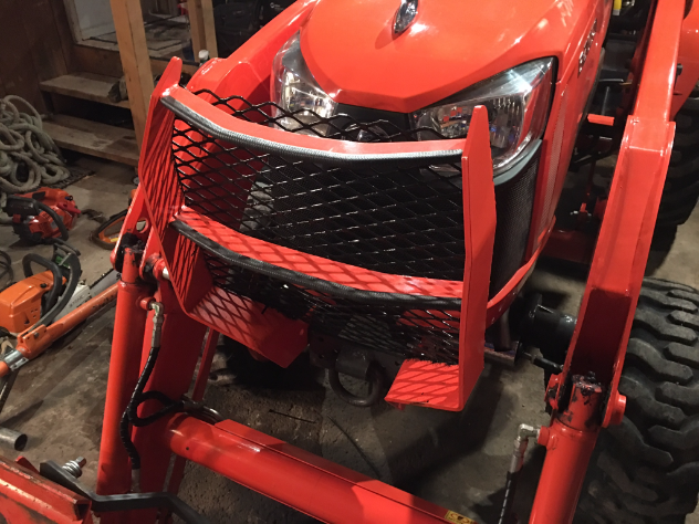

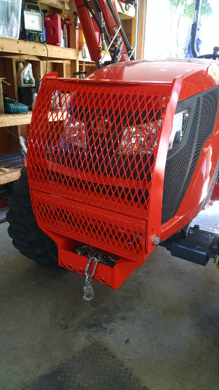

So I finished the guard reinforcement. Thanks for all the tips and pics. You can see where I had already cracked the plastic screen.
I added some angle iron reinforcement. Used #9 3/4" expanded metal. Made a little basket to hold chains at the bottom.
   / MX brush guard #34
So I finished the guard reinforcement. Thanks for all the tips and pics. You can see where I had already cracked the plastic screen. I added some angle iron reinforcement. Used #9 3/4" expanded metal. Made a little basket to hold chains at the bottom."
That's a fine looking job there. The chain basket is a really nice touch!

That chain basket is a real nice addition!
   / MX brush guard
#38
Thanks! Chain still lives in there. Crazy how often 10' of chain is useful. :confused3:
   / MX brush guard #39
Yep, I carry at least two chains of various lengths on each tractor.
