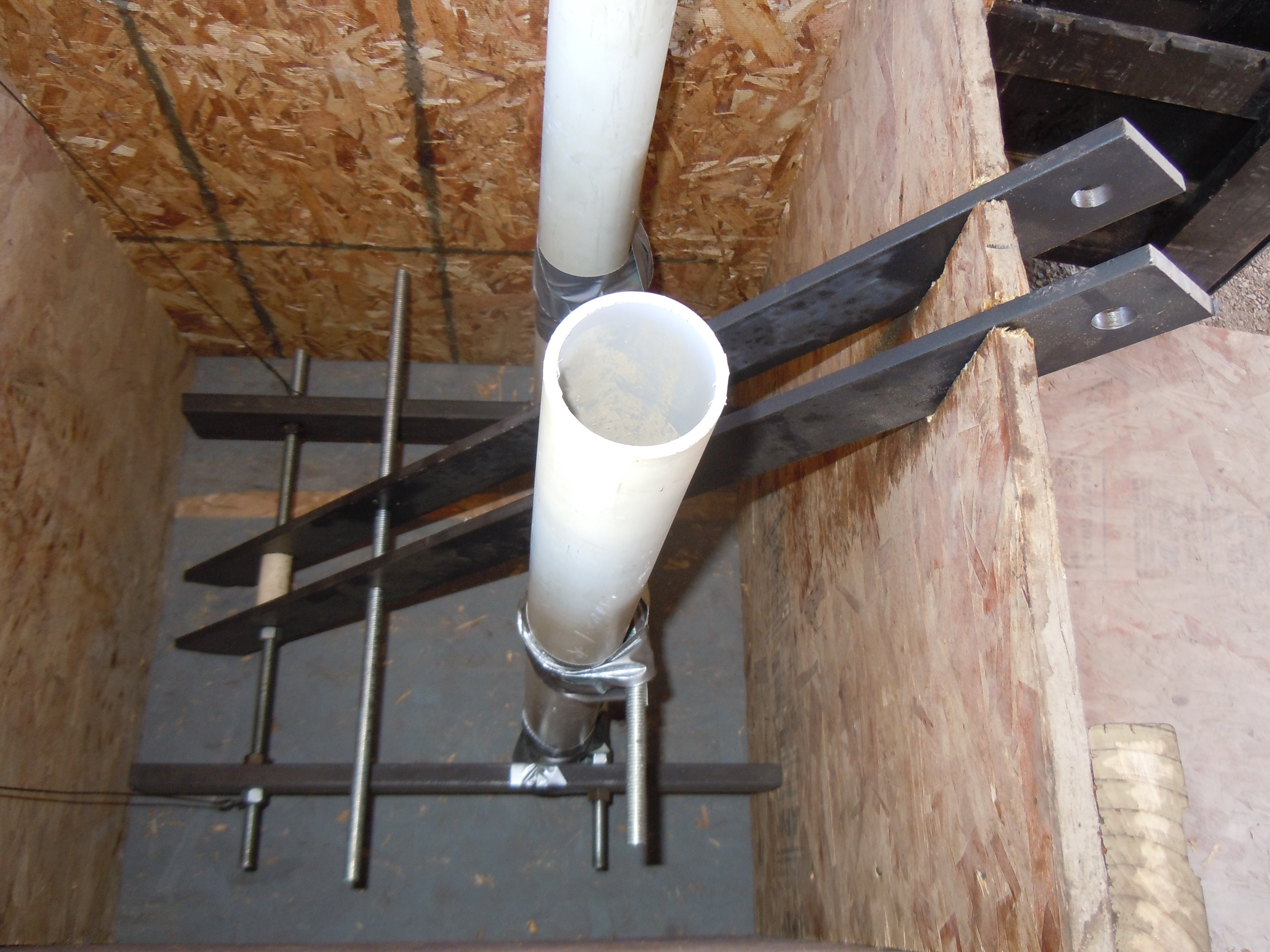

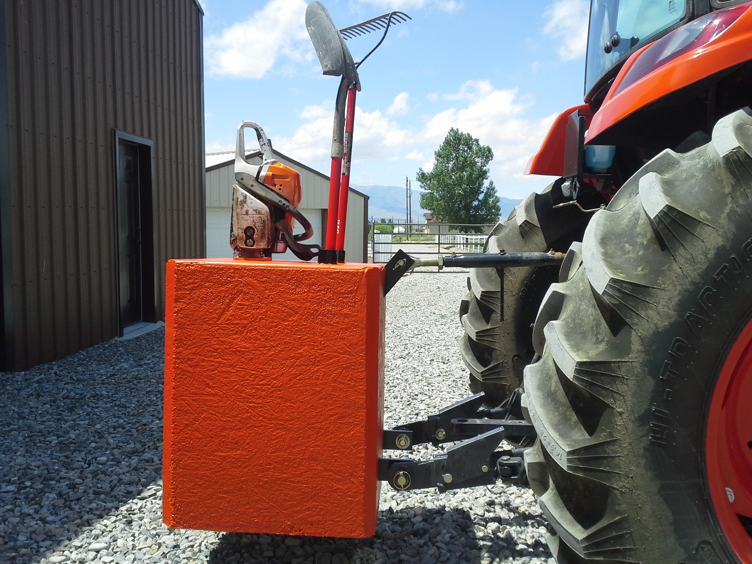

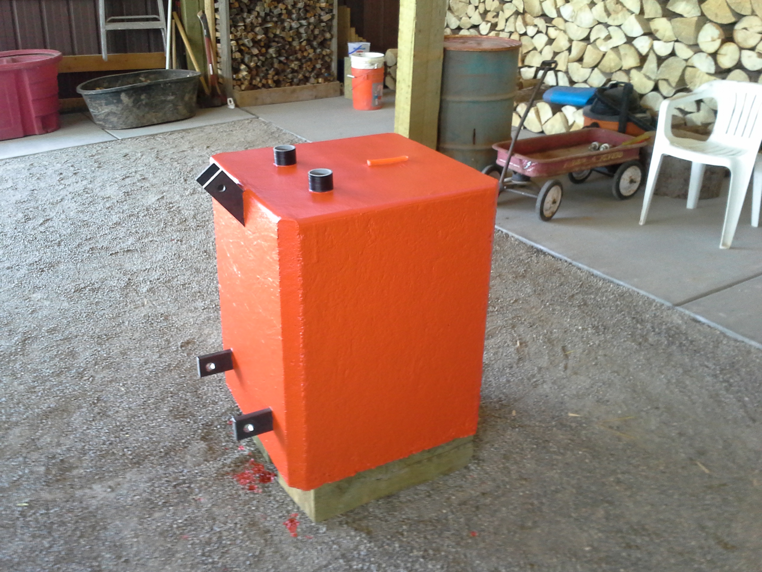

If you have some scrap wood laying around make your own. I built this one, 1700 pounds, the tractor is much more stable with it on. No welding just drilled and bolted.

Cat Fever, if you don't mind can you give please give me the approximate dimension of your ballast box? Also how far apart are the lower metal steel pieces without the lift pins? Thank you in advance. Stanley.
   / MX 3pt ballast? #24
I'm going off memory here, the ballast box is not at my house to measure it.
2'X2'X30" tall, the bottom steel is about a foot wide. If I had it to do over I would lay it on it's side (lower center of gravity) and spread the lift pins about 4 more inches.
   / MX 3pt ballast? #25
Thank you very much, Stanley

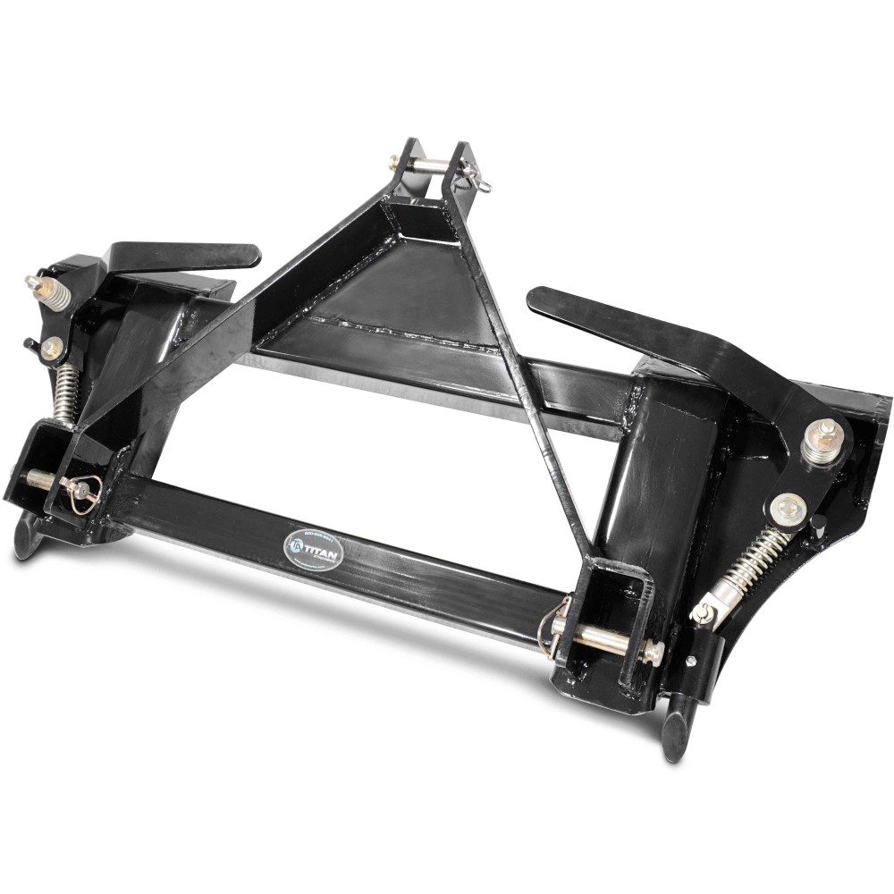

I occasionally use this 3 pt to SSQA adapter to put my pallet forks or an old FEL bucket on the rear of my MX5800 for ballast:
Titan Attachments 3 Point to Universal Quick Tach Adapter Skid Steer Tractor
It's on sale at Titan for $302
With the FEL bucket on the rear, I can back into a gravel pile and use the hydraulic top link to scoop up as much weight as I need. Otherwise, I use the forks and load weight on a pallet. The nice thing about the adapter is you can use the FEL forks or any other SSQA attachment. You don't have to buy special 3 pt attachments.
