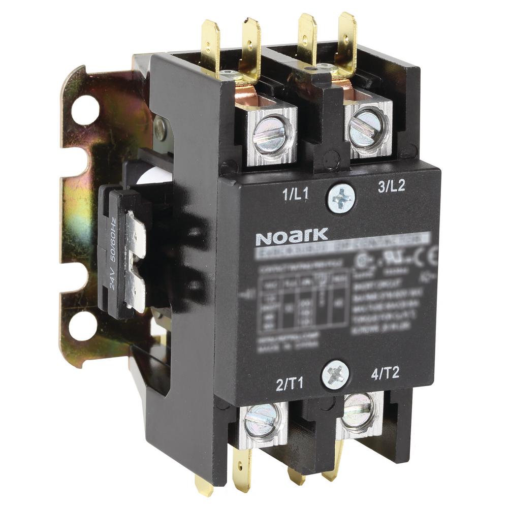

A guy could use this 2-pole contactor. >$15 https://www.homedepot.com/p/Noark-4...ERCH=REC-_-pipsem-_-300813253-_-300812706-_-N

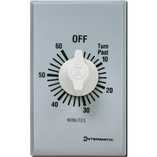

Use this to time the contactor's coil. Rated for 220v at higher amps that required for the contactor. <$30 FF6MC - Intermatic - Commercial Spring Wound In-Wall Timer Switch | 1Bulbs.com
data
Hooking these up is as intuitive and as simple as it looks. Neutral and ground wires are not switched with a 2-pole switch setup.

That's what I have ... crank it past 10 or 15 and I'm usually good for most of what I do. Mine's only 110 though.

I like the contactor Idea Richard has, I have always been around compressors wire hot 24/7. In my new shop I have been thinking about a way to shut it off, the compressor is outside the shop area in my cold storage area and with two walk in doors it was going to be a lot more wiring but my lights are all wired with three way switches so all I will need to do is tap into one of the light fixtures closets to the compressor wiring.
Yep, just have to get the DPST version.
That's a new one me too. So can you explain the crank timer a little more? I manually select a time period or program it or what? Thanks!!!
This is the one that I ordered: https://www.amazon.com/Intermatic-FF12HHC-Timer-Brushed-Finish/dp/B000LDEO26/
12 hour time limit, crank to set how long you will be in the shop, switches both hot lines.
