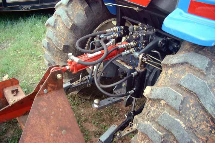

I have both a box and a bush hog - I find myself changing back-and-forth quite a bit. The top link needs to be reset every time - and getting the top link set "just right" for the box blade can sometimes be a pain... a little adjustment can take you from skipping over the dirt to digging to China... How does everyone else do it? Do you have multiple toplinks - one for each piece of 3ph equipment that needs one?

Yes. I have a dedicated top link and linch pins on every 3ph attachment. It's money well spent. I also have a dedicated hitch pin for each wagon that stays with the wagon when it's unhooked. Plus I keep spare hitch pins and linch pins on each tractor. TSC is a good source.

Two words: hydraulic toplink. /forums/images/graemlins/wink.gif See the attachment. /forums/images/graemlins/grin.gif

Jim has already said it. Hydraulic Top Link.
I have 3 top links besides the Hydraulic.
I find it easier to just use a dedicated preset top link for the Rotary Cutter, Landscape Rake, and weight box.

Doug, Jim and the others are steering you right on the hydraulic top link it will save you a lot of time and it makes any box-blade a whole lot easier to use.
I have found out however that when I need to use my backhoe the stock top link must be used in conjunction with the backhoe. It's about the only application where a hydraulic top link can't be used, at least on my Class III Boomer anyway. Fortunately removing the hydraulic top link is a 1 minute job and requires no tools.
