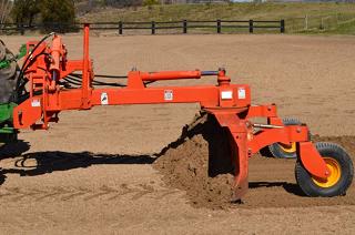

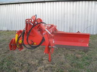

/ Multi purpose tractor #13
I think you're under estimating your requirements @c.50hp. I know the Delegate area well & 2500acres is a reasonable size to need & well justify something bigger, particularly if you're maintaining c.5Kms of roads + considering slashing, clearing, building/site/remedial earthworks (e.g levelling, drainage, gabions), stump removal..etc:-
1.Grading 5kms of roads, maintenance & associated rebuilding/remediation work is hard on any gear, lighter blades will do it but you will constantly have hassles(i.e. trashed in c. 2-3yr & ongoing breakages in the headstock/frame), whilst Berends are ok even their heavy duty gear is too light for this sustained usage (below are photo's of the Challenge units we run for similar use, they've proven to go the "distance" & a worthwhile investment if it's to be a year in year out task...all hyd 3m 950kgs CatII/III req 70-170hp c$10k have replaced the motor grader we used to run).
2.FEL f/w a 4/1 if that's what you set on, also consider an attachment blade/root rake combo (maybe +angle/tilt) for clearing/road application & possibly a set of forks (for pallets, hay, fertiliser bags..etc) - for lifting capacity/frame strength also consider manufacturers like Burder, Nell & Challenge against the FEL's offered by the Tractor manufacturers
3.Post Hole Diggers - for 2500acres don't make a mistake by going with a PTO unit, a hyd auger drive unit is far superior & fit it with a quick hitch* to your FEL (the reverse function & variable speed drive makes them a better option than PTO ), & if you have many KMS of fencing to replace soon a commercial driver will pay for itself (not cheap though)
4. Slasher of sayc.2m+ is going to task less than a c.70hp tractor in heavy conditions
5. 10-20 acres of cultivation is neither here nor there, but it's hard to justify buying specific use gear for this size.
IMO two S/H well maintained units offer the value equation on a limited hour farming operation, rather than new as there are bargains out there :-
i). c.75-100hp 4wd Tractor f.w A/C & FEL @c.$40k (e.g Deutz DX4.30,Ford7840, Landini90, Kubota M100, M8540, JD5520, Case JX1080U @less than c.3500hrs which is est.half life)
ii) +a Skid Steer (i.e "Bobcat" type) machine which gives you the 4/1 & its functionality for road/farm/earthmoving/building with an industrial backhoe attachment(most robust than the 3PL/frame mounted ag units) @ c.$20k all up (believe me a skid steer will pay for itself many times over on earthmoving/farm tasks & fitted with the hyd post digger is all you need for fencing) vs an Ag tractor with a backhoe atttrachment (apart from the strength/durability/performance issues mentioned on my previous post changing a frame mounted or 3PL backhoe is a time consuming pain....no commercial farming operation runs them for these reasons). Or go down the s/h industrial backhoe path for c.$20k if you must, but understand backhoes have largely been superceded by excavators & are far more difficult offload (than excavators or skid steers..)
With 2500acres or c.10kms2 you also need to consider the practicalities of moving gravel/fill/materials/fodder around the property, one FEL Ag tractor (especially f/w a frame mounted backhoe) is going to make the use/loading of a trailer a protracted exercise., &.unnecessary repetitive exercises quickly turn many tasks into tedious chores on farms....

/ Multi purpose tractor #17
Yes, self contained motor graders are in theory the "best" for roadwork, but once you work out cost/hr, capital replacement & maintenance , & then factor in they are complex requiring a highly skilled operator to make the most of them(after 35yrs on ag/earthmoving gear I still can't operate one anywhere near as well as I'd like), they sit in the shed most of the year, are very task specifc (fine grading/levelling rather than generally clearing/earthworks), & it's another large motor/set of batteries to maintain .....etc. @ $40k+ for anything decent it makes an expense limited use "toy" for our farms....we used to run Cat !2's & DRMCO's which are fairly large/robust machines & budgeted on 400hrs/yr across our farms, on average they cost c.$10k+/yr in repairs+ fuel+service/maintenance so it was well in excess of c.$100+/hr to operate + the wage of an operator + capital/replacement cost - no longer in my view viable equipment to own.
The two Challenge blades pictured are GT-300PH models (you may want to go smaller due to your road width/tractor size) almost identical, 3m width 70cm blade height hyd offet/angle/tilt, the only difference is one has hyd controlled depth wheels (whereas it's manual adjustment on the other unit, the hyd feature is nice for quick adjustment but largely unnecessary). These blades on a c.90hp tractor will do c.85%+ of what a motor grader will do, depending on the task they'll just take around c.30-40% longer to do it.....ultimately the capability of a grader it largely determined by the skill of the operator (& any fine grading task takes time to master, the key is to take it slow with small grades & multiple passes keeping the material "flowing" until you become more skilled, going too deep/too fast is damaging to equipment & leads to a poor result)......... once graded a few times, & after a few seasons depending on the condition of your roads it may be advantageous to use contractor with a compacting roller, or you may want to invest in a towable smooth or sheepsfoot roller@c.$3K (compacting will make roads last much longer & shed water if there suffer from bad corrugations/potholes/wet spots)... the Challenge guys are a helpful/knowledgable bunch & should be able to advise further Challenge Implements
As for skid steers, I wouldn't be without one on a farm, they're quite capable of assisting with road building (but won't replace a grader attachment) , drainage, landscaping, brush clearing, pile burning, fencing & general earthworks - equipped with a 4/1, a levelling bar, detachable backhoe & maybe a set of pallet forks I'm sure you'll find a multitude of uses. In combination with an Ag tractor FEL & using 3PL rippers you'll move a considerable amount of dirt/material.
