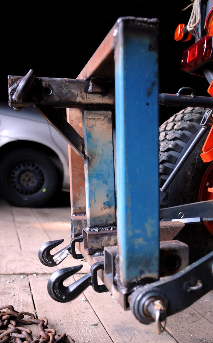

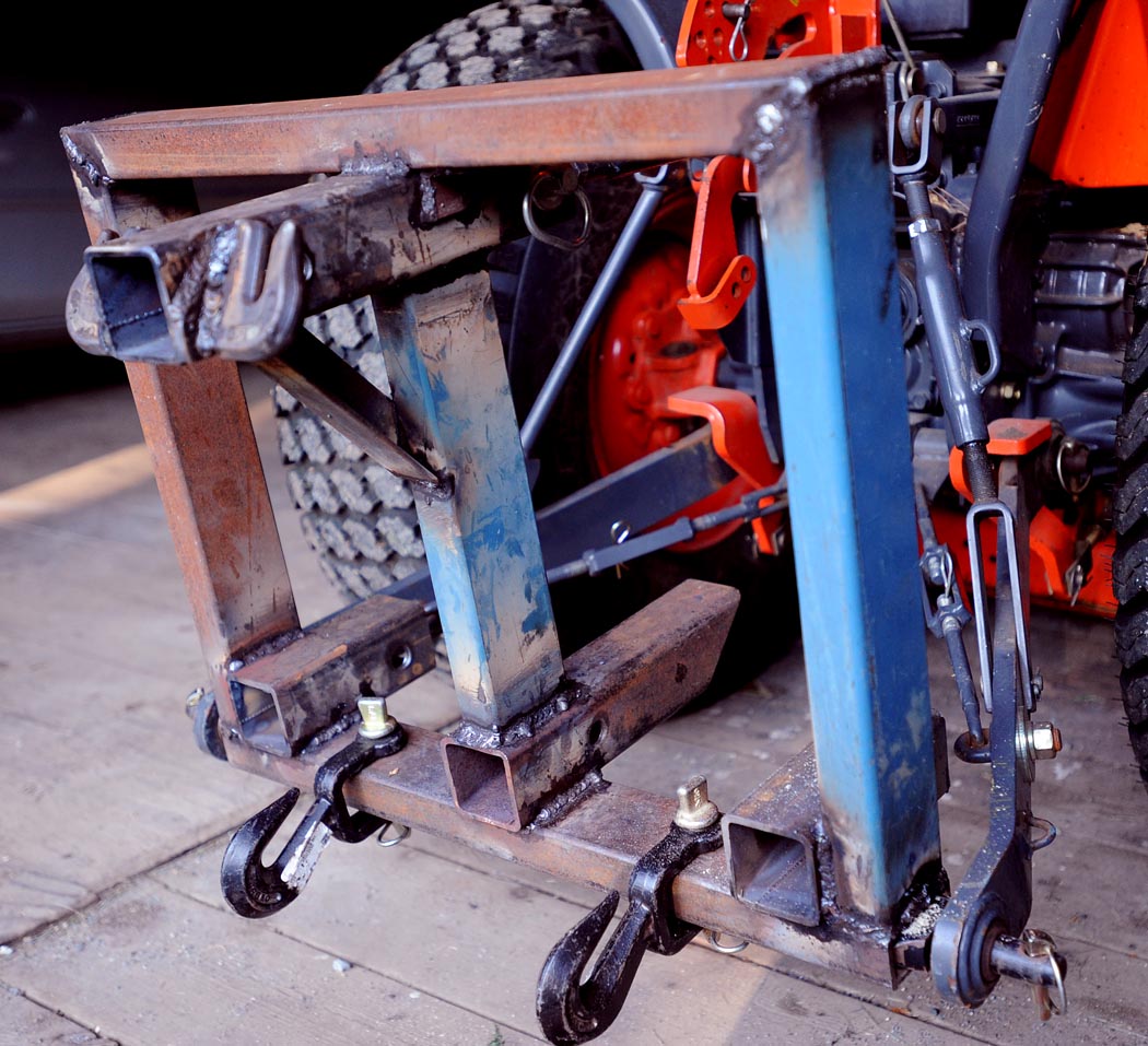

I have been thinking about fabricating something for the 3ph that would make a few thing easier in my life. So. I came up with this franken-hitch thingamabob that will allow me to do three things without having to do too much to the 3ph. The original idea was to make something that will allow me to haul a log or two and also to be able to hook up a trailer within moments.
Function #1
The two hooks on top will help to lift the log and I can just wrap the slack end of the chain back around the log and lead it to the lower hooks. That way the pulling force will come from the lower arms of the 3ph thus reducing the danger of damaging something or rolling the tractor. The lower hooks serve a double function. The pins hold the whole contraption in place on a draw-bar that is inside the bottom piece.
Function #2
I'm sure you figured that the center receiver is for a trailer hitch.
Function #3

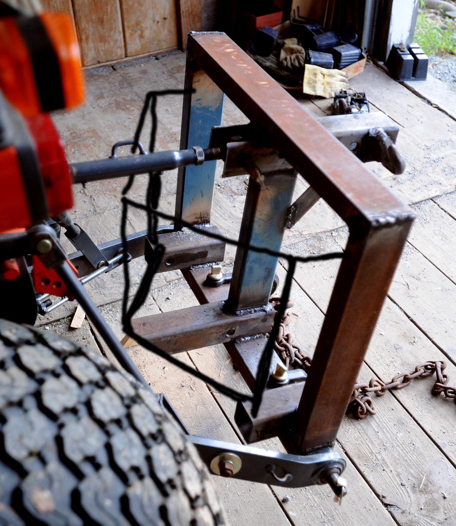

In the process I thought I might as well make it a little more complicated and use this as a weight box as well. In photo #6 you can see a crude drawing that represents a cage I will make to hold about 150# of weight. That should help with keeping the hitch down while pulling a trailer and that weight will pretty much stay there all the time. The cage will also add a bit more strength to the whole thing. I will not forget to leave room for the top link.
The two receivers in the lower corners will serve to hold the rest of the counter weight. I picked up 350# of gym weights at a yard sale for $20. That will make a handsome addition and I have an idea how to attach it to my contraption within a minute.
I expect to complete it as I have the time.
Observations and ideas are much welcomed.

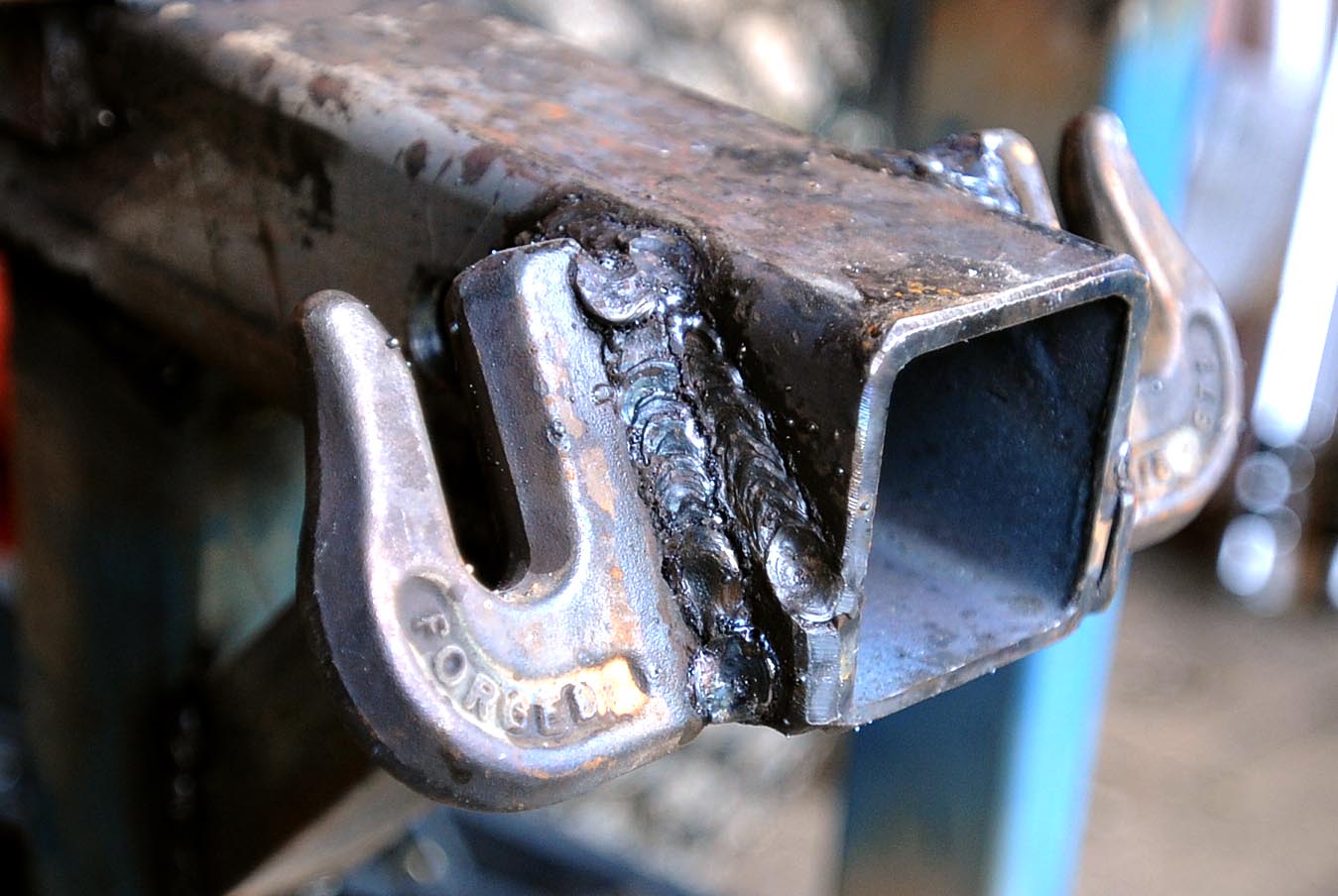

It looks big and heavy but I will only take it off the tractor for the winter when it's time for snow removal and the rear blade is needed. I also attached a picture of one of my ugly welds. I know you guys want to see that :p

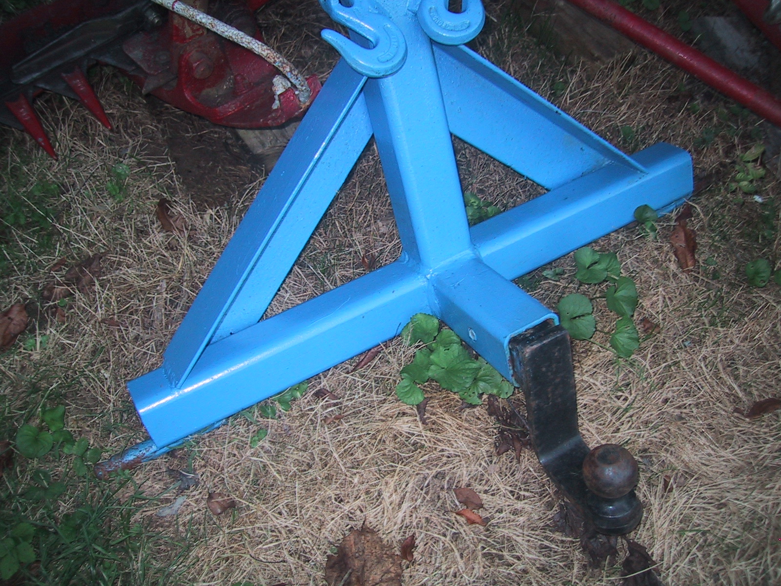

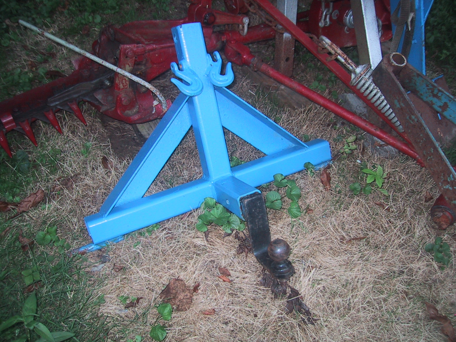

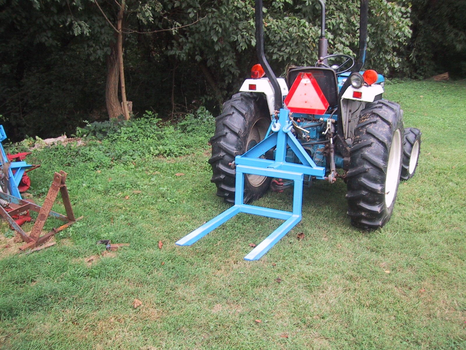

Here is my version of about the same thing. Also have a set of forks made to fit receiver will take picture and send later. So far I use to move trailers , pull post , pull logs & move small skids around.

Beauty is in the eye of the beer holder.
Looks great to me. Nice work.
/ Multi (3) function 3 PH contraption #10
Speaking of which.....That would make it more complicated!!
A flip up toilet seat would also make it much more functional and user friendly to the feminine operators. The weld looks perfectly beautiful to me since I prefer function over appearance. On the other hand, if I need to hide something that I am not proud of, I find it easy to attach something shiny ( like a fishing lure) away from the disgrace and shine multicolored blinking LEDs on that....

Here are the pictuers of forks .

I had some time over the past week and moved my little project forward. I managed to weld up the cage that holds the weights when I need a little extra. It actually worked out a little better then I thought. I was able to add about 330lbs of weight to the 3ph that includes the weight of the frame too. So I'm happy with the outcome. In the pictures there is about 190lbs of weights in there as a quick first test, but later I was able to rearrange and improve that. I also hooked a piece of birch to the thing to see how it works and I was very happy. The log was about 16' long and 17-18" diameter on thick end. I was able to lift it and pull it without effort. Needless to say the logs I will pull will be longer but seldom larger in diameter. I wanted to see if it will lift high enough. I will make the frame for the additional weights in the next few weeks. (hopefully)
Here are a few pictures of the progress.

/ Multi (3) function 3 PH contraption #13
Will not pick up a full pallet . I have picked up a little over 200 bricks on a half pallet. I use to move wood to patio from wood pile on half pallets , Have also moved small Portable buildings with it, just back up to building put chain around pick up one end and GO with it. Sure saves 67 year old back. as you can see my tractor is small 1715 N/H FWD without FEL . But have 100 lb weight on front . also have box that fits in receiver to carry chain saw and tools also "But brother-n law borrowed it" I guess I'll have to build me another as I don't think I'll get it back.
