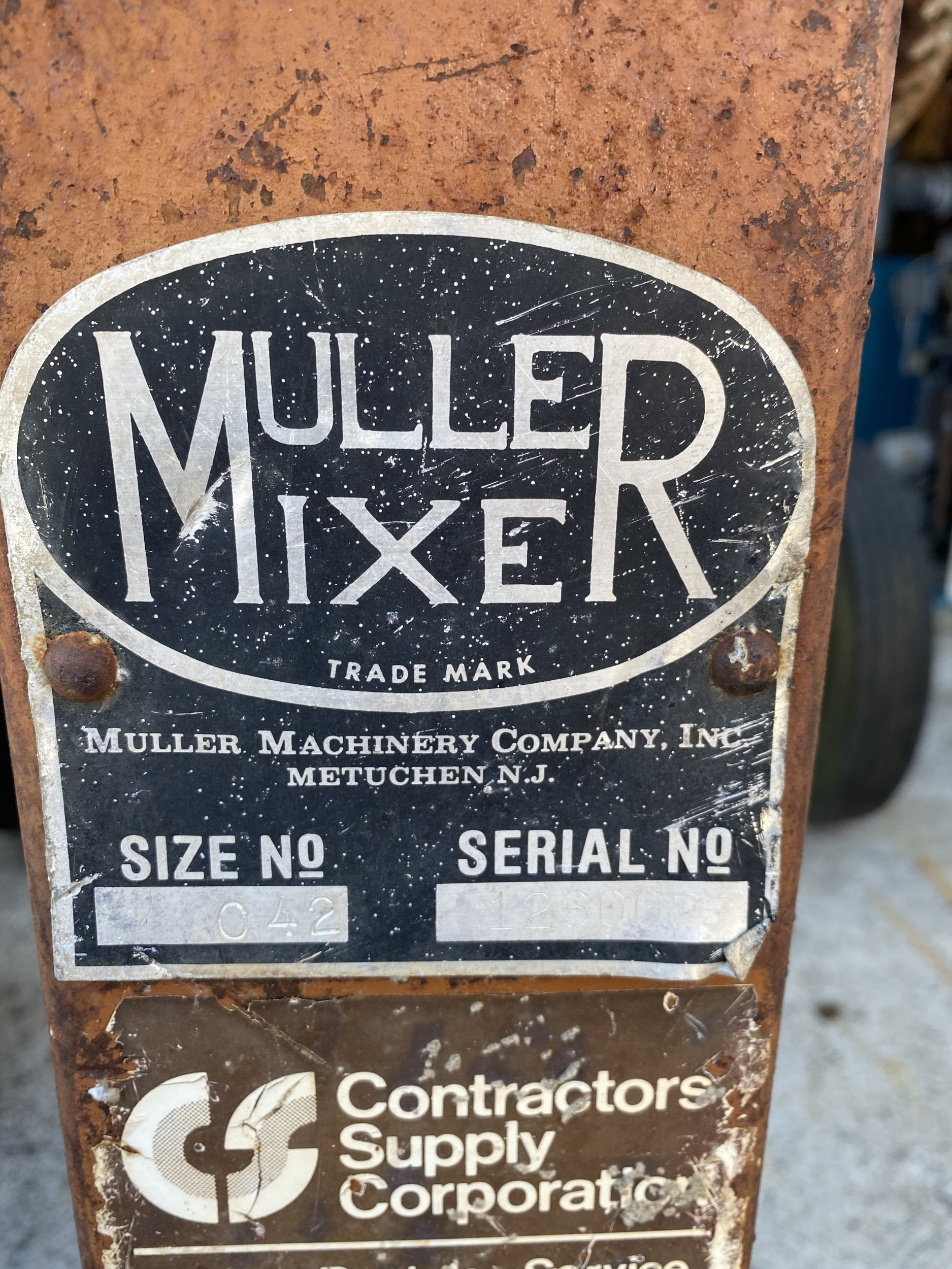

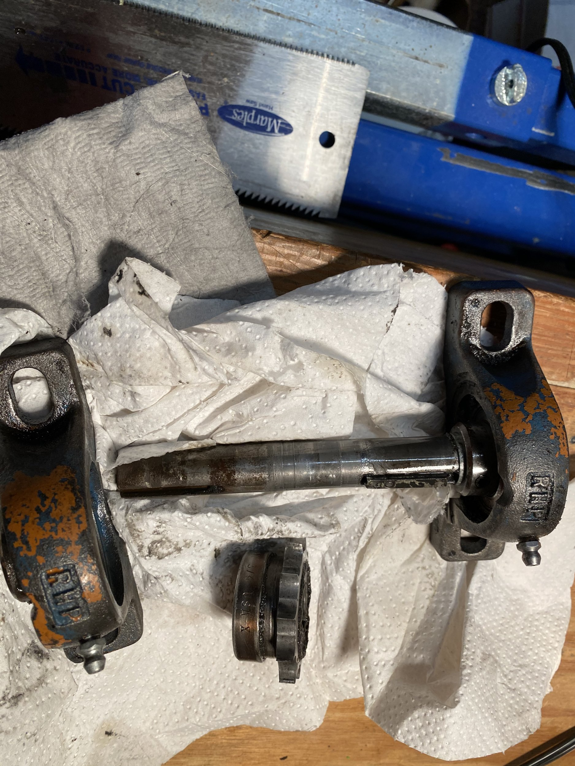

figured this to be the best place to find info for replacement parts for a muller c42 cement mixer looking for drive train shaft 3/4" 6" long two keyed slots. 3/4" 11 tooth drive sprocket, 3/4" pillow block bearings replacement of rph np2 bearings. IMG_6473.JPGIMG_6782.JPGIMG_6788.JPGIMG_6792.JPGIMG_6795.JPGIMG_6790.JPG thank you
/ muller tow behind cement mixer #2
I would say you can get all of that stuff from places like Surplus Center, McMasterCarr, etc.
Looks like it's all off the shelf parts. For the shaft, they also shaft with the key slot all ready pre cut in the entire length.
/ muller tow behind cement mixer #3
Agreed. Look up “bearing suppliers” in Google maps and it should quickly provide you options.
thats what i did just had to learn and measure pitch of sprocket being its severely worn.

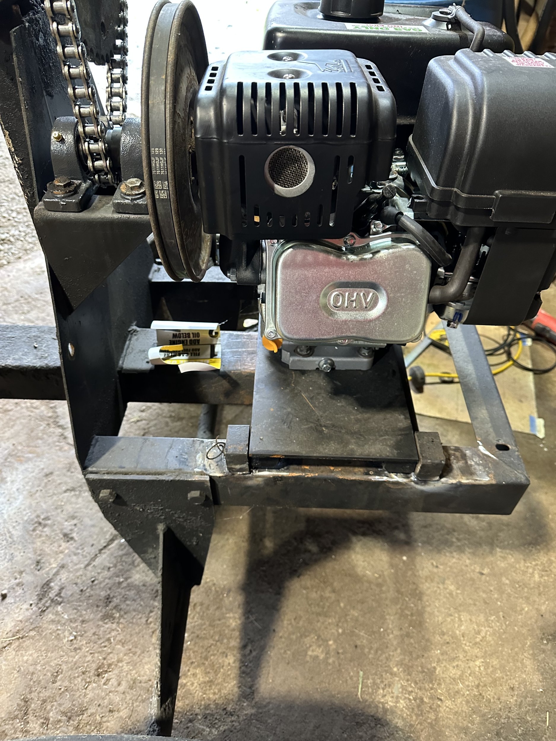

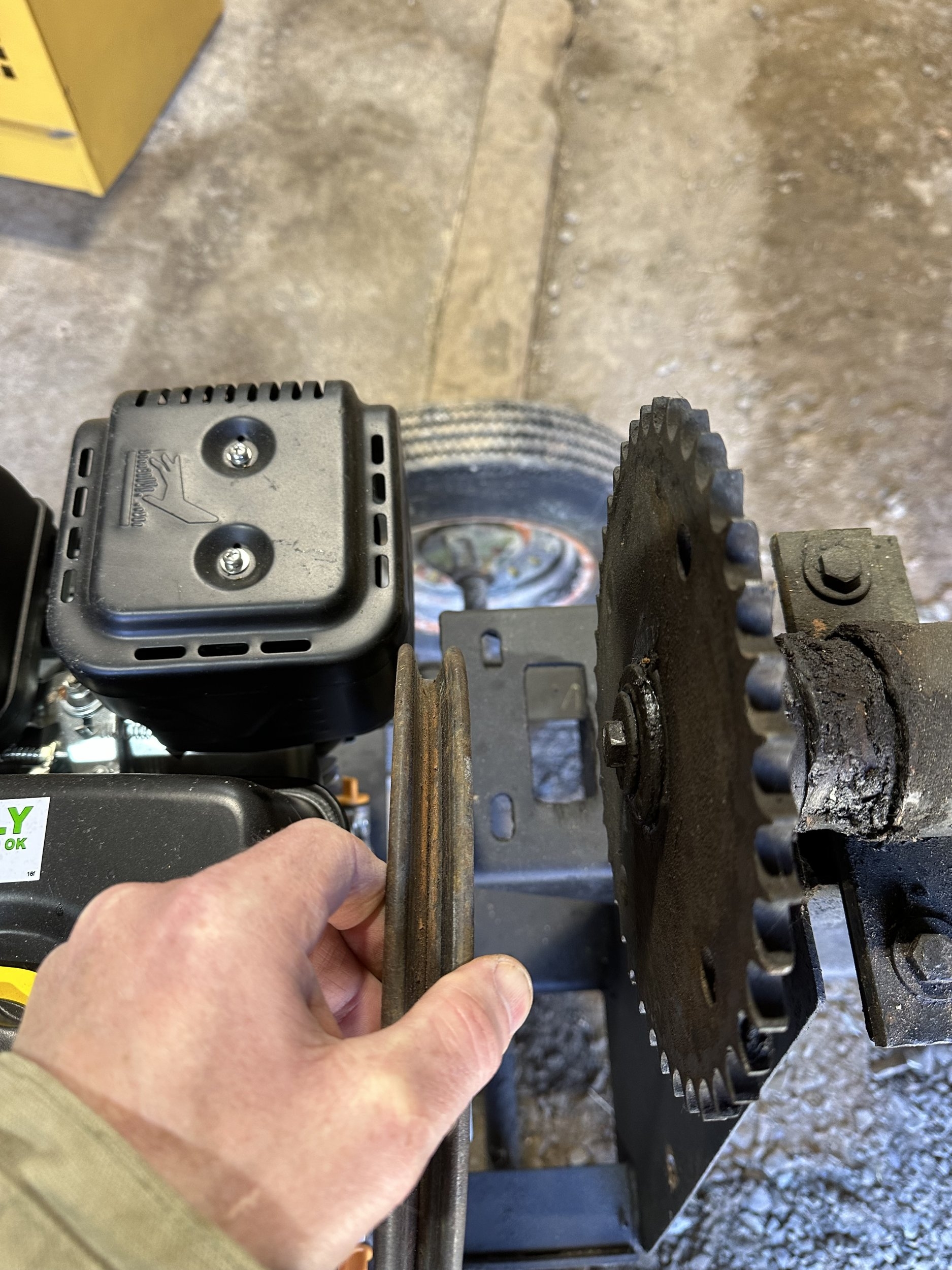

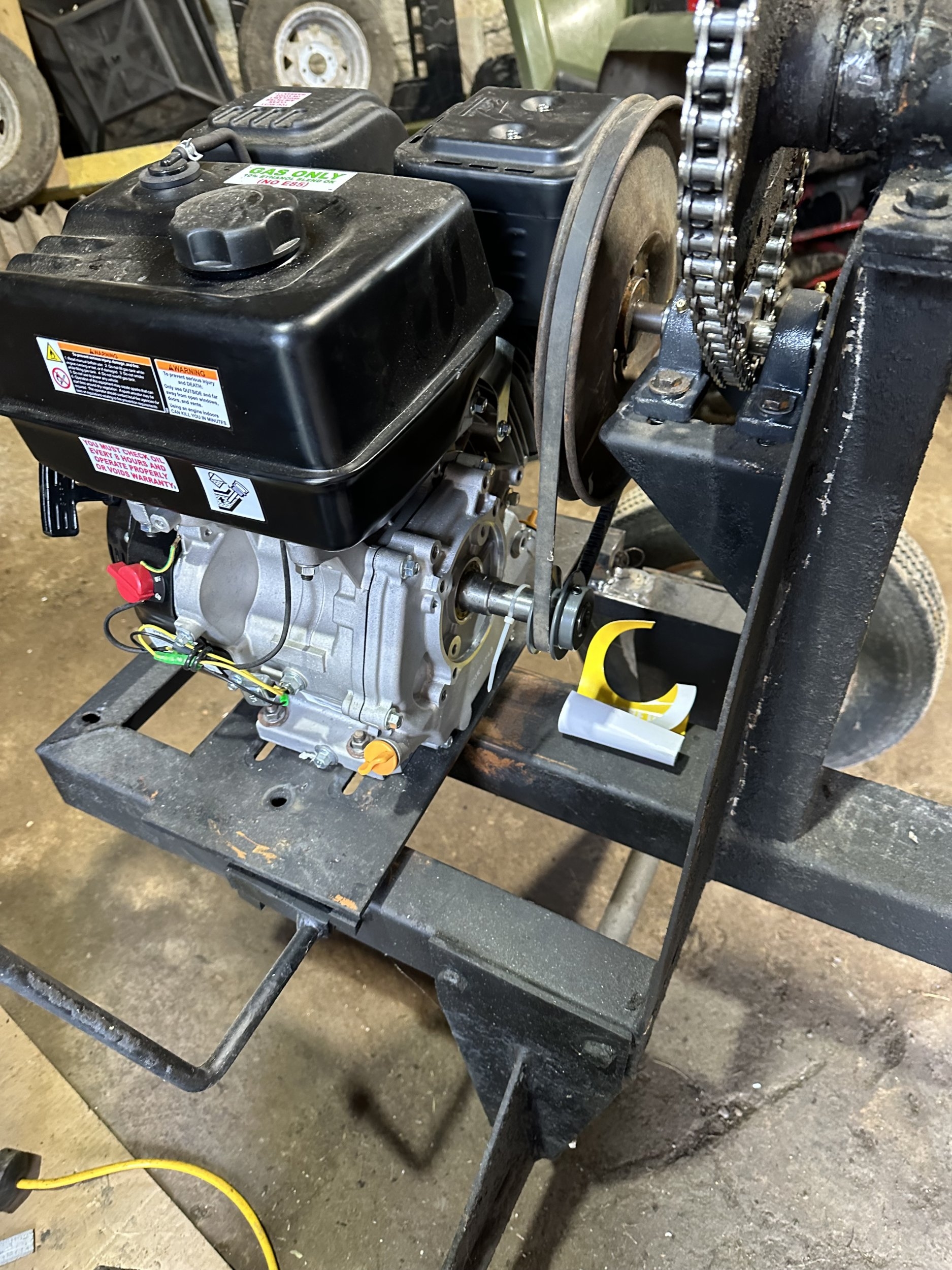

It’s been a while, but I’ve been restoring this cement mixer. I just mounted a motor on it last year. It’s an 8 hp from Harbor freight I went to put on the gear and pulley assembly to the sprocket and it looks like the pulley will not fit because the air cleaner is in the way, so I guess I cannot use this motor. I probably have to get a Honda 9 hp.

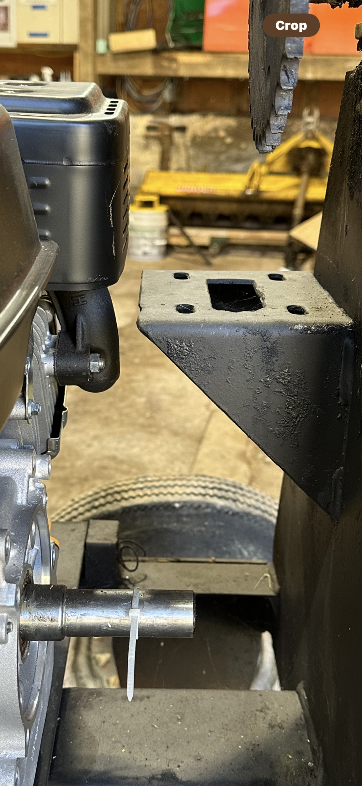

Update I had to cut and move the engine mounts approximately 2 1/2 inches so the chain assembly would not rub against the muffler on the harbor freight motor
