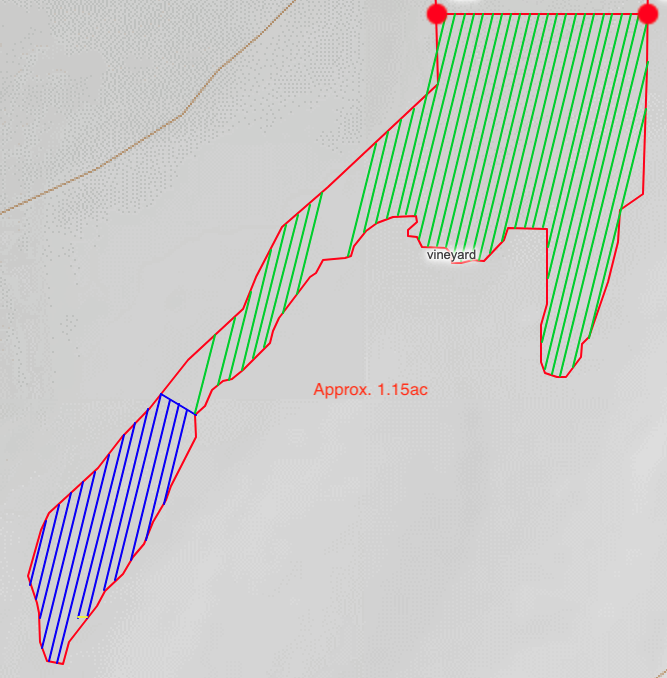

Given the old saw of "Good, cheap, and fast...pick 2", I need to construct a ≥8ft mule deer fence to protect a 1ac. vineyard in Northwestern Nevada. Prices are fluctuating wildly out there, so I don't know whether to bank on 10-12' t-posts, wooden round/square/rectangular posts, etc.
I have time, since I'll be doing it myself, so I need good and affordable. Plan is to use hydraulic auger for punching the holes, which is handy because it's how I prepare for vines.

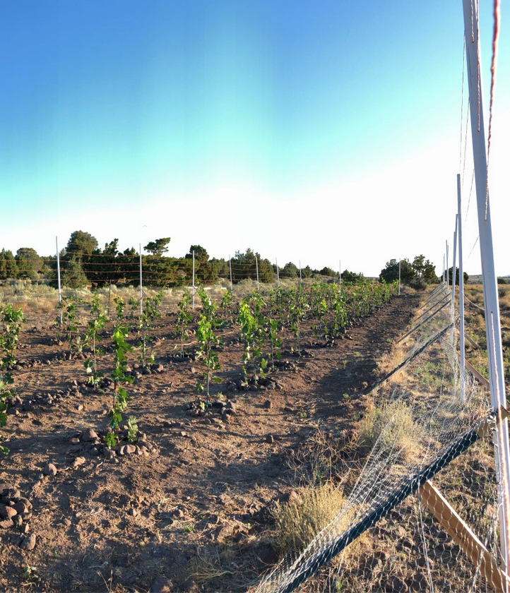

Trial fence comprised of 9'6" pvc tied to shorter metal fenceposts, with bottom 4' chicken wire and 1' spaced wires (orange bailing twine) above that, worked very well, but it's neither permanent nor inexpensive. It's in the photo. Ignore the angled bottom section, as it was a relic from a prior attempt.

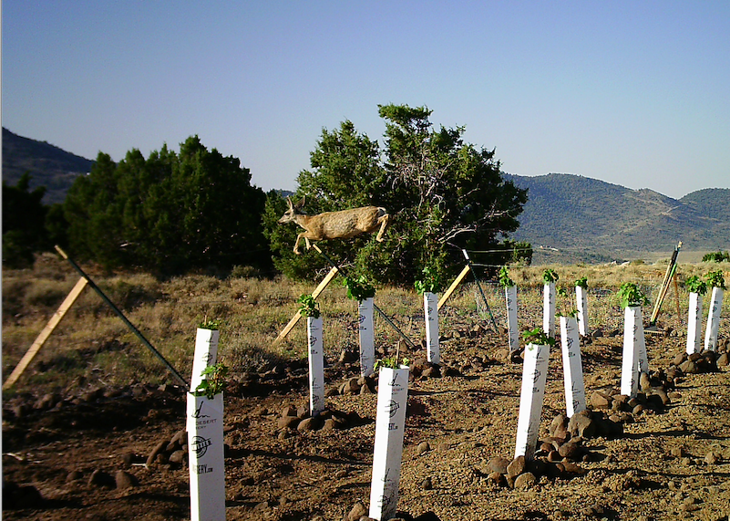

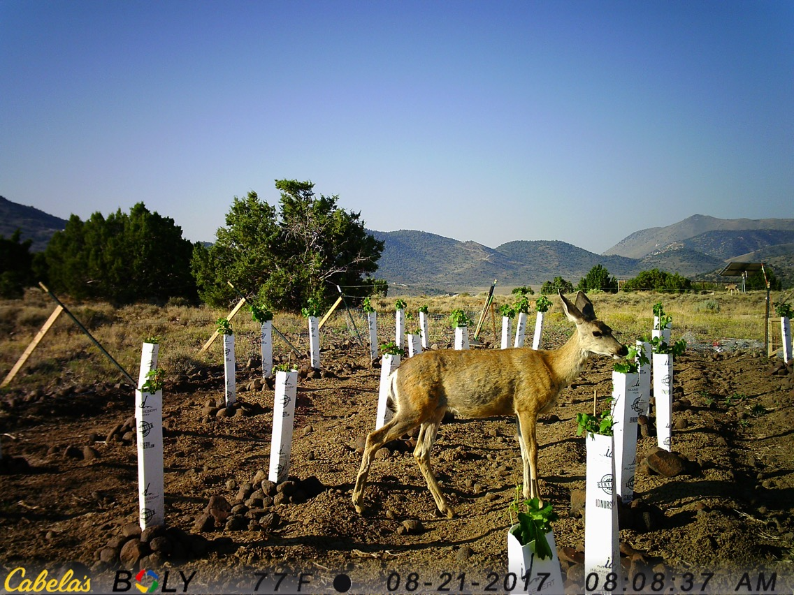

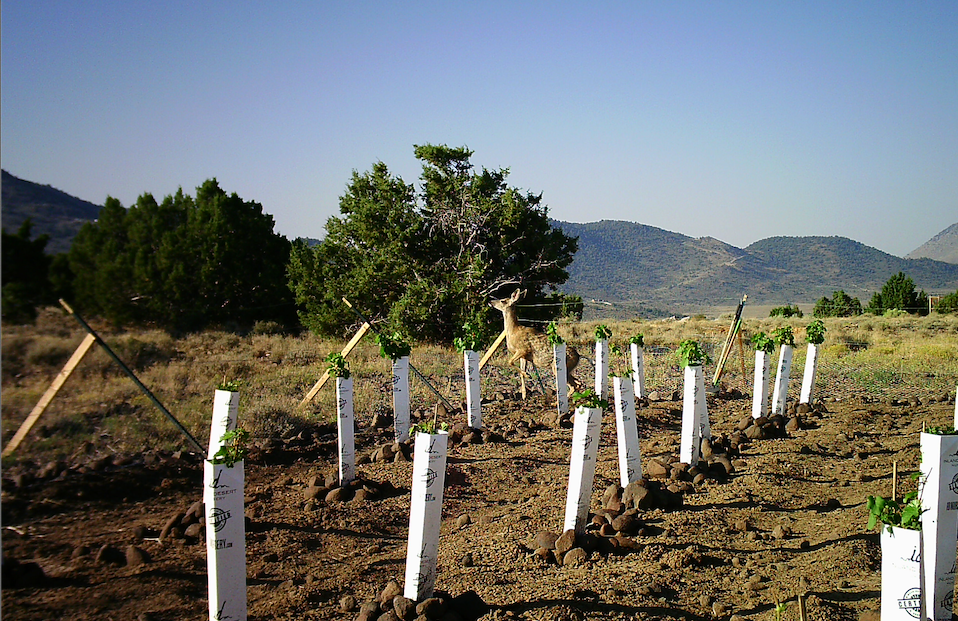

My first fence in 2017 was inspired by whatever I found on the internet. And what I found said "deer cannot jump up and out at the same time". So I put together something that was about 8' wide and 4' high.
In these 3 photos in series you can see the complete disregard this muley had for my "fence". From the crouch-and-spring in the 2nd photo to the sailing-over in the 3rd, this doe delivered humble pie.
Anytime I think I'm smart, I just look at photo 3.
Yep, been there, done that. I finally called Game & Fish Department to ask them what works. They said to build a solid 8’ high fence. It has worked for me for 8 years now.
