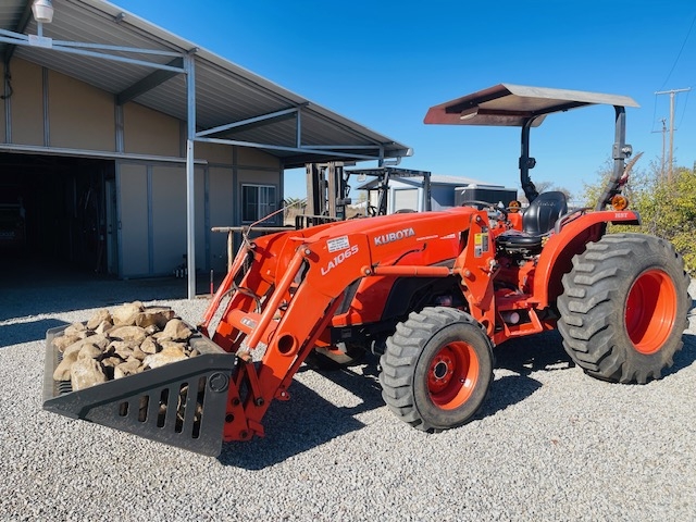

My solution is not quick - is not easy - however, it is permanent. With my light Stihl chain saw - cut down the sage at ground level. With the grapple on the tractor - pick and pile the surface rocks.

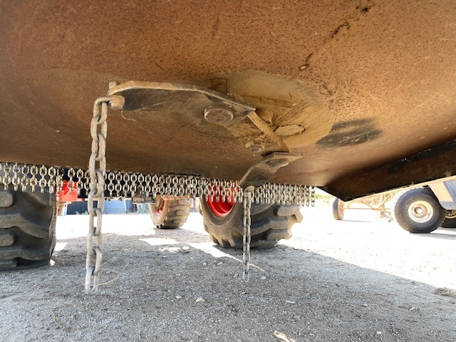

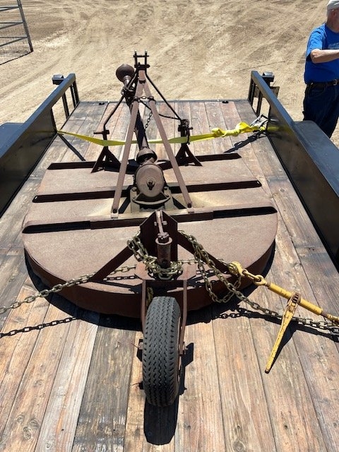

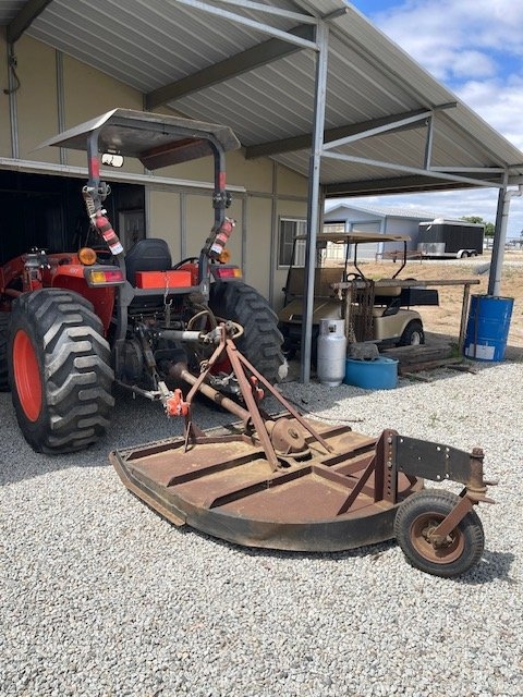

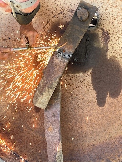

Similar problems here. We modified an old BH, cut the blades down and added hardened 3/8 chain. It's been working like a charm. While I try to avoid the rocks, hitting them does not hurt the chains like it did the sharpened blades.

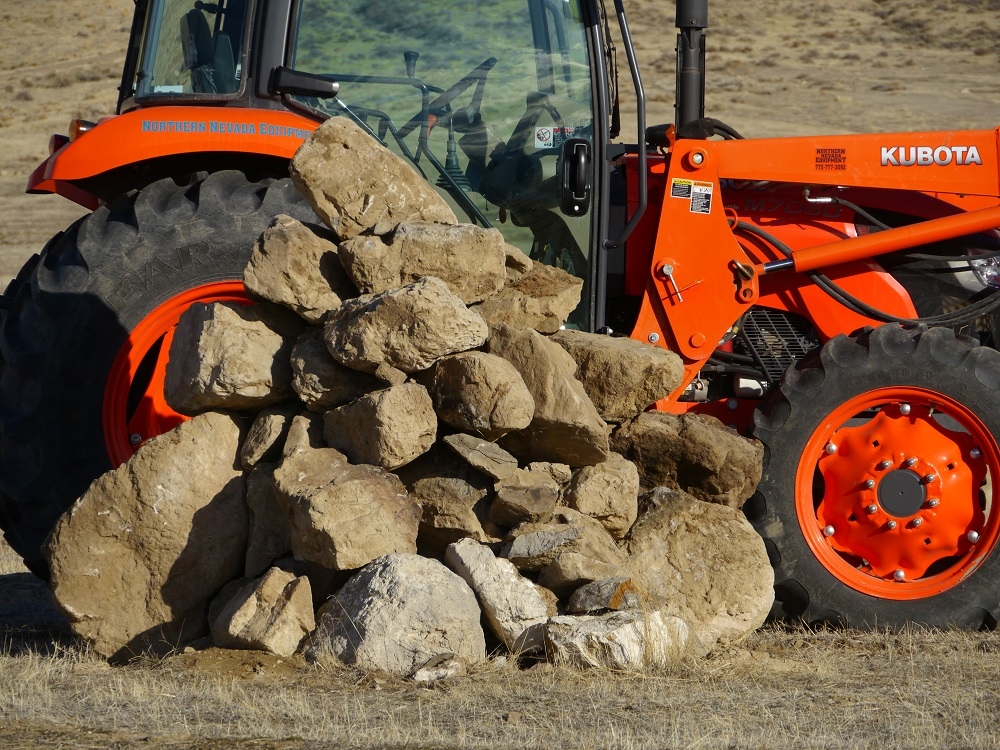

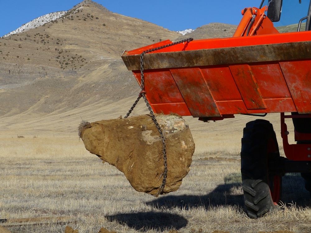

To be clear, a 2 ft tall rock is going to damage or tip your tractor over. These need to be located and marked with a stake or something before you try anything. Backing in a little at a time may be one approach. In any case there is going to be some handwork required to make this a mowable parcel. I recently reclaimed the neighbors 5 ac field that was covered in scattered rocks up to 12" diameter and growth 5ft tall. The first mowing cost me a set of hammers for the flail. $400. The I disced and cleared the rock and afterwards I modified the mower shown above. Now I keep it mowed and he pays annually.
Some of the surface rock removed.
