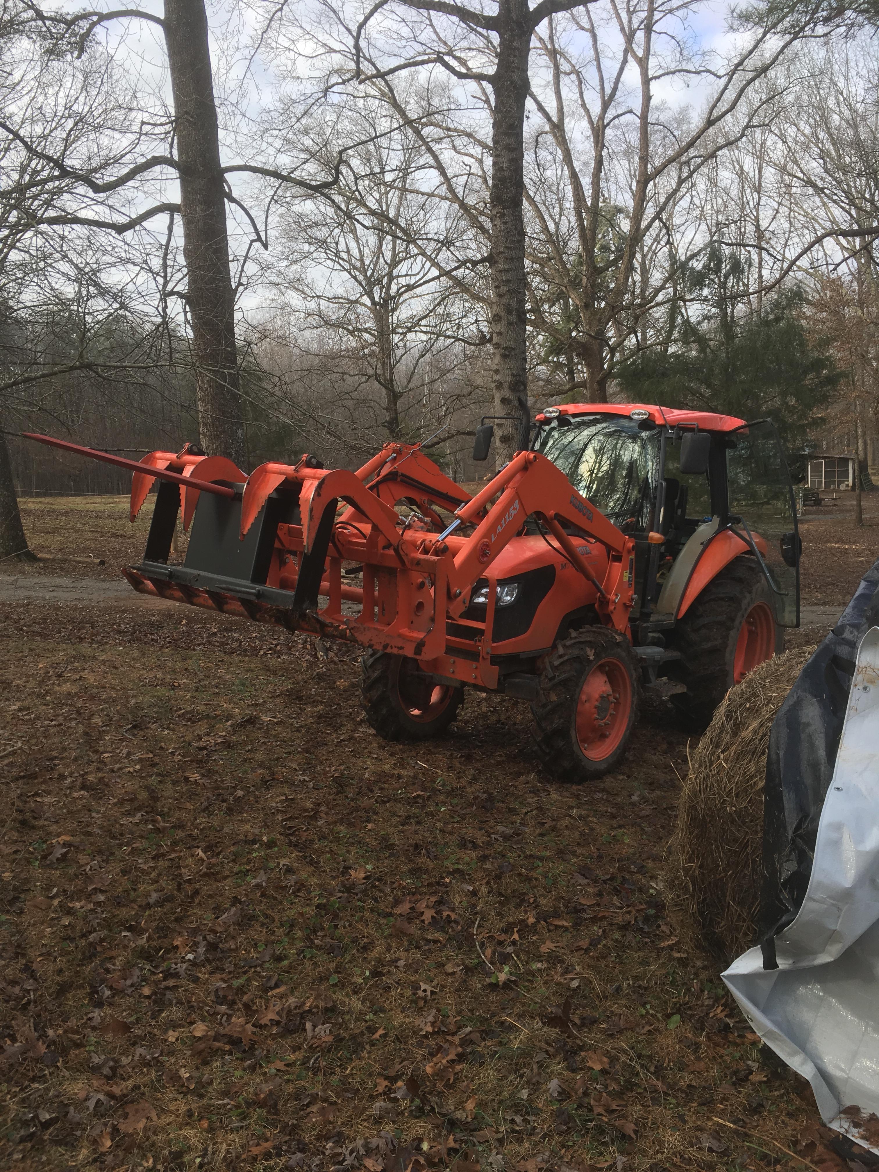

So I have become lazier since getting my grapple. Better than taking the grapple on and off!
Seriously though, my MTL 66” has been holding up great. I have really used the snot out of it as well. For $1k, there is nothing to complain about here.
Looks like all you need now is a leaf rake attachment (or hydraulic blower) and you'll never have to leave the cab! :laughing:

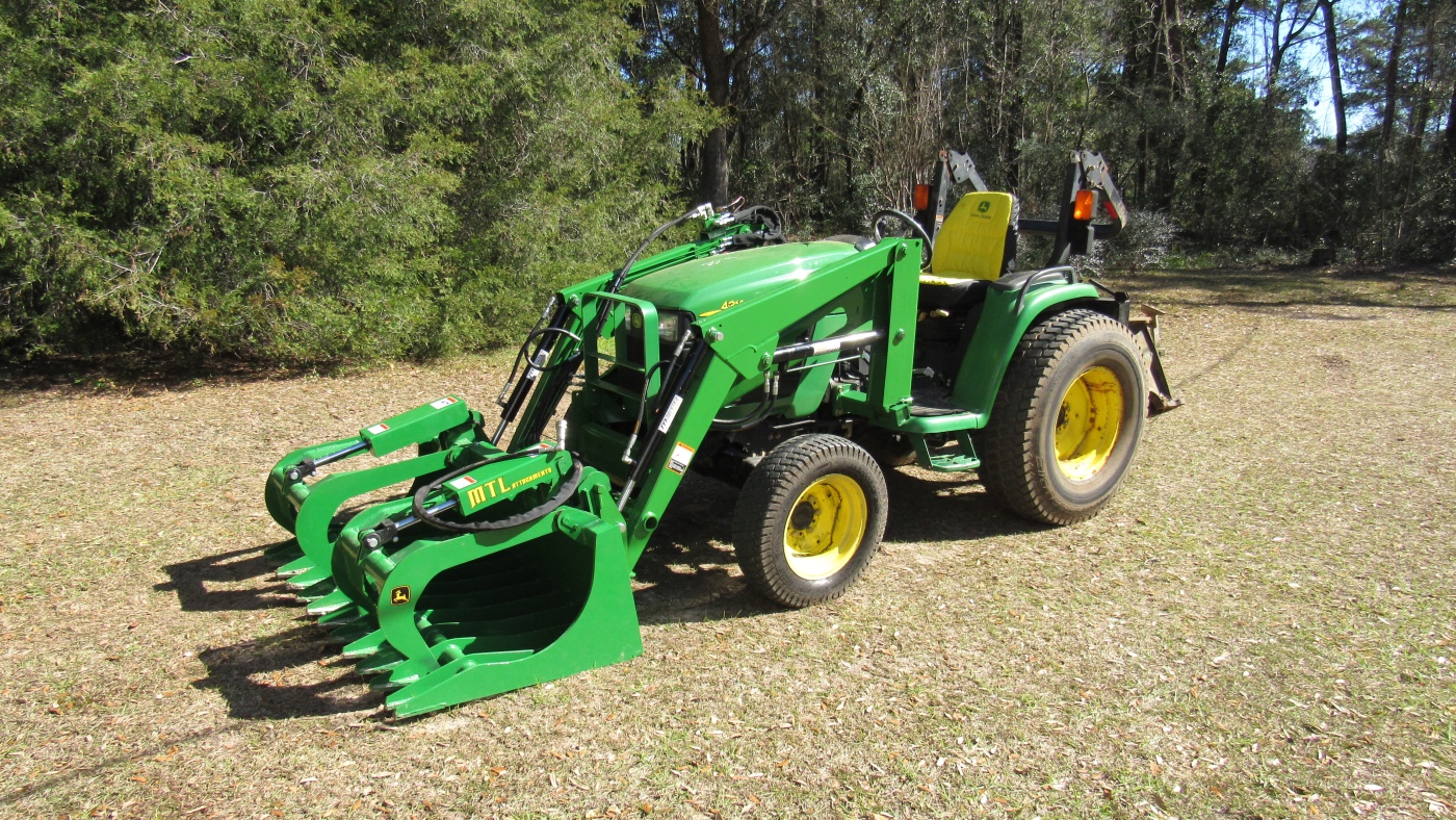

My 60" RK5 is a little heavy for my tractor but I haven't used it a lot yet. I finally finished my ballast box so the last time I tried it I was able to keep the rear wheels planted. I have a plasma cutter ordered and I MAY??? rig up a hole cutting template to lighten it some.

The jury is still out. I haven't used it much yet. I'm not crazy about the QH fit but it's functional and not a deal killer. The tines not matching point to point prevents me from doing any precise pickups. I tried to pick up a pile off my utility trailer today and only got about half of it before I had to pull the rest by hand. I think if the clamp tines matched the bottom points at full close I could have got almost all of it without getting off the tractor.
The thumb I welded on my backhoe is set so the bucket teeth match with the thumb points at full close. I can pick up a single stick with it if I want.

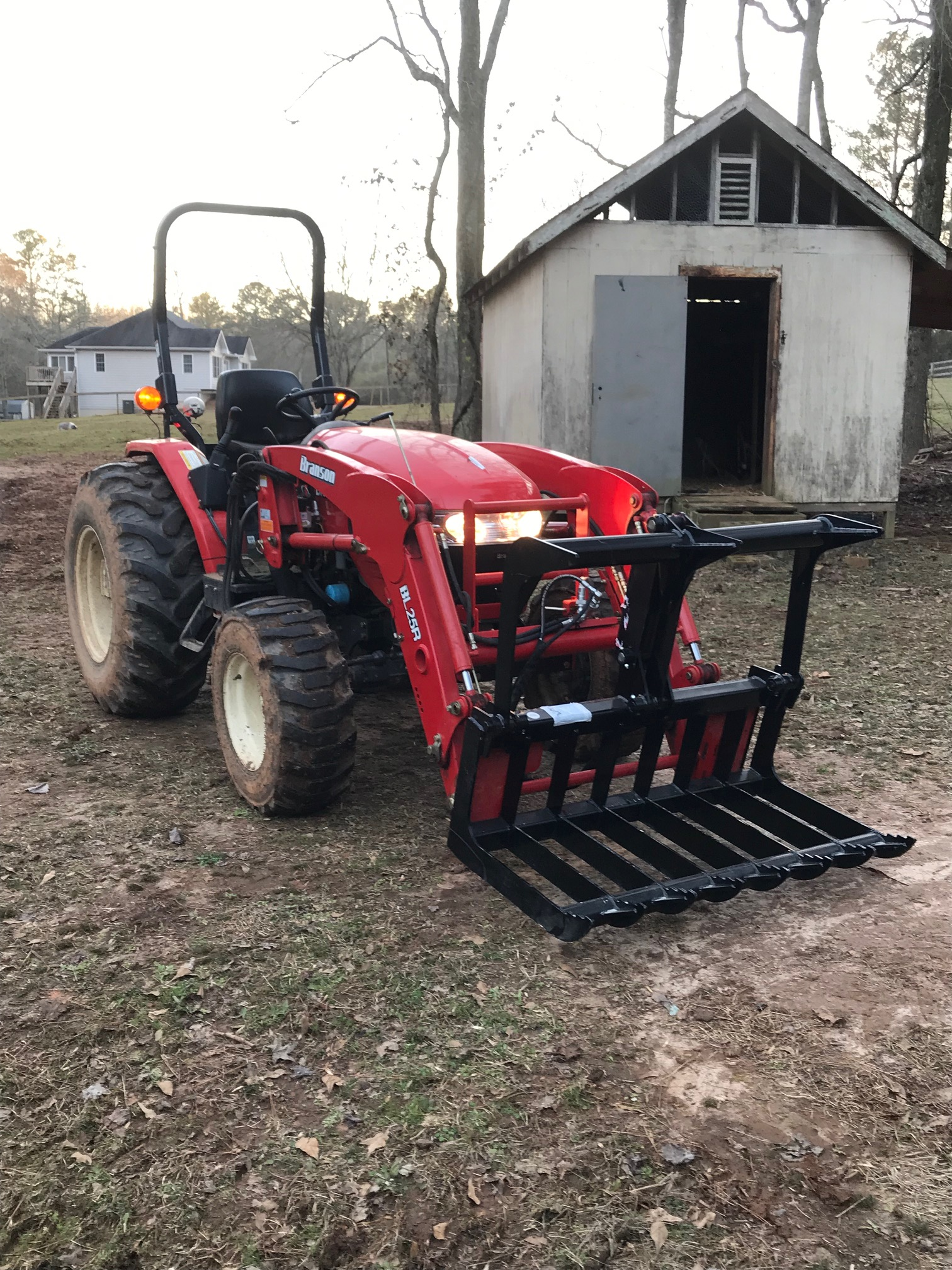

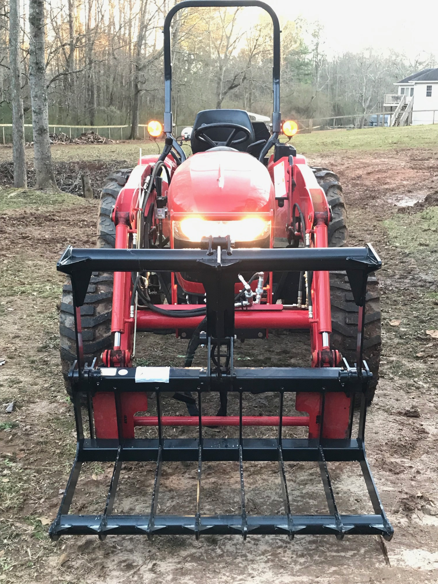

Sorry it took me so long to follow up. I got the 48" MTL and I am happy with it so far. Quick attach fit nice and snug. At 350 lbs I have plenty of lift available. My tractor is 47 HP and around 5000 lbs with loaded tires and rear ballast. Seems well built and has grease fittings at all key areas.
