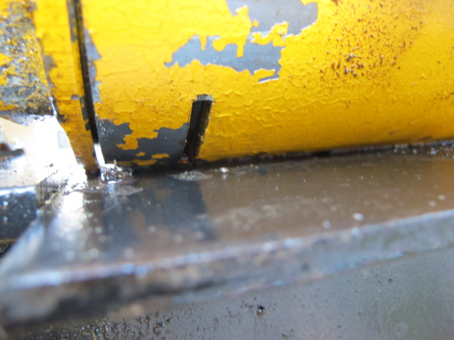

I just got one of these. Needs new seals in the hydraulic cylinder, but when I turn the big nut it doesn't come out. Anyone ever had one of these apart?
Jim
/ MTD Split-it log splitter #18
Yes, a few. Look on the side for a slot, you’ll see an opening for a lock wire, the lock wire is suppose to come out when you turn the gland, unless the end of the lock wire is broken. Then you’ll have to get creative to pull it out while turning.
/ MTD Split-it log splitter #19
Thanks, I never would have seen that. I didn't find any sort of a hole for a lock wire yet, any more suggestions? I spun the gland nut all the way around a couple times and could only see a smooth surface. Couldn't even tell if it was turning.
Jim
/ MTD Split-it log splitter #20
The smooth surface you see is the lock wire, more than likely .125” square. You’ll need to get that cyl off and on a bench with the slot on top to see what’s going on with the lock wire.
