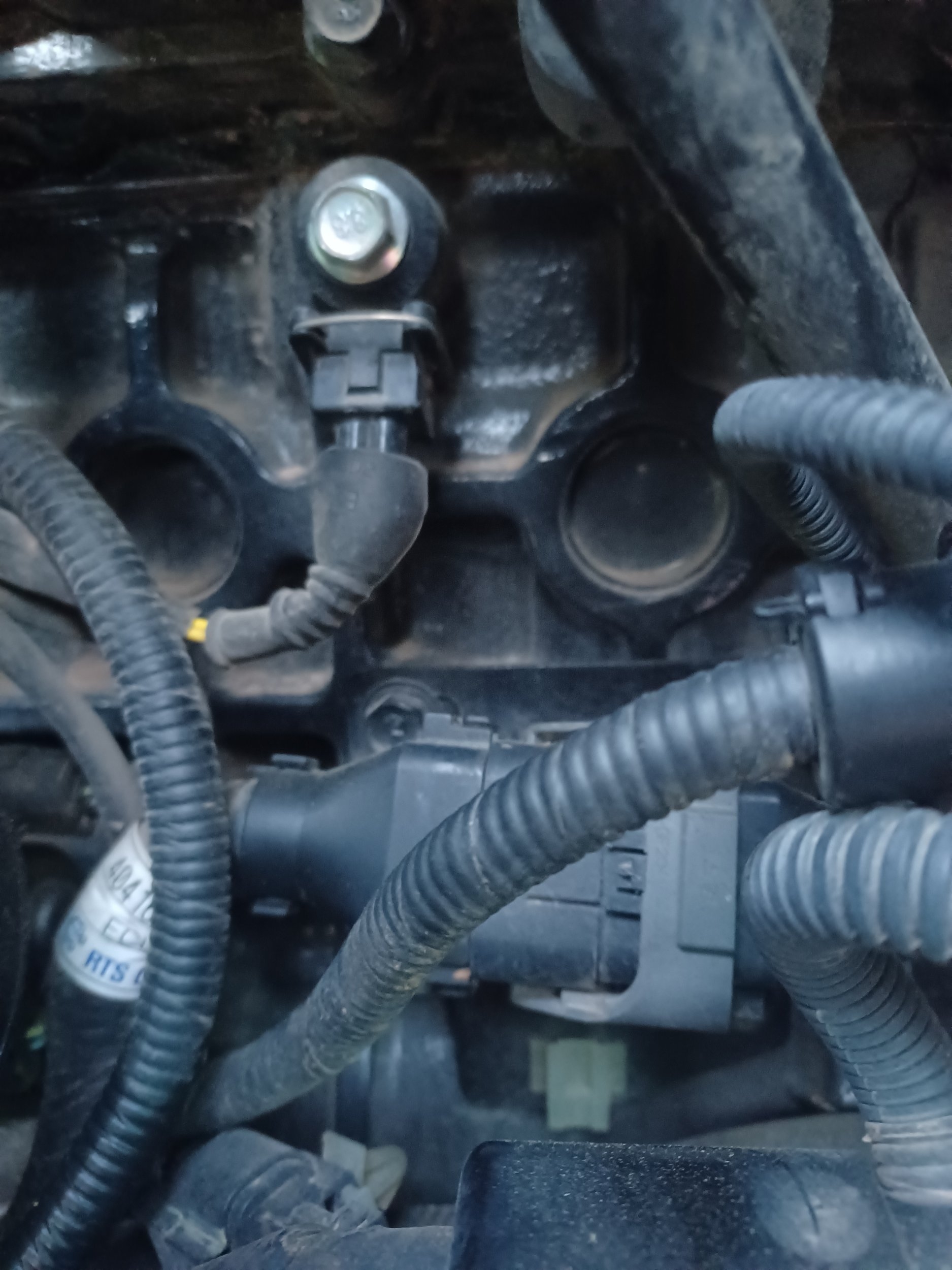

this one??
/ MT3 Crank position sensor location?? #4

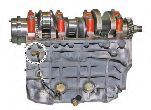

That looks like the Knock Sensor to me, here are pics from the manual (mt2xx but same motor) and PDF of the locations....
  • output.pdf
ok thanks to @Eagle1 I found the crank sensor. Its BEHIND the starter motor. And BEHIND yeah that sucks.

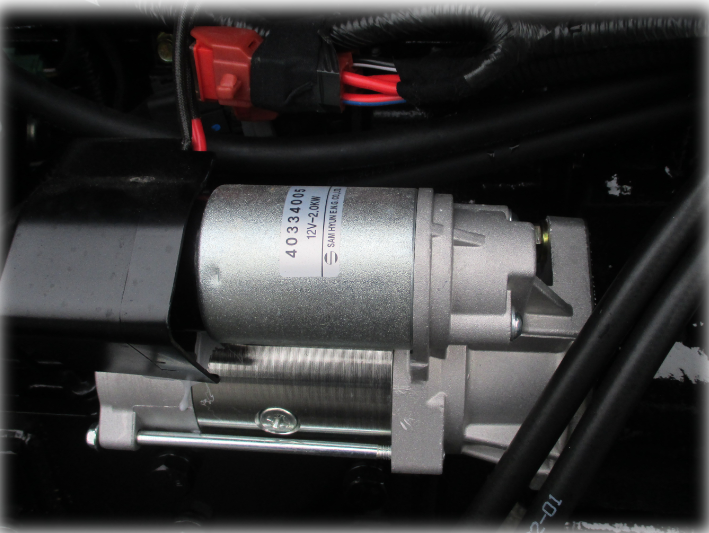

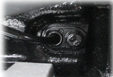

The key to replacing the crank sensor is removal of the starter. Once the starter is out of the way easy replacement.
Pro Tip: Dont drop the bolts.
Starter upper bolt is hard to get to. Hadda use a long extension for the upper starter bolt and a medium extender for the lower bolt.
Larger hands dont help here.
Here's the where the crank sensor is located. The studs are where the starter is attached. Easy to see the starter has to be removed.
