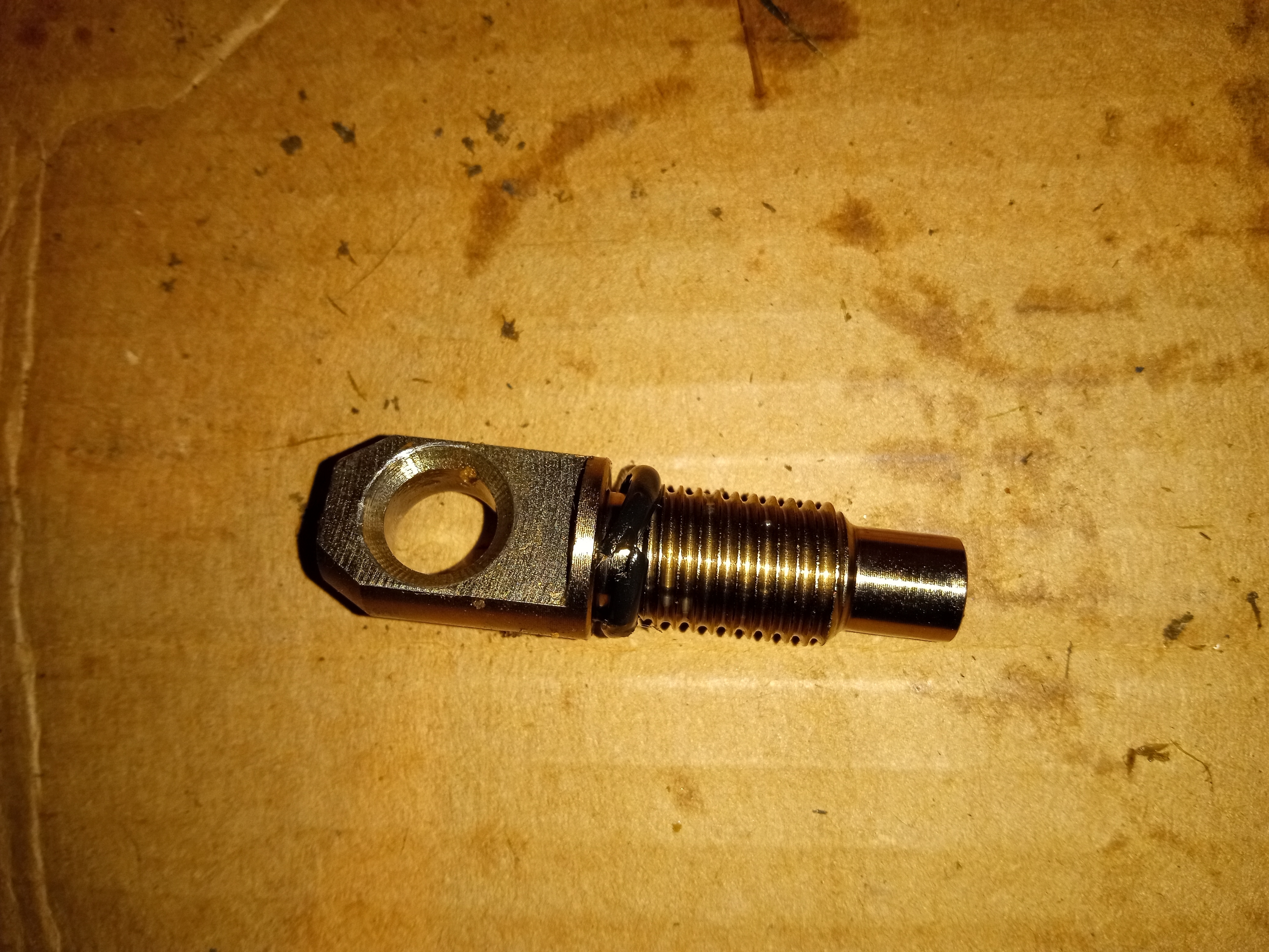

Bump this to the top here as I have my bucket control valve leaking now. I took it apart and the O-ring is blown out of what I would call a spool valve. Does anyone know what size O-ring this valve takes? I have tried a few different ones but they blow out after a few hours. * Picture is from another thread but that is the same O-ring that I need.
Thanks
/ MT225s Loader Valve Leak #13
Any update on a fix for this? I started having the same issue the other day. I found some O-rings at Tractor Supply that appeared to be exact matches, but after and hour or so they start leaking
