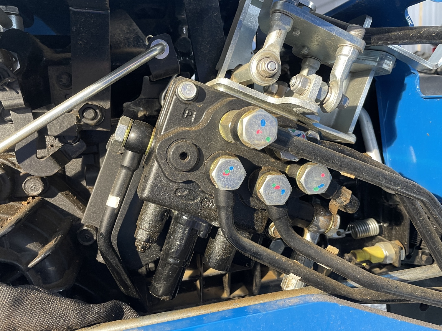

I developed a leak at the bottom of my MT225s loader valve. Bolts are tight and it leaks when operating the bucket.
I am assuming it is some type of pressure valve. Can anyone tell me what this part pointed out with the arrow is called. I don’t know if there is a gasket I can replace or what.
None of my manuals have a parts breakdown for this.

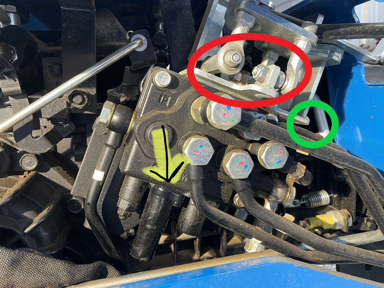

My MT225S developed the same upper valve leak, just the other day. I was back-dragging some woodchips using the float position. No load on the bucket of note. Just started a steady drip-drip-drip while there was hydraulic pressure in the system.
Mine is leaking from the red circle area and pooling/dripping at the green circle.

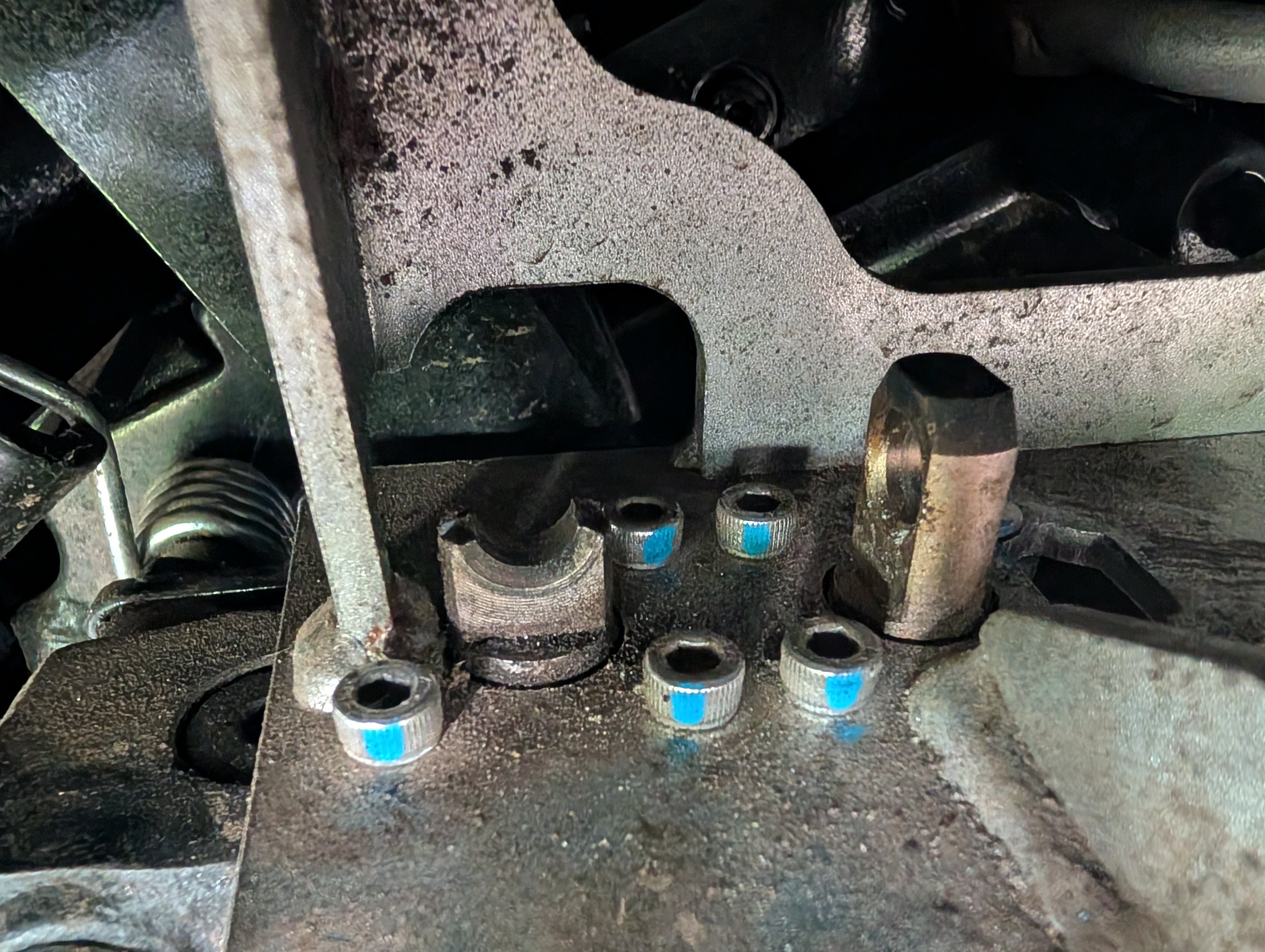

Would you mind posting a few more pictures of the top of your valve? I think you have a new design...the top of my spindle keeps snapping off.

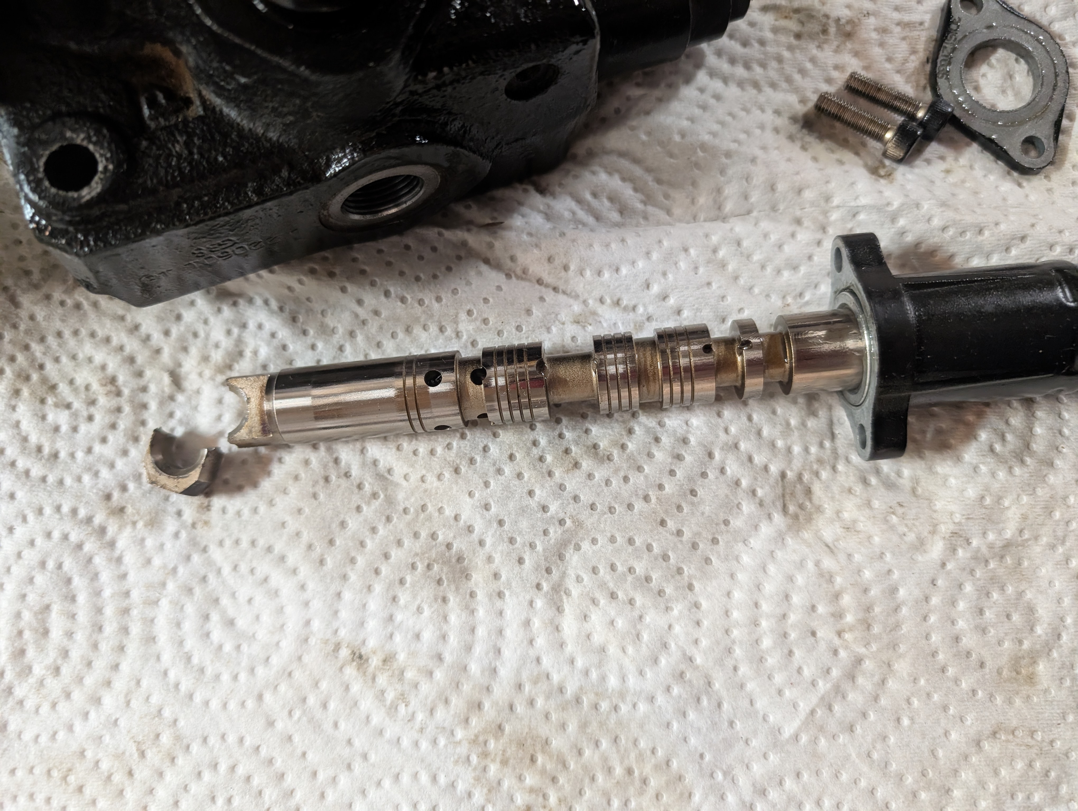

Interesting my 225 broke the same way with that silly mouse trap,the linkage loads the valve on the side causing the breakage. Mine was replaced under warranty, now just about a year after the replacment fluids poring from the top of the same valve more than likely do to the side pressure applied to the valve when going to the flote position. My dealer apparently had never seen this valve break like this, his story I don't but it. Anyone else?
/ MT225s Loader Valve Leak #10
Just for future reference , mine also broke at the same place. But unfortunately is not under warranty, I'm in the process of looking after the part cause the controller is cad$1k. Or I'll try to get someone to weld it.

Bump this to the top here as I have my bucket control valve leaking now. I took it apart and the O-ring is blown out of what I would call a spool valve. Does anyone know what size O-ring this valve takes? I have tried a few different ones but they blow out after a few hours. * Picture is from another thread but that is the same O-ring that I need.
