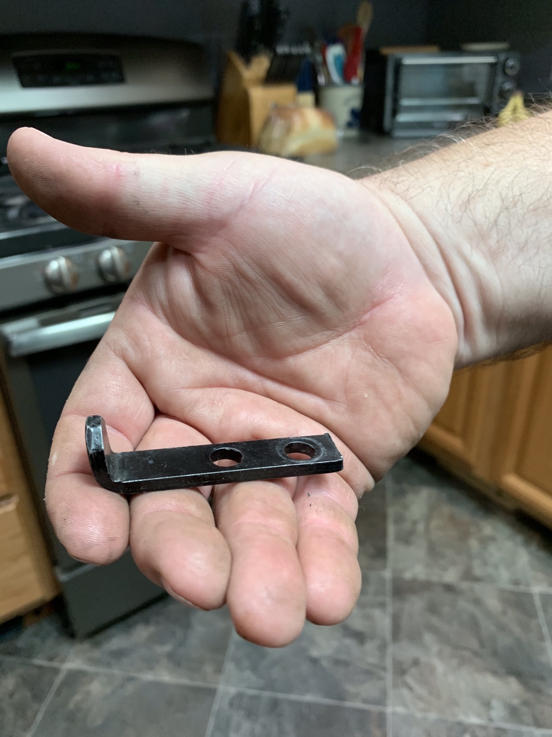

Now I have a question about a leftover part. It fell when I first took the seat off the tractor. It might be a leftover from the original none swivel seat but it can’t figure out its intended job. Thoughts?
/ MT225S Backhoe Seat Question #27
Maybe a stop so the seat does not slide back to far........:confused3:
#28
That’s what I was guessing but both slides still have stops. I’m just hoping it’s not part of the ejection seat assembly. Lol
/ MT225S Backhoe Seat Question #29
It looks like a slide stop. There was something similar that I removed on my work truck.
/ MT225S Backhoe Seat Question #30
That piece is a travel limiter. It goes on the right rear seat rail and if the track is not in the right position when installed it will limit forward travel.
It's not really needed as the tracks already have travel stops.
