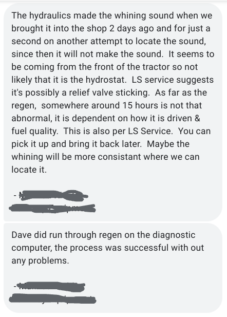

"...is not THAT abnormal" funny how that is written, meaning it is abnormal, but not enough to look for a cause.
