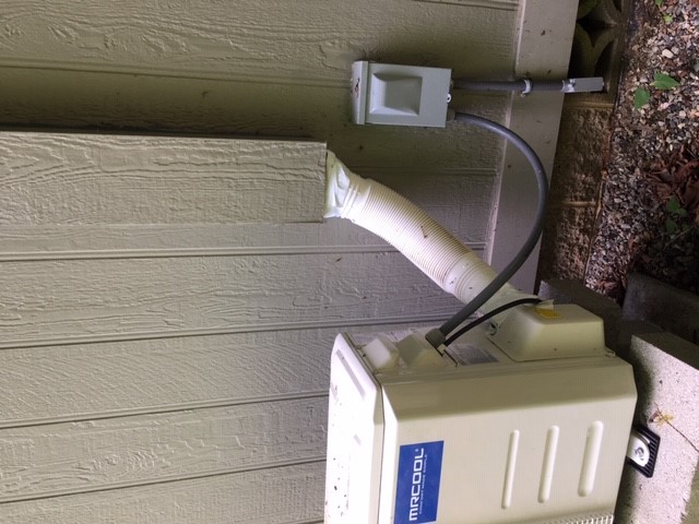

UPDATE/ I finally got around to installing my 18k Mr Cool DIY mini split in my hunting camp and so far I am very impressed with it, it has no problem cooling the 800 square feet camp and is unbelievably quiet indoor and outdoor unit, the best part was not having to hire an A/C contractor, I was able to do it all myself, I would recommend this unit for cooling to anyone, I will have to wait till winter to give an update on the heat pump portion of it for heat. Charlie.

I ended up putting one in, last fall. To cover the external lines, i used plywood and painted to match, can hardly tell it's there. Used it for heat, all winter long. Power savings was substantial, even in this temperate climate. Now i have AC for the summer!

I used a lineset cover that I bought off of Amazon and I just routed all the extra lineset under the floor joists and strapped it to keep it from going anywhere, I tried to make it as neat as I could.

Looks good, Nice job.
