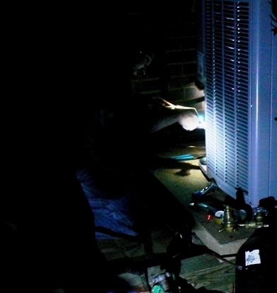

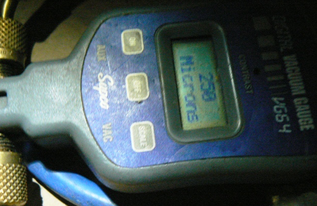

This is why I don't give professional advice in my own trade on a publicly read internet forum.
My own house. Started the job at around 0800 on the weekend. These two pics were taken around midnight that same day.
View attachment 658853View attachment 658854
Congrats. I just shared my personal experience. I got 3 quotes between $6-7k. I thought that was outrageous, I bought it for 1k, and did it myself in a couple of hours. I could screw it up 6 times before I'd be losing money. I did research, watched videos, and learned a lot. Then I did it and managed to get it right on the first shot. There's dozens of videos on youtube detailing their process, so clearly I'm not the only one doing it myself.
/ Mr. Cool Advantage Mini Split Heat pump/AC #24
How many microns did you pull to ?
I don't know, I don't have a micron gauge. I was told to leave it for 15 minutes. I left it for 45min, closed it off, let it sit for 2 hours to make sure the guage didn't move so I was confident I didn't have any leaks. Then opened the system and released the freon as it was precharged for up to 25' of line. I figure the worst case scenario i have to call an ac guy to properly vacuum it and recharge it which I had already priced at about $400. I bought a vacuum and gauges off amazon for $100, a kit to hide the wires for i think $70. 30a double pole breaker but it was right on the other side of the wall from my electrical box.
LMAO!
I am not in the HVAC trade and I installed a mini-split myself also, but I also agree with Sigarms. If you don't understand the terminology, you either need to find out or let someone else do it. I also didn't understand how a micron (as a unit of distance) applied to pressure. So, I looked it up. A micron is also a mico-meter of mercury of pressure and 1000 microns = 1 millimeter. So the picture in Sig's post shows that he pumped it down to 1/4 mm of mercury of pressure. There is no analog gauge that can measure that. Also, how about the time he took to vacuum out the lines. There is a reason to get down below 300 um and to hold it for awhile. Look up what happens in the copper matrix when a vacuum is applied and how long it takes to happen. Also, look up what happens over time when a little moisture is left in the lines and the Freon is released.
I did the installation myself because I couldn't get an HVAC guy to do it for less than $4k. I could buy 2 systems for that price so I figured it would be a learning experience. I did a lot of research before I attempted it.
Yes, you can "pull" a vacuum in 15 minutes, but does it accomplish what it needs to?
