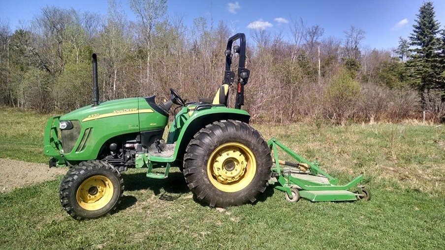

This is how I used to mow. I don't recommend it. If you're going the tractor route, go smaller with a belly mower.
Dave

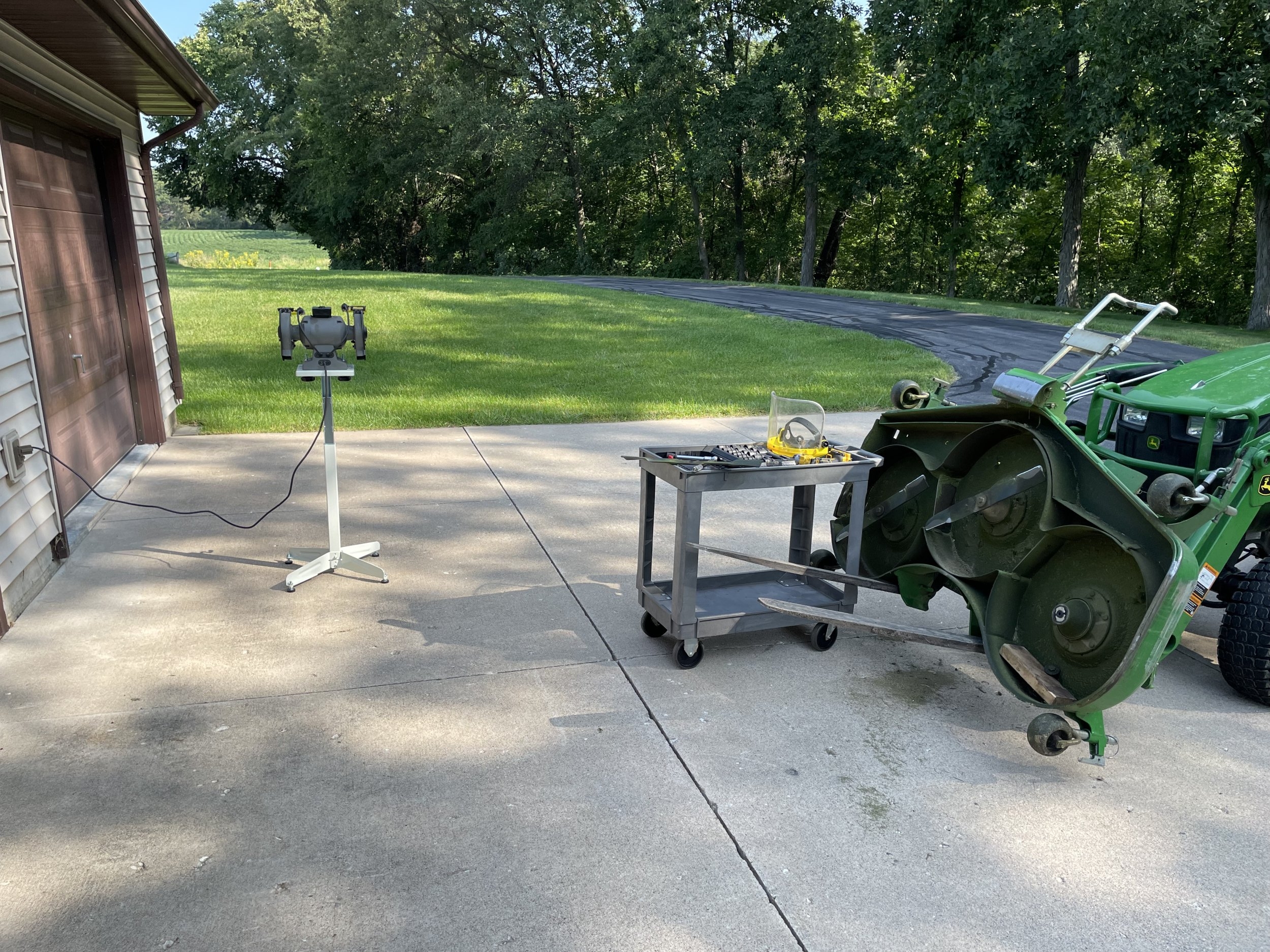

This is my deck and how I clean it off underneath. I use my forks to lift it up and then tilt it back on the headache rack to clean it and sharpen the blades. In this picture I didn't do any cleaning, if the grass is dry it is almost self cleaning. Mine is a JD with the 60” autoconnect deck. It’s not hands free but almost. Not exaggerating it comes Off in two minutes and back on in the same time.
