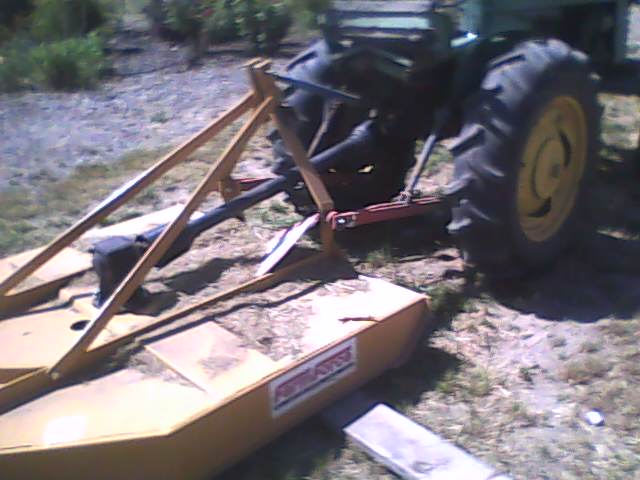

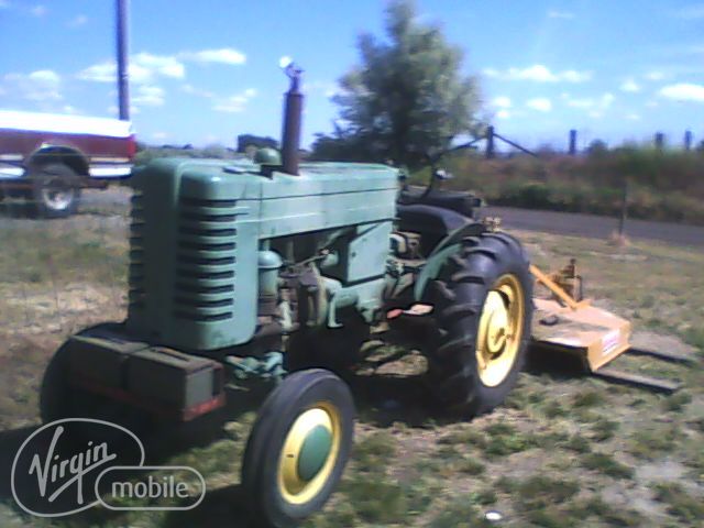

i'm using a 3 point mower with my M, the one i got is a 5foot, i have used a 6foot with it, just takes a lot of weight up front to keep the front wheels on the ground, they sell 3 and 4 foot mowers that will work just fine, just look for a light weight mower if you have a 3 point on your M, i found if i can pick up one end of the mower, then the M can handle it, with out adding weight to the front.
/ mowing with a Deere Model M - what to use? #14
this is what i'm using on my john deere m
