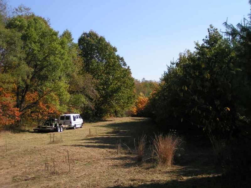

Unfortunately, I didn't take any pictures of those slopes. I did, however, take some nice fall pictures. Attached is one of a small field that is about half an acre. It sits at the entrance to our property and evetually will be a small orchard. There was heavy grass in this field and I had to go at a slow walking pace to get through it. Funny how foot high grass is much harder to brush hog than 2 inch saplings /forums/images/graemlins/crazy.gif

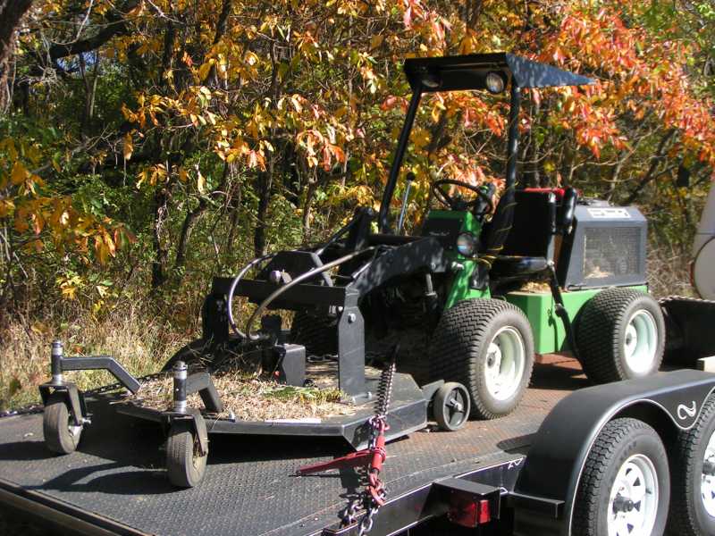

Picture 2 attached shows the PT425 on our trailer chained down and about ready to go home. Notice the debris all over it.

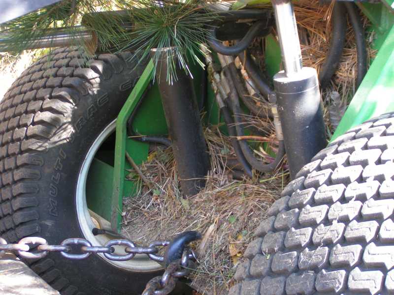

Last picture for now shows a close up of the front of the unit covered with pine needles and branches.
One thing I like about the Power Trac design is that it is so low to the ground compared to other Compact Utility Tractors. It gives it very good stability. I have never felt uncomfortable on any slope that I have ever had it on.
The attachments out front are great. The brush hog kills everything before you get to it. On a conventional CUT I would have had to back into most of the stuff on our trails and that would have taken a very long time. Today, with the PT425, in about an hour and a half, I brush hogged about 1.5 miles of trails three passes wide, plus the 1/2 acre field in the first picture. Nothing had been cut since last year. In some places the weeds were 6-7 feet high, like in the videos on my Power Trac website. I took out several hundred 1-2 inch saplings and ground them into oblivion. I killed about 20 multi flora rose bushes that were every bit of 10 feet across and 6 feet high. They are no more. /forums/images/graemlins/tongue.gif I can't even begin to imagine what a job the larger Power Tracs could handle. That would just be awsome! /forums/images/graemlins/cool.gif
