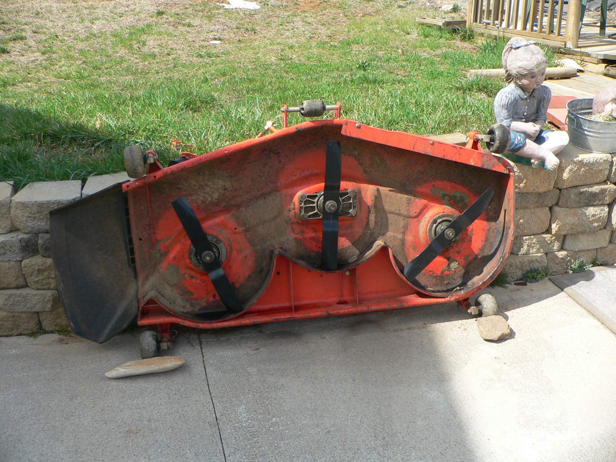

Is this what your talking about? Does it grind down enough to take the nicks out of the blade? How do you get it under the mowing deck? How many blades will it do? Had this for a few years but never got it out of the package, yet? This is the picture with my new blades installed.

I've got a little push mower that I'll use it on since you say it works well. I've already swapped out the 3 blades on my deck with new ones and have the old ones ready to sharpen off of the deck. I've also got a front end loader to raise it off the ground if I were going to do it on the deck. Thanks.

That's (1 3/16") what Kubota mechanic said they use in a 6pt only not 12 point. Guess the 30MM is the exact and the 1 3/16" is close enough if 6 point. Don't have either but going to have wife pick up a 30MM 12 point since that's what they (Advance Auto) shows they have on internet for $8.19. So for $60 for blades and $8.19 for socket I can start cutting grass again instead of just breaking it.:)
You will be much better with the 6pt socket because there will be no chance for it to slip as opposed to that 12pt which willslip if there are even small imperfections on the bolt-nut.
It's all I have used for the last 35yrs and it doesn't give me any worries at all.
One other thing John try to use a torque wrench instead of the air gun as they can tighten up so much that sometimes the nuts- bolts may have to be torched off. Don't ask me how I know LOL.

Your several days to late. Done bought the exact size 12pt 30 MMM and if fit perfect and not the least bit worried, To late on the air wrench, done done it and will never go back. I don't have a torque wrench anymore and haven't had one in 20 years and have never missed it. But thanks.
