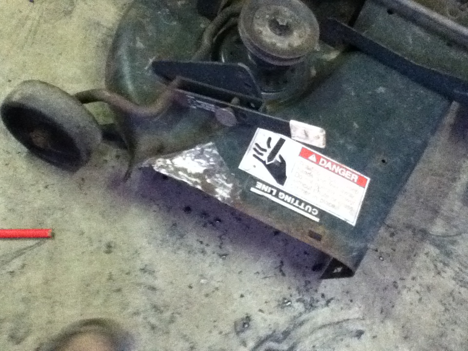

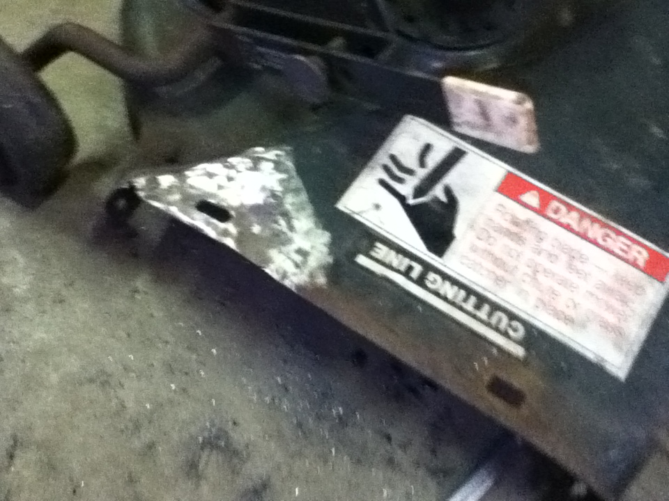

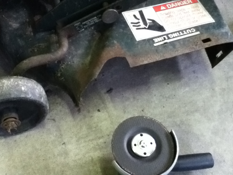

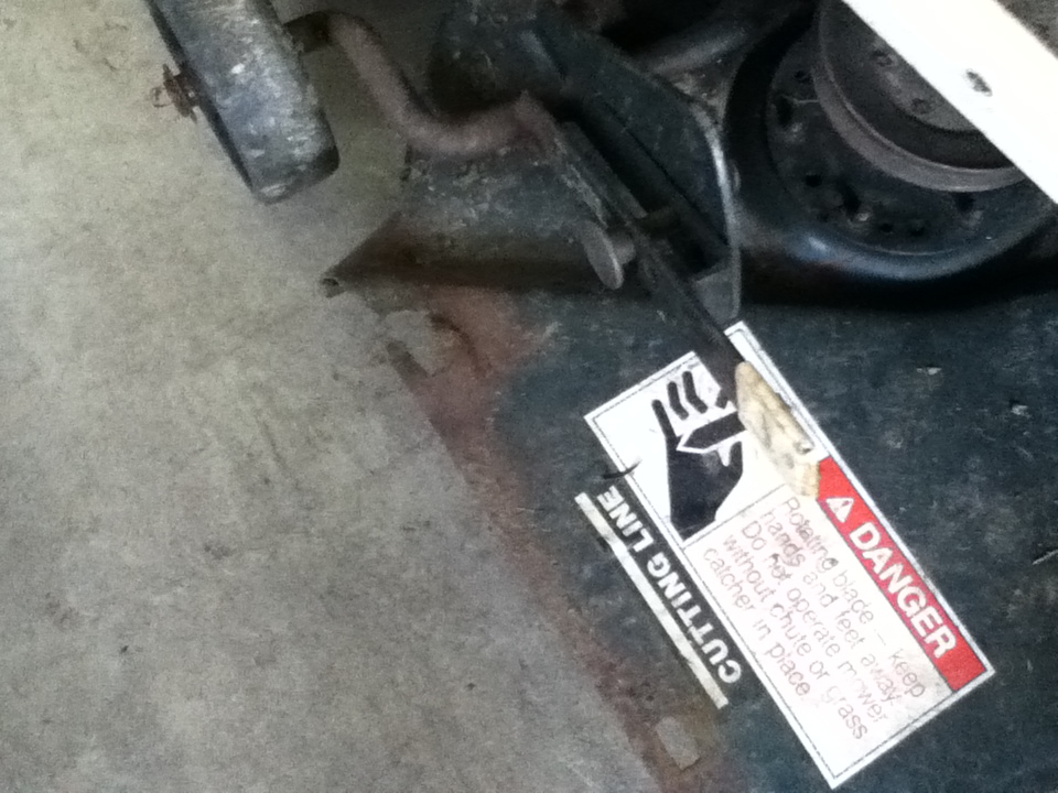

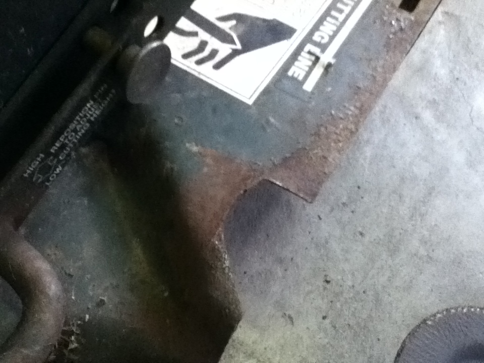

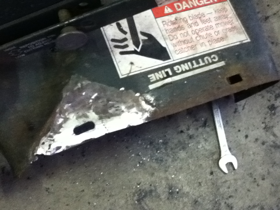

hello. im 14 and live in holland, so please dont mind my english.

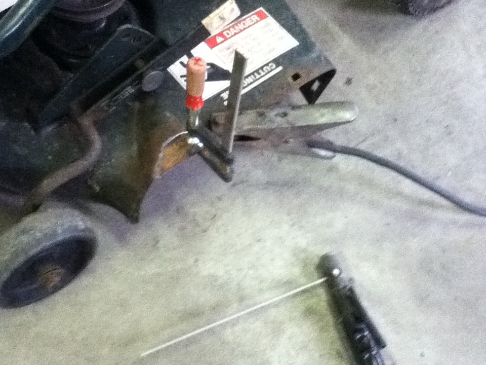

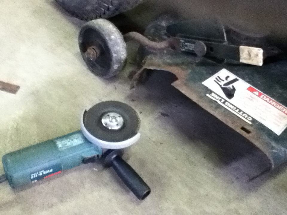

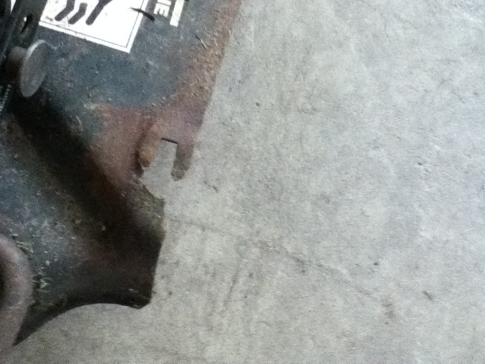

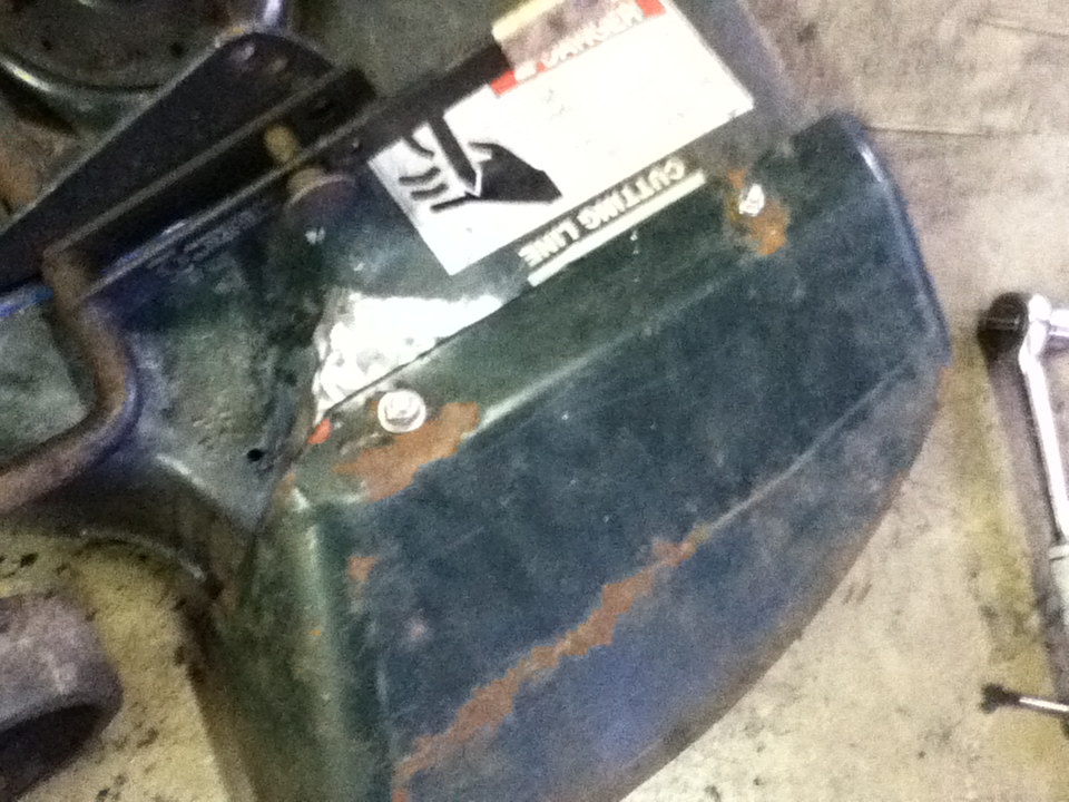

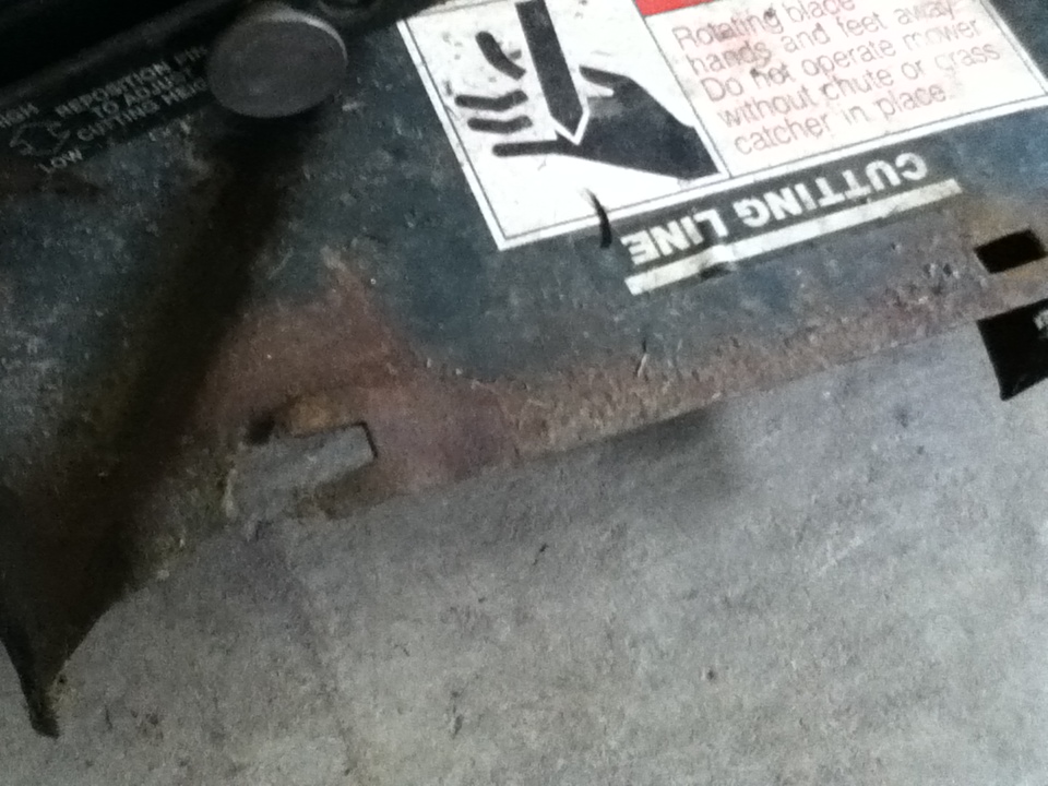

What you see on the first three pictures is the rusted and broken peace where the chute of the bolens st110 mower deck bolts on.
Because the chute wont bolt on correctly this way and it would mowe alot and stuff i decited to cut out the rusted part and weld a new one in.

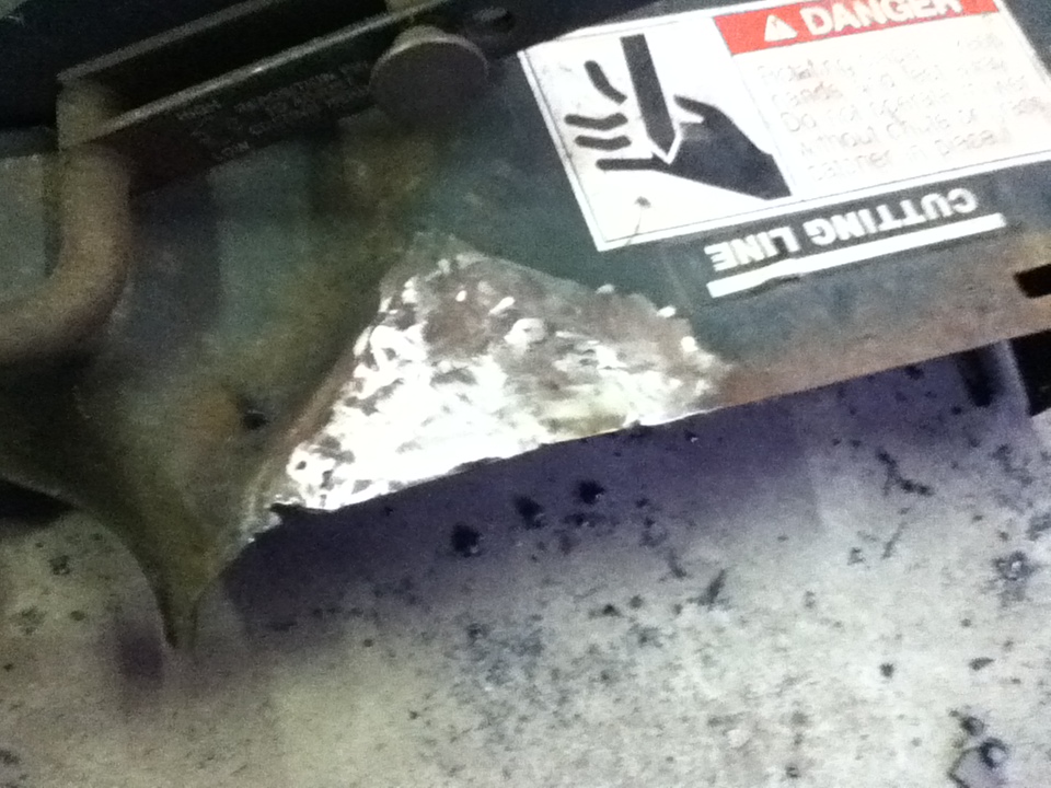

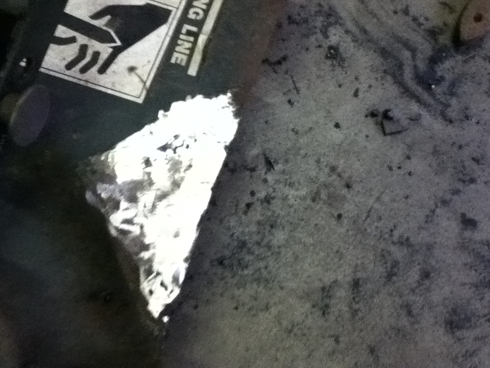

After i cut it out. I cut out a peace of metal and clampt it in place.
I made some tacwelds and removed the clamp. After i welded it al around, i flipped the deck over and did the same on that that side. Then i took the grinder and grinded it nice and clean.

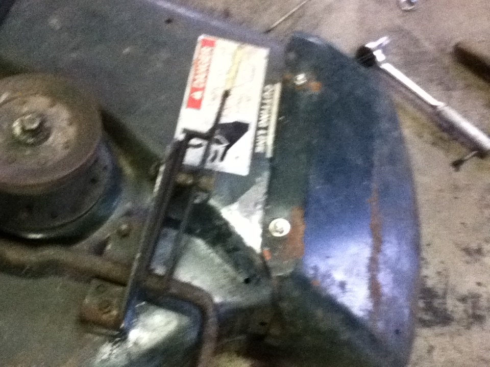

Then i drilled three holes right next to each other and grinded en filet them out.
finally i bolted everthing togother nice and tight.

   / Mowerdeck rust repair. #10
Good job!

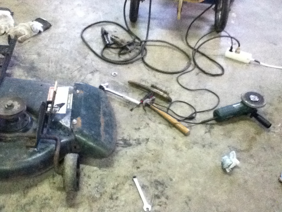

I know how difficult it is to weld thin sheet metal with a stick welder, for shure repairing rust spots. Try to get yourself a MIG welder, it makes welding real fun.
What education do you do?
Veel succes.

It sure isnt easy to weld thin metal with a stick welder. I welded thru it like three times.
I realy want to have an mig welder but i dont want to mutch money on it because there pretty expencive. Also the welder i use right now isnt mine, it belongs to my uncle, but he doesn't use it that mutch.
I dont now how to you call it in english, so i cant tell you what education i do, but i want to do something with my fabrication skills and my love for big machinery, tractors and lawn en garden tractors.
