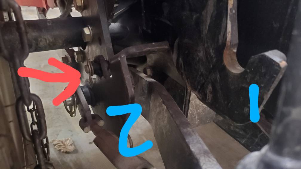

On my Max 26xl the 3 point lift arms are both removed and the lower link arms are connected to a special brace that is attached to the draw bar when the backhoe is attached. This keeps the lower link arms stabilized below the backhoe and inoperable.
Your mower deck linkage is connected to the pivot / locking plates on each side of the tractor. These plates are either pinned in an upward position when the backhoe is mounted which in turn will keep your mower deck raised, or unpinned which allows them to pivot and be raised or lowered by contacting the 3 point arms when the backhoe is off and the lift arms are attached.
So to answer your question, the mower deck and backhoe can be on at the same time but you will not have lifting or lowering control of the deck and it should be pinned up.

TMCJ-can I get a clarification on your post? My 26MAX has the backhoe plates installed. Does that mean my 3pt hitch is disabled until I take them off?
/ mower won't drop with 3pt control #7
The backhoe mounting frame stays on all the time and doesn't interfere with the 3 point in any way.
In the pic #1 is the backhoe mounting frame. #2 is the plate that your mower deck lifting linkage connects to. This contacts the 3 point lower link arms when they are raised or lowered which raises or lowers the deck. The red arrow points to the pin that locks this plate up when the deck is not in use and in the raised position, or not attached at all. 20210124_200153~3.jpeg

thanks tmjc, appreciate the photo's i saw those pins didn't realize thats how it gets locked up. on a disappointing note, both stabilizer jacks are leaking

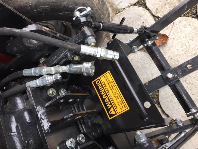

Well....so much for the dealer input. I have three hydraulic leads coming from the hydraulic system to hook up my backhoe. 2 males and one female. Neither one of the males will mate with the female. I'm not so sure the guys who plumbed this thing didn't mess something up.
you need to complete the loop, if all 3 lines are off, i was told the loader doesn't work either, that said, shut the machine down, and move the joystick controller in all directions, this should make it easier to connect up the hoses. one of them should have a rubber boot, that one should not be connected.

I finally reached the right person at a not so local Mahindra Dealership. The whole problem was my fault. I didn't take enough pressure off the female hose end to allow the male to seat properly. Once I let a little oil out the male slipped right in to complete the loop and now I have a 3 pt hitch. I needed this to hold my home made counter weight that I made with a beer keg loaded with scrap steel and concrete. It's beautiful and won't rust out. BTW, the loader was working all the time.
