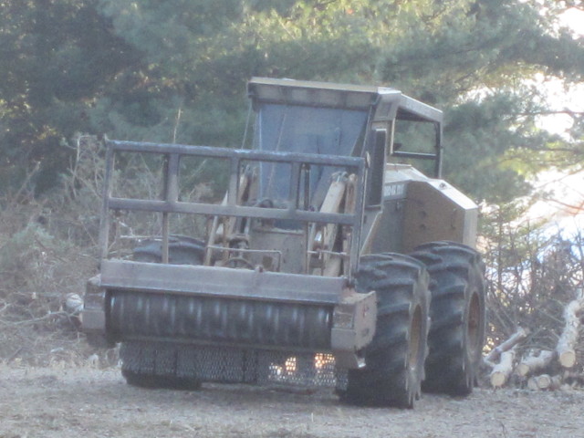

So I'm thinking it is a bigger problem than just a bumpy field. It sounds like you needed to have something like a hydroax to clean and level the site before you planted grass.??

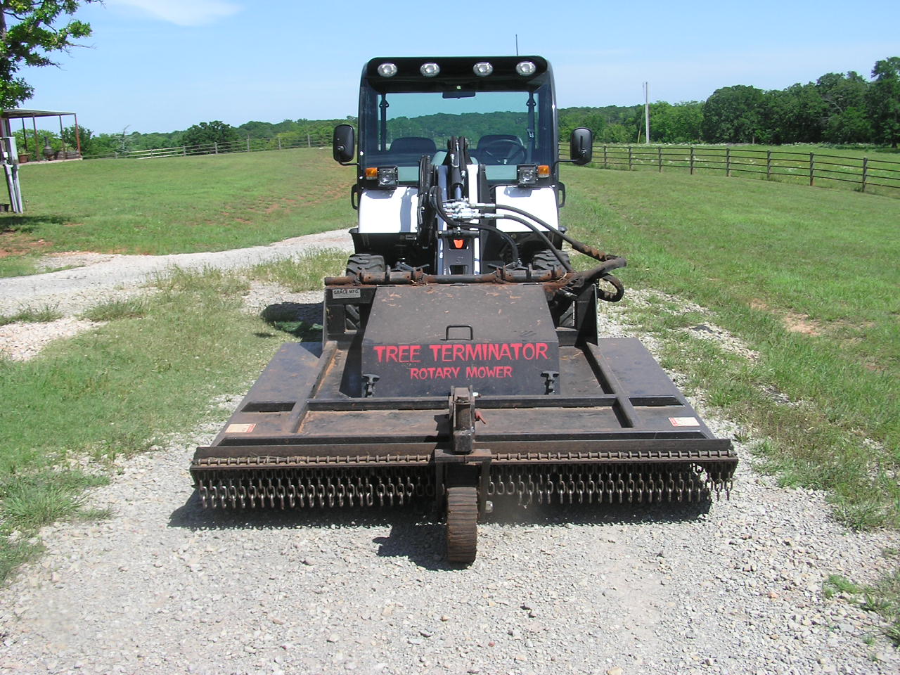

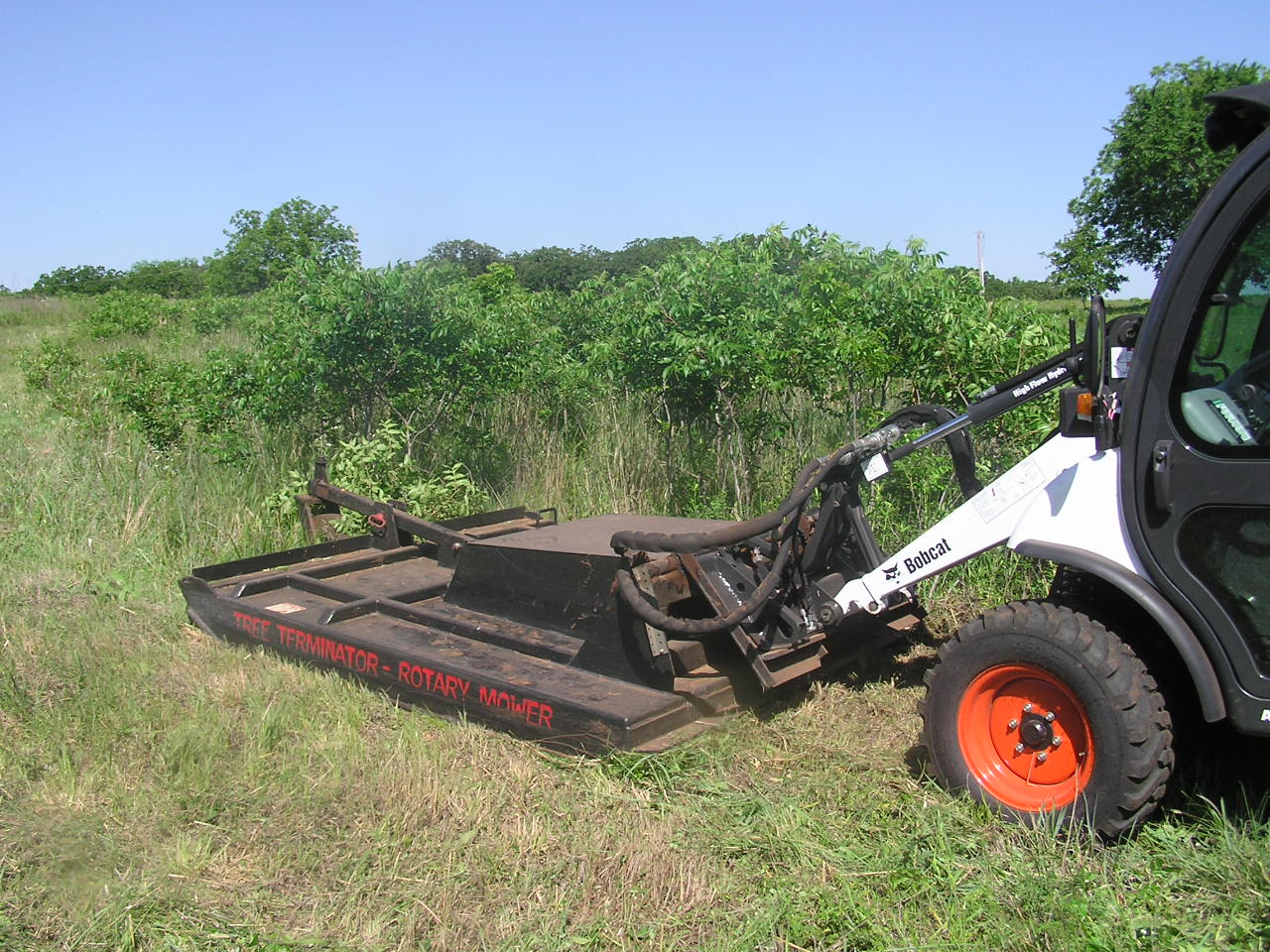

Bumps is one of the biggest reasons I switched to a Toolcat. It handles skid steer implements up front, has a pto and 3pt out back (5610), has 4 wheel suspension and all wheel steer. I too planted forage and prairie grasses where I had 1800 trees removed.
Good luck mowing 50 acres with that!
I would do it with ours with the A/C on and the 7' brush hog:

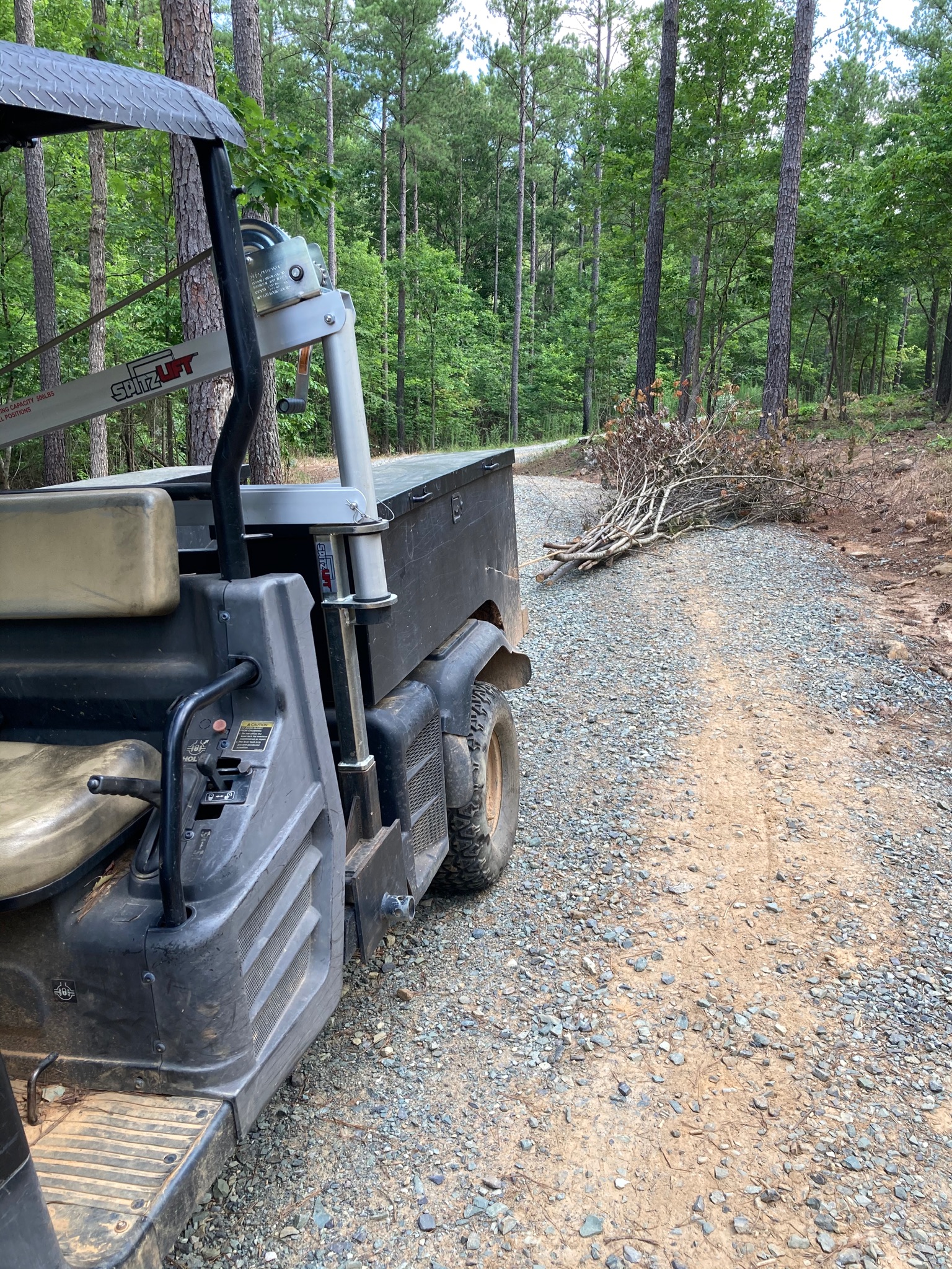

Before I drag my pile of cut weedy trees to the burn pile, I always take them for a ride up and down trails, it really works well.8718D496-BA9A-44EC-9098-CF4BF11F66E5.jpeg
