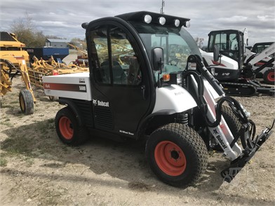

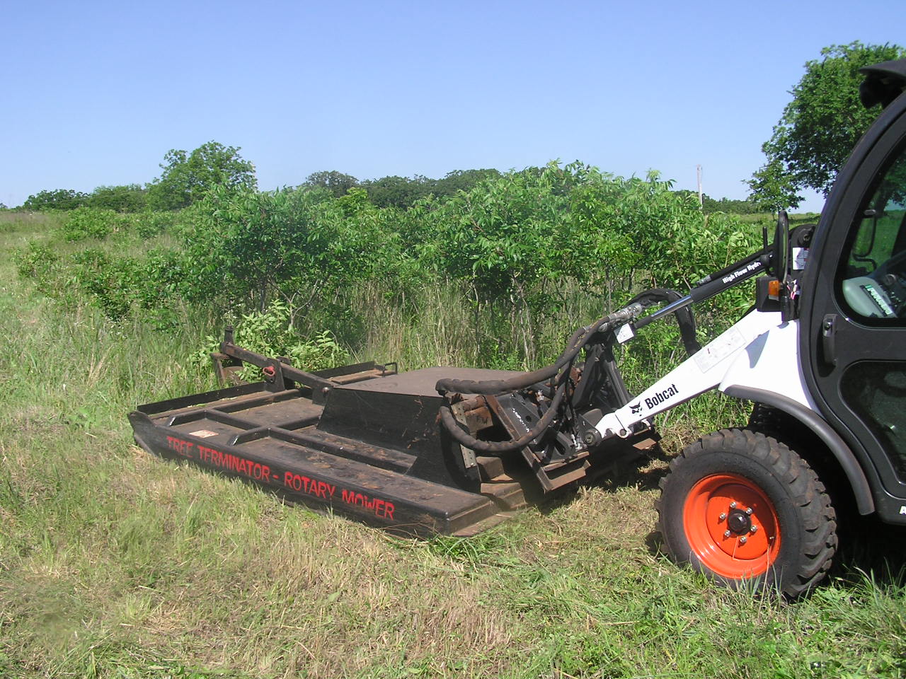

Bumps is one of the biggest reasons I switched to a Toolcat. It handles skid steer implements up front, has a pto and 3pt out back (5610), has 4 wheel suspension and all wheel steer. I too planted forage and prairie grasses where I had 1800 trees removed.
Good luck mowing 50 acres with that!
I would do it with ours with the A/C on and the 7' brush hog:

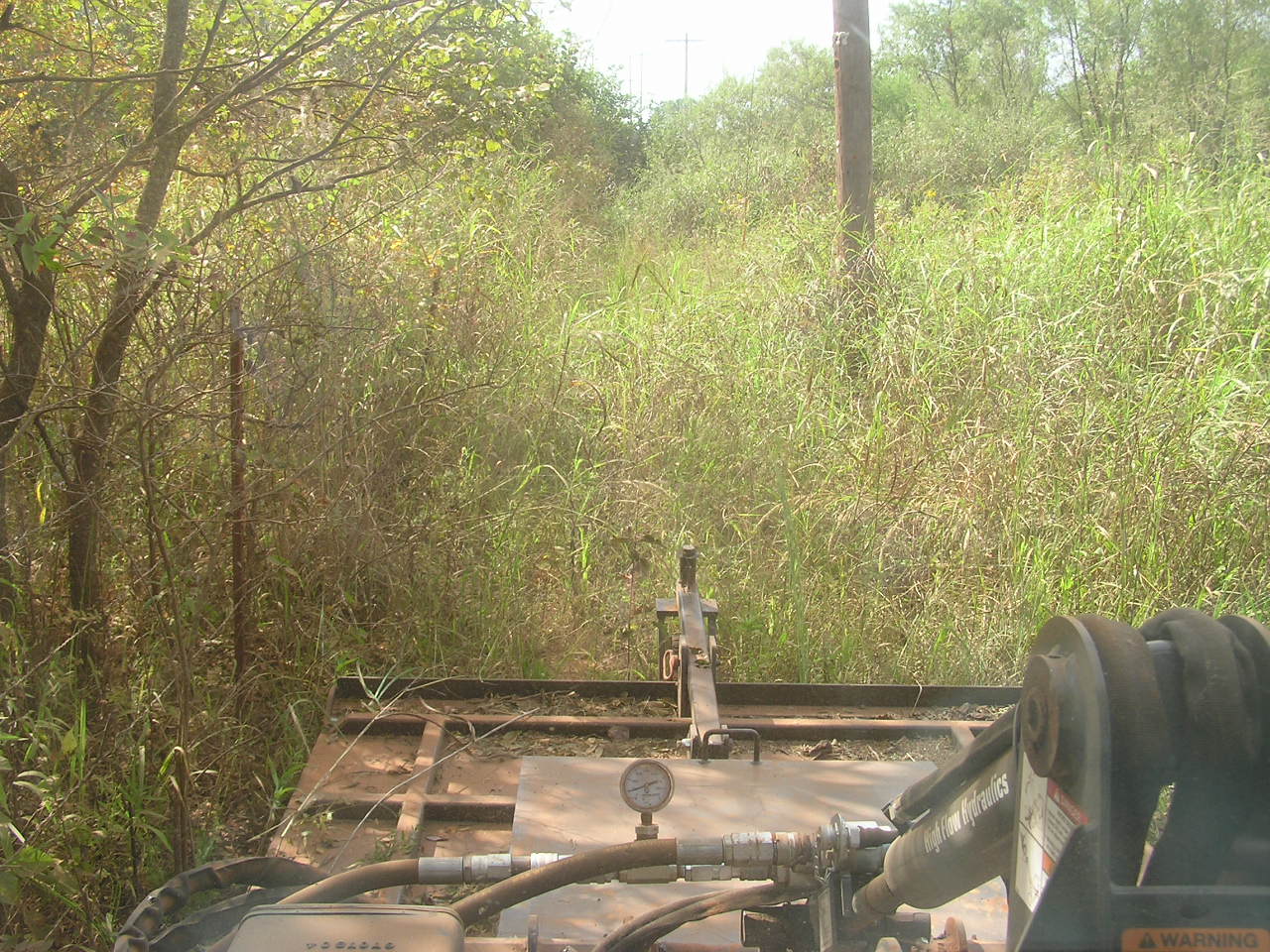

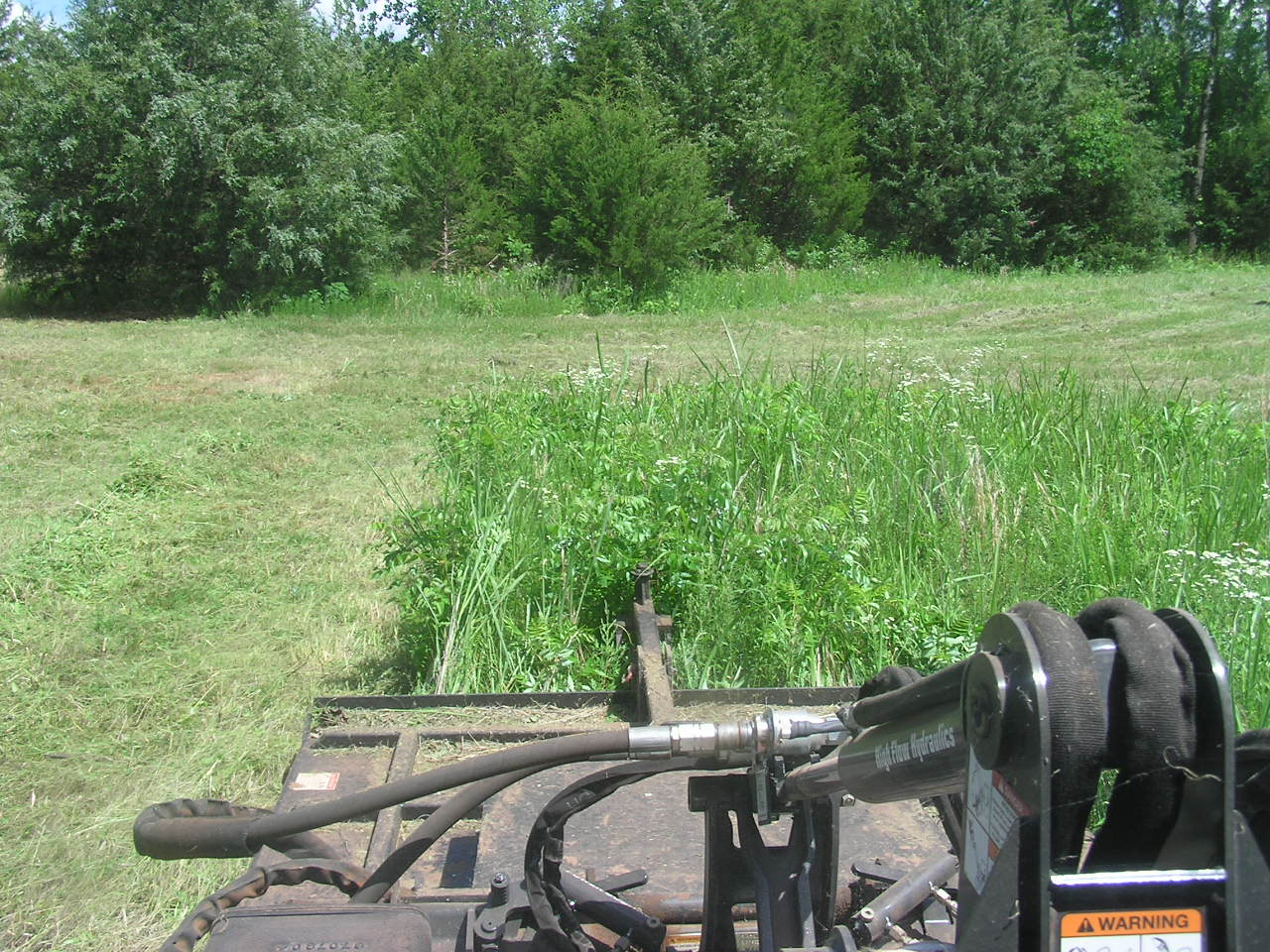

I just mowed my rough areas yesterday with the 3pt rotary cutter. I had the A/C and radio on and the wife was riding along. She helped me spot the tree tubes where I planted some oaks among the 4' grass. I'm really thinking about getting one of those Brushcat$ to go up front.
