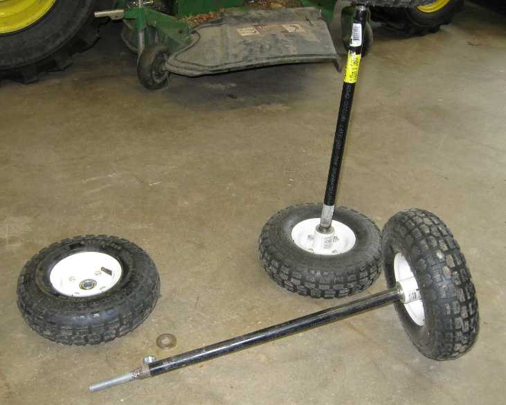

Just in case anyone has been thinking about a vertical mower deck stand, I just noticed Harbor Freight has a coupon for 10" pneumatic wheels/tires for $3.99 each. These are the perfect size for the JD 62D deck and they may work for others. Just to review the plan - 1/2 inch pipe works for the stand axles. It has a 0.622" inner diameter so it doesn't take much work to get a 5/8" rod inside the pipe. The wheels are made for 5/8" axles. I made mine with pipe sections about 18 inches long, but that's a little big. 12" might be long enough.
A good winter afternoon project - takes less than an hour once you have the parts.

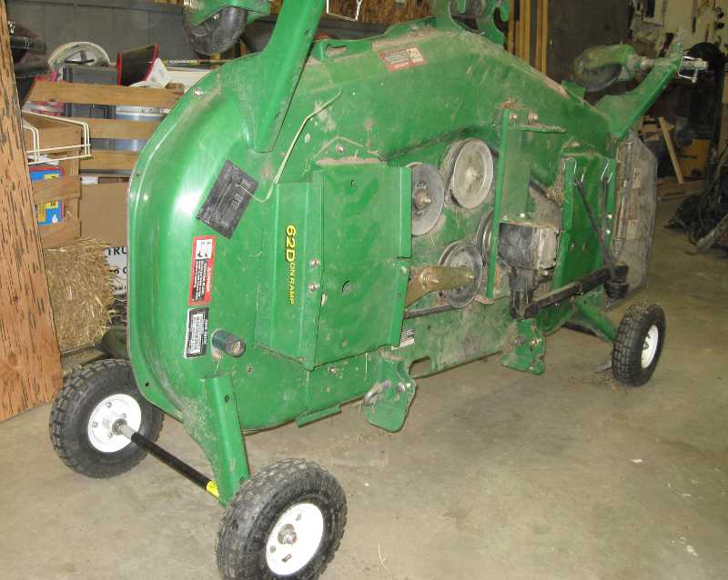

Here are a couple of pictures. Vertical storage saves space and makes cleaning and service much easier.

Belated thanks for posting this. I got the $4 wheels from HF and 5/8" threaded rod and 3/4" tube from McMaster for the axles. All worked great. Sturdy for cleaning and a real space saver. The pneumatic wheels work well on the gravel lane to my garage.
