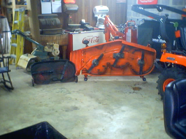

They are well made, and very functional BUT, they orient the output shaft and its seal pointing downwards along with the vent nut at the lowest point on the gearbox. Yes, there's a vent nut. It's a small hex head thingy with a tiny hole in one of the flats. Over the winter, my deck lost most of its gear oil out that vent nut, all over the raised wood floor of my barn and making a huge mess. When I questioned Larry, and got a prompt reply of, "Yes, I've heard of that happening with others....." So we have a product that MAY result in nearly all of the oil in the box to leak out all over your spotless concrete or wood floor. Is that good? If there was a warning or something to alert us to that fact, at least I'd know what to expect. Because I like the rollers, the fix or workaround I came up with is to A) drain the gearbox oil out at the end of the season. (not a bad idea to change it yearly except you have to remember to put it in before the first mow! B) Remove the mounting bolts that hold the gearbox in place and turn it 180, so the output shaft and the vent nut are pointing up. Both are a pain when it has turned chilly, and the only thing you want to do is get the plow on the tractor, and go in and watch the game. Personally, I'm opting for B. Great idea, poor execution IMO.

Why can't you just remove the vent nut and replace it wjth a non vented one for the winter??? Just hang the vented one on the drive shaft w/wire so you'll remember to replace it when it's time to mount the deck.

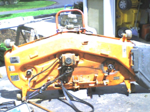

Well I made my own - 2 3/4x12" hex bolts, 4 4" wheels from mcmaster, 4 3/4 washers, 2 roll pins and 4 clips. Cost about $30 total and they work very well.
First year, I had some leaking but just a little and I check and refill in the Spring anyway. Mine didn't empty the gearbox (I'm using 80w90), but it does weep a cup or so over the winter. I store my deck in unheated space so the 90W gets pretty thick so that might prevent the leaking a bit.
/ Mower Deck Stands #47
PeterK, can you post pictures of your set up? I would really like to see how you did it. Thanks in advance.
Bruce
/ Mower Deck Stands #48
Bruce
Materials list:
2- 3/4 x 12" hex bolts
4- 3/4" washers
2- 3/16 x 1 roll pins Lowe's
4 - hitch pins TSC
4- 4" plastic wheels for 3/4 axle McMaster
2- Cat 01 adapter sleeve from 3/4" id to 1" od TSC
The wheel on the left (in photo) is fixed with a washer and roll pin. The sleeve fits inside the mower anti-scalp mount and is secured through deck, sleeve and bolt using the Kubo pins. The right wheel is secured between two hitch pins. I used a wider wheel than others I've seen to make it more stable.

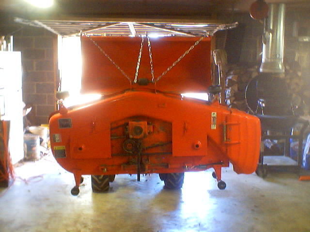

I keep my deck on a hand truck. With two patio blocks at the base, it gives me just enough height to swing the deck up and rest on the blocks with the gage wheels off the ground. I haven't seen any oil, so the true pessimist that I am tells me that I am very low on oil.
I had this extra hand truck, the patio blocks were laying around and I always have bungees around. One to hold the shaft from swinging and one up top to hold the deck to the hand truck. One bungee, that's it and the deck stays put even with me taking the pulleys and spindles apart.
Price $0.00
I had everything .
